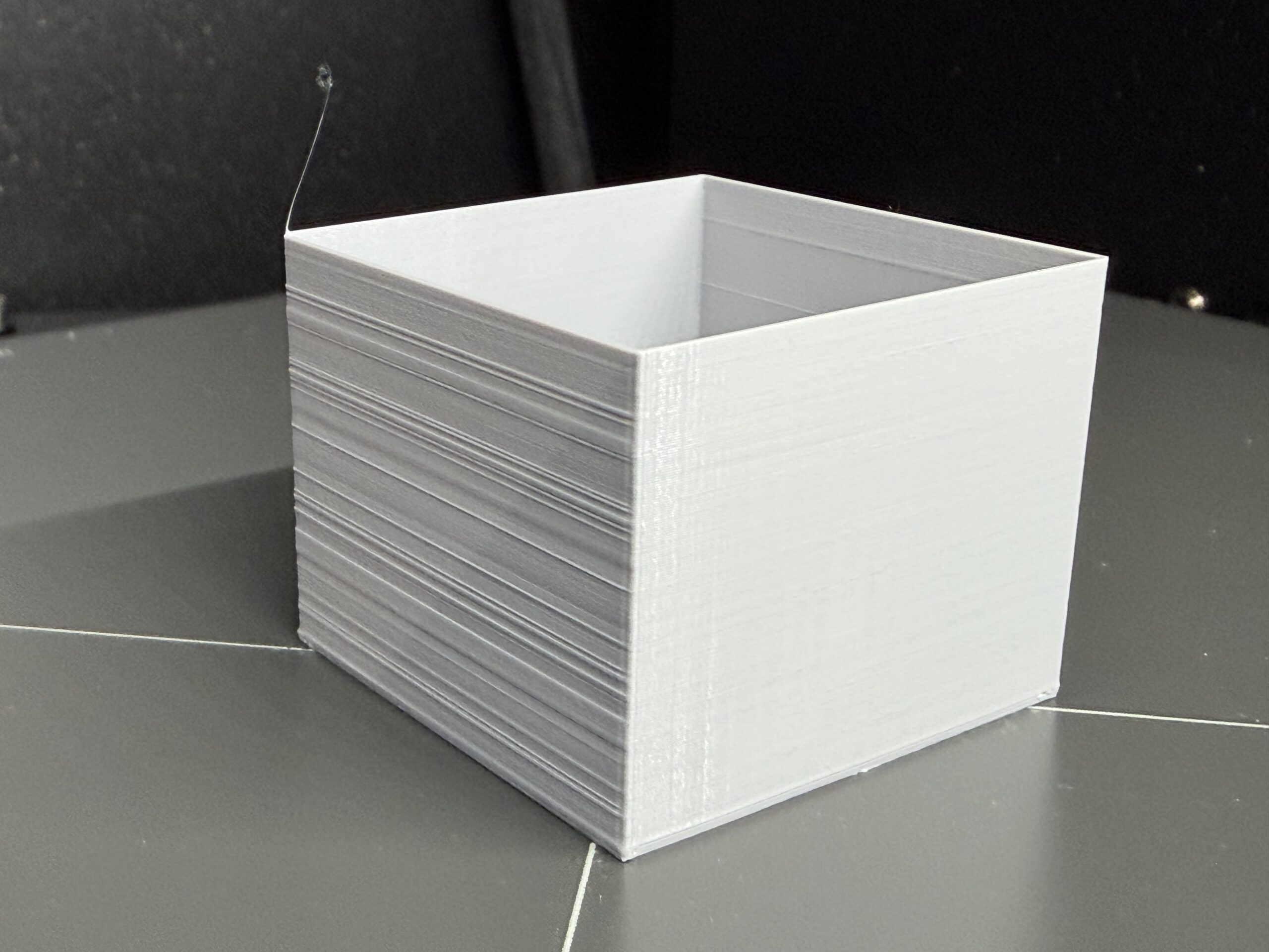

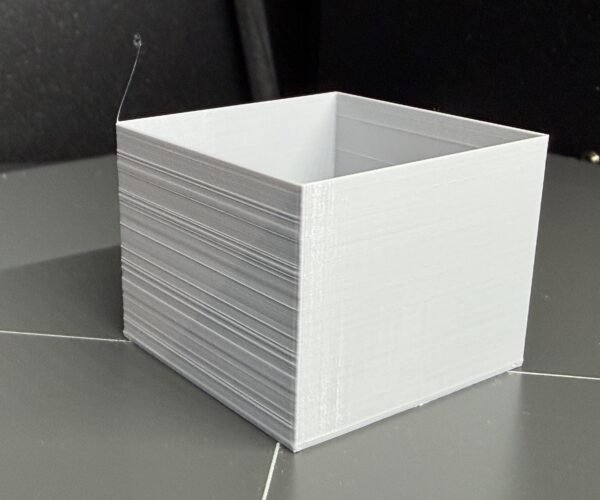

I was becoming frustrated with my Core One + kit after it passed all self-tests and printed the keychain but had issues when printing the calibration cube in vase mode. I tuned the belts fairly close with the phone app, then used the built-in manual belt tuning. It didn't seem very precise as the oscillation spread over 6 Hz or more with the manual belt tuning. After much effort and many support chats investigating pulley tightness, gantry squareness, etc. I discovered that the phone app used my hearing aids as the microphone source. Hearing aids have basically no low frequency response, so the phone app wasn't reliable at all. In fact, what the phone app detected was the 2nd harmonic, which I dutifully adjusted to 96Hz.  What I saw with the built-in manual tuner was also a 2nd harmonic. Finally, when I was setting the belt tension for the 20th time, it occurred to me that I needed to turn off the hearing aids so the phone app would listen to the microphone in the phone that I positioned near the belt.
What do you know, you really need to tighten those belt tension adjusting screws. They push back by the time you get to 96 Hz. And the manual belt tuner is super easy to see and very precise once you stop detecting 2nd harmonics.
The ridges on the left are nearly gone when reprinting the calibration cube and I'm moving on to print other more interesting objects.
Cube printed in vase mode

That's an unusual reason for getting the belts right 🙂
Glad you got it sorted. Ultimately, the app is really kind of useless.
Follow https://help.prusa3d.com/article/adjusting-belt-tension-core-one-l-core-one_845048

Your mic selection adventure is a helpful reminder of the 2nd harmonic problem I think a lot of us run into. My phone natively had no low frequency response. So, I was tightening to ~130Hz while the early version of the phone app showed too low. I kept on thinking this seems way too tight. Changed phones and then used Spectroid to get the absolute frequencies sorted out. Much better using that app in the early CoreOne days for proper adjustment before the stroboscopic manual tuner was introduced.
I noticed the link k1mu provided at least lumps the thread lubrication and belt slipped out of the holder instructions with belt tuning. The topic grouping helps. I recall that info being scattered about beforehand.
I still have my 130Hz keychain from my first print 🙂 Actually not too bad.
Good that you got it sorted out quickly (~20 attempts). Beat my record and maybe above average. I've been impressed with results but getting past the tuning hurdles on the kit build is a milestone. Happy printing.

A good starting point is when it takes about 200 grams to push either belt into the rail. It's best to avoid over tensioning because it can break things!
