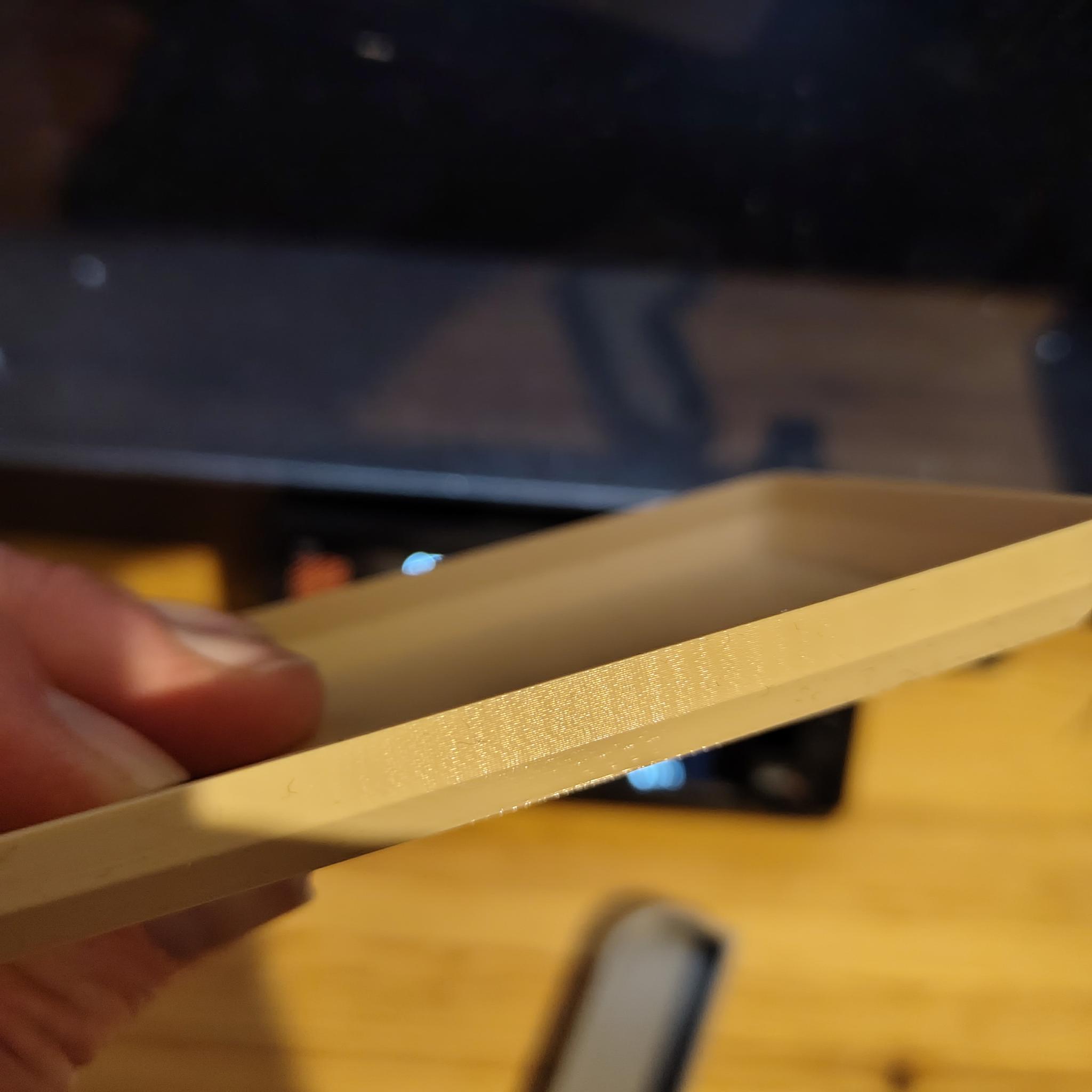

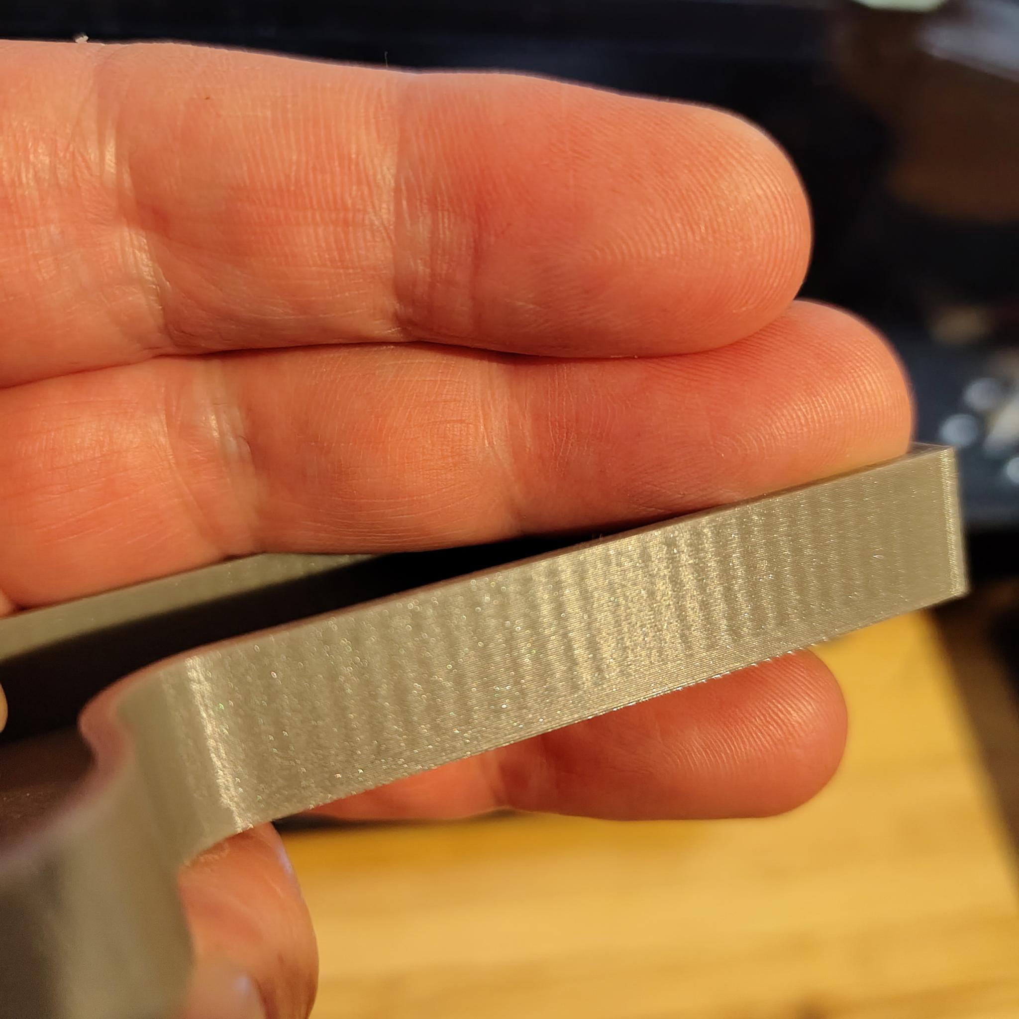

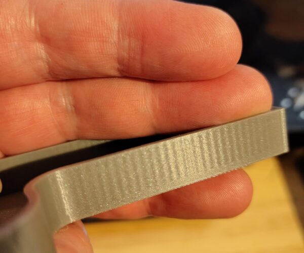

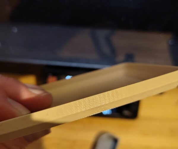

I finished building my Core One+ a few weeks ago and in general it seems to work quite well. But on my models, I get these ripples on vertical walls, which I believe are VFAs.
What I've done so far:
- Built Core One+ from the kit
- Calibrated the belts, frequencies are within the suggested ranges (measured with both the app and the stroboscope feature), there is no gap on either side of the XY
- Phase stepping and input shaping calibration with the accelerometer

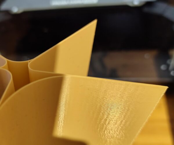

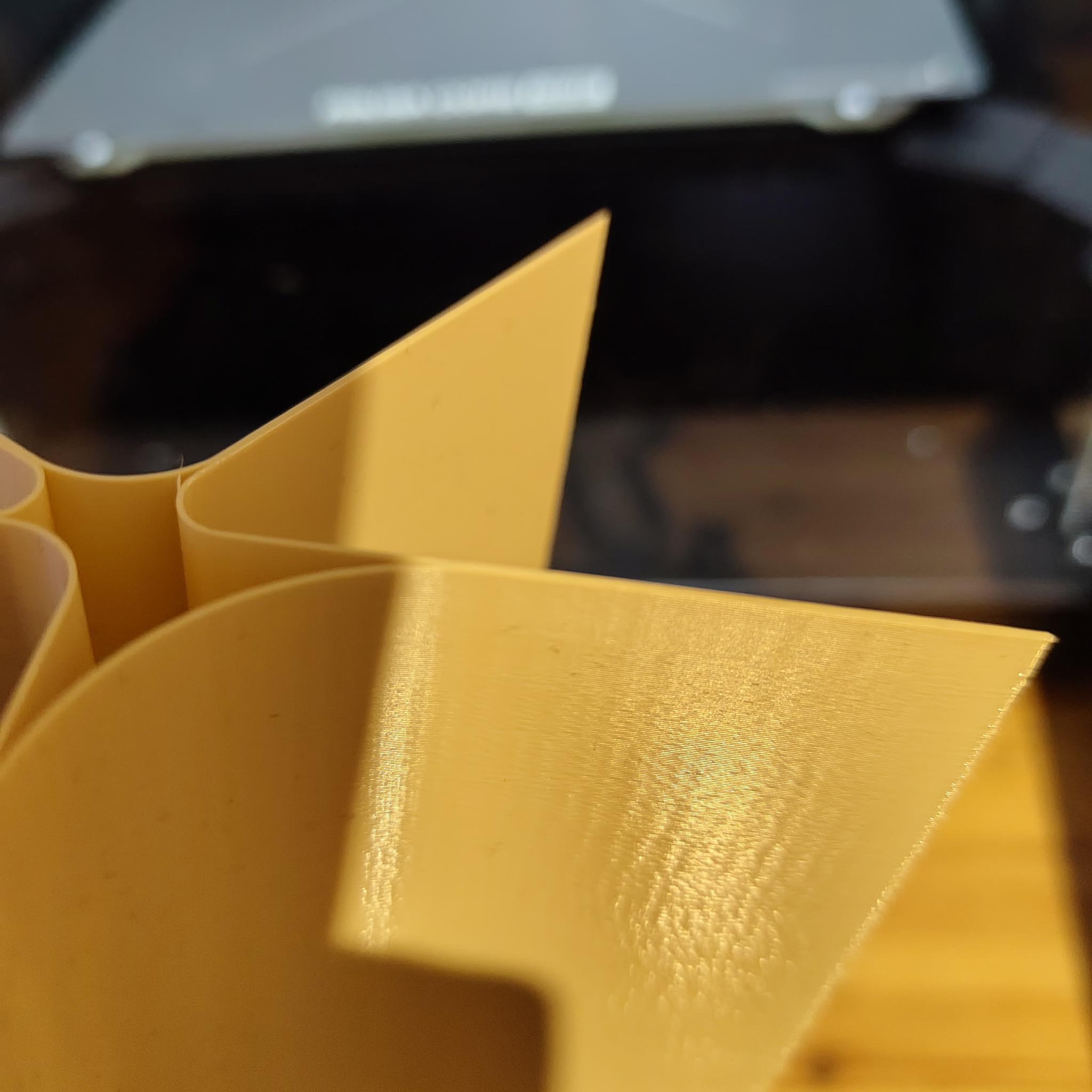

I printed this test object from Printables: https://www.printables.com/model/1189256-vfa-test-prusa-core-one and the top two sections of the print (190 and 200mm/s?) look ok (see photo below). So I think there is nothing fundamentally wrong with my printer. However, my own models have these obvious artifacts. Both shown below were printed with PLA with the 0.15mm balanced profile. As I understand it, the balanced profile uses 200mm/s for the outer walls so I would have thought the result is similar to the top sections of the test model from Printables.
I appreciate any help on this.
Mirko

As mentioned, the test model from Printables does not show these ripples at 200mm/s speed so I am mostly trying to find out why my own test models show this compared to that test. Also, I've just noticed that the bottom two millimeters of the silver part look good, that is exactly the height of the floor inside the part.
