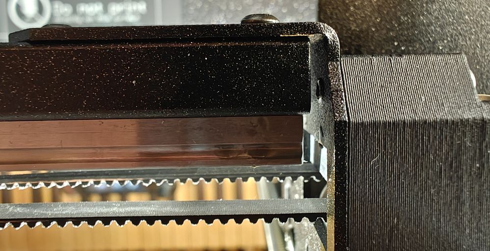

When I received our long awaited new printer exactly one week ago and I recognized that it isn't able to calibrate the Y axis, I was confident that the support would help to get this printer running in a short time.
But when the days passed and the instructions received from the support (width delays of days), were pointing into an unacceptable (covering up the problem by overtensioning one belt and having the other belt loose), and they ignored our offer for sending back the printer for repair or exchange the flawed brackets by ourselfs if they sent us precisley bent ones, we thought about cancelling this order and just buy a printer ready for use.
Support even ignored by request for creating a return shippment label (silent since 4 days...)
I discussed the situation with my colleagues and back in my mind there was the suggestion from @Rainer (thanks again!) to correct the wrong angle with underlays. And finally we decided to take this road...
From our workshop I got myself many metal strips with different thickness. With already loosened belts I unscrewed the three M3 screws on the left metal bracket that attach the bracket to the X-carriage.
With the left side loose, I was able to check the accuracy of the right bracket. The angle was only off by about 1mm (gap size). I tried some of my prepared strips and ended up with correcting the angle widh a strip with a thickness 0,07mm.
Hope you are able to detect the tiny strip right from the screw head 😀 .
With this side aligned now, I moved on to the left bracket by first tightening that screws again. The resulting gap on the right side was almost 4mm (not much better than before the correction of the right side bracket). So it looks like the right side bracket was pretty close to 90° but the left side bracket is far off...
And this thoughts proved to be true. After trying many stripes with differing thickness and different underlay positions, I ended up with the a 0.35mm strip located at the following position:
Position of the strip is as important as it's thickness because when you torque the screws and the strip is too far away, the metal bracket just bends and you end up at a wrong angle. For really correcting the angle you have to move the strip pretty close to the mounting screw.
With angles on both brackets corrected (and still loosened) belts, the previous 4mm gap was gone - it's ZERO now. After tensioning both belts to 85Hz the gap remained zero and the calibration of the Y axis succeeded for the first time for this printer!
So I was able to do some test prints. I think we may call us lucky. The misaligned X-axis seems the only flaw of this printer. No VFA, no metallic rattling, just some resonances when the Z axis is moving fast.
Of course it's not the preferred way to have to 'repair' your new printer to get it able to print. But in these early days of the Core One it seems to be the only way to get the problem solved if you got a printer with this misalignment.
If your printer is affected too, I hope you get your problem solved too. And I'm glad if this description does help you a little bit😊.
Martin
Martin

I'm glad if I could help.I was sure that it had to work like this. Unfortunately, I'm used to things like this in my day-to-day work.
I think it's just things that are due to the start-up process.I'm sure Prusa will adjust it accordingly.
In any case, I will make this fine adjustment to my printer.The result seems to be convincing.
Posted by: @martinf
Martin

What are these strips made of? Where did you get them?
