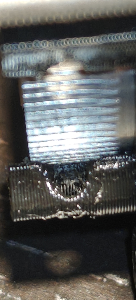

Well my new core one arrived yesterday - in good shape and everything included - so I was excited to get started.
Too my surprise there was a black galaxy PLA included - not an orange one - but who cares right .. well not exactly, as it turns out.
Did 2 test prints - the logo and the little boat - which came out great so I was def excited.
Then the nightmare started ... during my 3th print, everything 'clogged up' - which I know now after spending quality time in the live chat with some friendly support people.  This is a new experience to me - I understand this is apparently a 'common PLA issue' - but I never encountered it in my 5 years of printing with my MINI+.
It only took 2 prints on the new - quite expensive 'flagship' - to have everything clogged up apparently.  Even so severe that I now have to remove the hotend to resolve this apparently ... raising hotbed temperature with purges did not solve the issue (see picture below).
To make matters worse, it is very hard to judge what is PLA and what is not as everything is black ... sigh.
Clogge
The 'silverlining' is of course that I am up to learning how to disassmeble my new printer - only a couple of hours after it arrived assembled.
Seriously. This is not amusing at all.
Is this just 'bad luck' or am I up for regular clogging hell with this new printer ?  It didn't help btw that one of the support agents basically told me that this printer is not really suitable for PLA due to it being 'enclosed' ... euh what ?  That's not what the marketing says ...
Overall not quite happy and what a bad way to start this new adventure ...
Any experiences on handling this clogging mess could be helpfull !
Thanks,
Steven

I've never seen plastic melted next to the extruder gear.  Can you verify that the heat break fan is working?

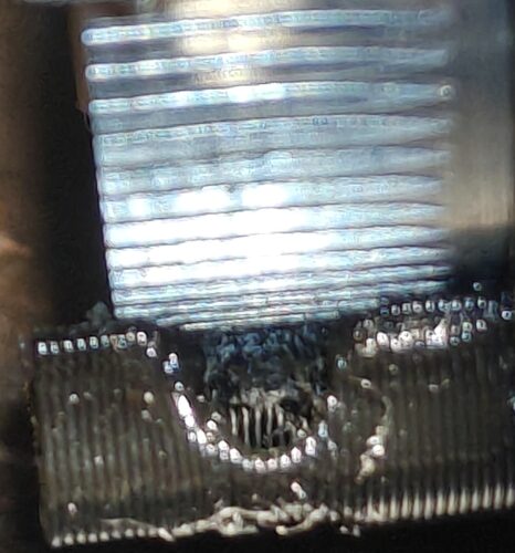

That looks very unhealthy indeed. Have you done much scraping at the plastic already, or is this how you found it after you noticed the clogging?
I would not do any further poking or disassembly, but contact Prusa support right away and wait for their reply. Looks to me like you are in for a Nextruder replacement. ☹️
I second Brian's hypothesis that the heatbreak fan (or its electrical connection) might have failed. You don't want things to get so hot at the extruder gear that filament can melt there. But again, I would not do any further probing beyond switching things on briefly to check whether the fan works. -- Ok, forget about the fan comment then. Stupid forum software; your post only showed up after I had written this one.

Thanks for your feedback.  This is how I found it.  In the meanwhile I contacted support and they suggested to disassemble the hotend  - as https://help.prusa3d.com/guide/how-to-replace-a-hotend-assembly-core-one_385707#386026 - and check its status. And also try to poke the plastic out at the nextruder bottom ...  sounds like a 'plan' ... sigh.

So I am happy to say that my issue got resolved - having spend almost the whole day in LiveChat with support engineers and me getting a crash course in disassembling the printer and clogging in general.
When I disassembled the hot bed then that revealed that there was indeed stuck filament - it stuck out for a couple of millimeters.  But that wasn't visible by just looking at the nextruder.
I was finaly able to extract a stuck filament of 5 cm by also removing the front part of the nextruder and heating up the nozzle to 290 degrees.  It took more then 5 minutes on that temperature before I started to get it moving.  It took me another 5 minutes or so to slide it out completely.
As to why this happened with a brand new printer ... 'just bad luck' seemed to be the answer.

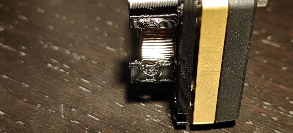

I have same problem, 2-3mm over extruder nozzle was snapped off like yours, did heat extruder up and pulled it out manually. But it happen again. Did a search on how to dissemble the extruder and driver unit, but weirdly i found no guide at all, only a guide on removing nozzle. Now I found your post and I see the latch for the filament driver on the side, but I'm missing how you got into the drive itself. I assuming the three m3 on motor is the way.
I did 1 PLA than 1 PETG and back to PLA, I have the problem now. Current looking into it.

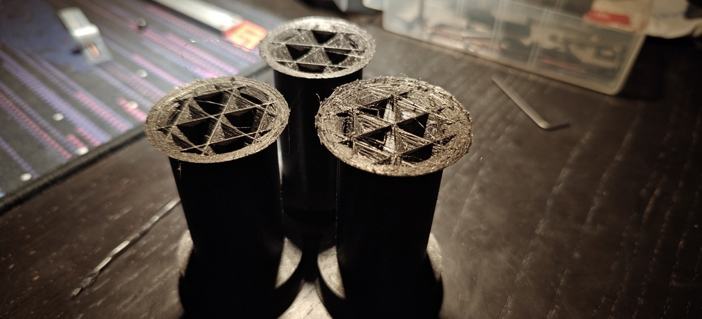

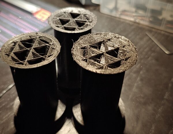

I have dissembled it a couple of times now and still having the issue.During a longer print the filament gets stuck then stripped and breaks 2-3mm above nozzle. Theory I have, is the alignment into the nozzle may be the problem, making filament prone be bent or get skewed, then stuck, making the gear skip via clicking noise, not sure if Nozzle clogged even with multiple tests via unload+load, with and without hot+cold pull.Did one short print that went fine, but all long prints fails around ~45-60min, since it started happening.
Loading and purging through nozzle seems to go fine, only issue I've had when loading is the same clicking noise when filament doesn't hit right trough into the nozzle. I understand this problem, and the cut we do get the filament all the way into the nozzle, but why during the print is the puzzling part.
So, to sum up, my current theory is the filament path into the nozzle may be the problem, I did fiddle a lot with the tension but no sure win yet.
I'll contact support when I have a good idea of the ups and downs on the Core One. Like with my other Prusa printer, I like know their, ins and outs, good and bad sides.
But Like you said, didn't expect this problems from the get go.
All near same layer / time

That Nextruder housing looks horrible.  If you have another printer I'd reprint that.  You can get the part  from printables.  It should be the same part from the MK4S.

Ok found a somewhat solution, adding more and cooler air onto/around the whole extruder unit keeps the PLA from snapping / extruder clicking noise. So the cause has something to do with softer filament due to heat build up and the strain on filament via the driver. This has not a been a problem with PETG yet.
I'm not sure if the driver in my core one adds more strain to the filament than a normal system does and I can't not spot a sure thing directly causing this with certainty.

Order this part from Prusa:
https://www.prusa3d.com/cs/produkt/main-plate-set-mmu3/
 and replace yours with it. The new one is made with better technology from a different material, because your original part that you have mounted is really very careless. Don't worry that it's a part for the MMU3, it fits the Nextruder very exactly, just don't forget to insert the rubber ring into the part, it is used to seal the gearbox so that dirt does not get between the wheels.
