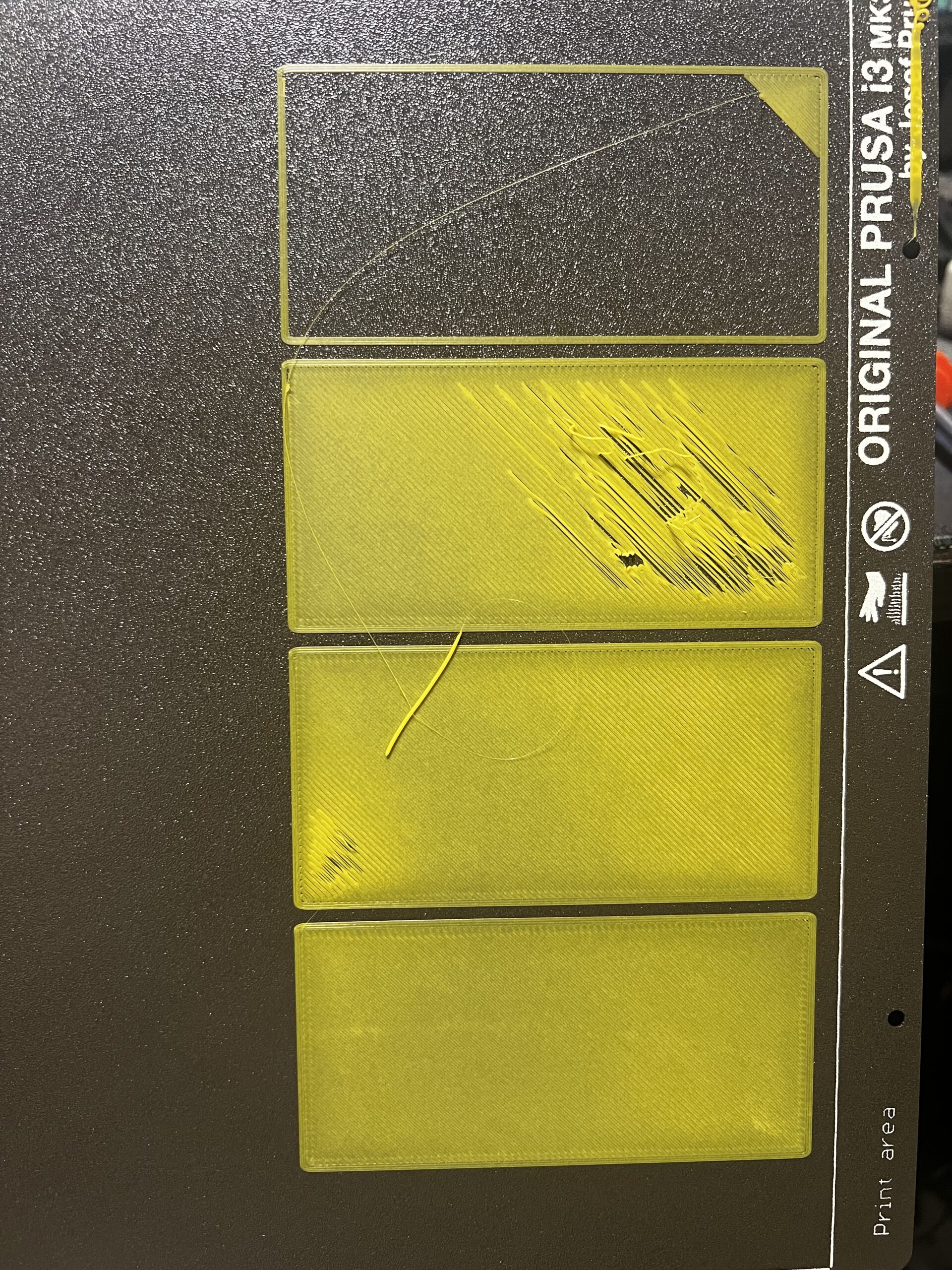

I would like to add some information to the topic.
I have problem with TXT sheet yesterday a could not get pass the 49 points (25 ok) so I tried to find what is happening.
with support got this https://help.prusa3d.com/article/uneven-bed-31111-core-one_856294
unfortunately no difference. so I grab my old Raspberry PI with octoprint and ran bed levelling visualisation and got 2.6mm difference in bed level. that is the culprit why my printer didn't passed the test.
so this is what I found.
when I do Z calibration. the left Z lead screw keeps the bed to high. prusa support told me I have to follow the link mentioned above.
but I went different way:
I just manually lowered my left Z lead screw turning it by hand anticlockwise till it shows it is flat.
the problem is, when the bed hits the bottom, I have to do it again. Prusa support wasn't able to tell me how to fix that my left side is higher.
but I still having this Z issued when it suddenly starts printing higher.
I can print the same model, same filament and same sheet on my MK4 and it's perfect. the sheet is clean 100%. you can actually see how the filament drops from higher level
no idea who is the fix here :((
