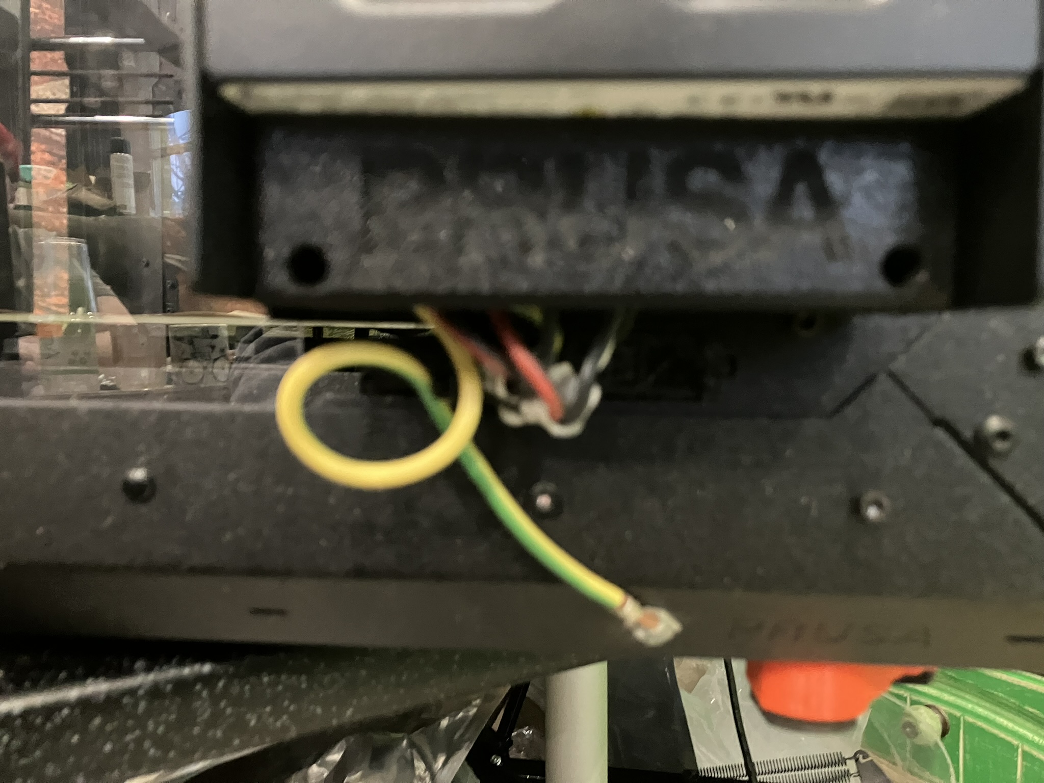

I'd forgotten how the grounding from the power supply (the yellow with green stripe wire in the Prusa cable harness) is done so I checked the enclosure assembly instructions.
Yes, it seems that the metal chassis parts are all floating with respect to earth ground. And all the individual metal parts are connected together painted surface to painted surface creating random electrical paths between different builds. Properly grounding the frame of the enclosure will be a pain because a good electrical connection will need to be made between all the individual metal pieces and then one connection to the earth-ground connector of the power supply (which I think is directly connected to the earthing pin of the power cord). One should not rely on "accidental" electrical connections through fasteners.

I was thinking of drilling a screw hole through the frame and connecting it to the earth ground on the psu with a wire. That should ground the frame back to earth shouldn’t it?  By drilling the hole i get through the paint to bare metal. Right.
I would also scrape/sand/wire brush away the paint around the hole on the side where you attach the wire (a crimp-on ring terminal would be ideal) for a positive metal-to-metal connection. I would use a toothed lock-washer between the ring terminal and the metal panel to cut through any oxide layer that forms and resist loosening over time with vibrations. Don't trust that the toothed lock washer will cut through paint, only very thin oxide layers.
Note that this will only positively ground that one piece of metal of the frame. The other pieces of metal of the enclosure frame have two layers of paint between them with only accidental scratches around the fasteners providing potentially incomplete ground paths.
