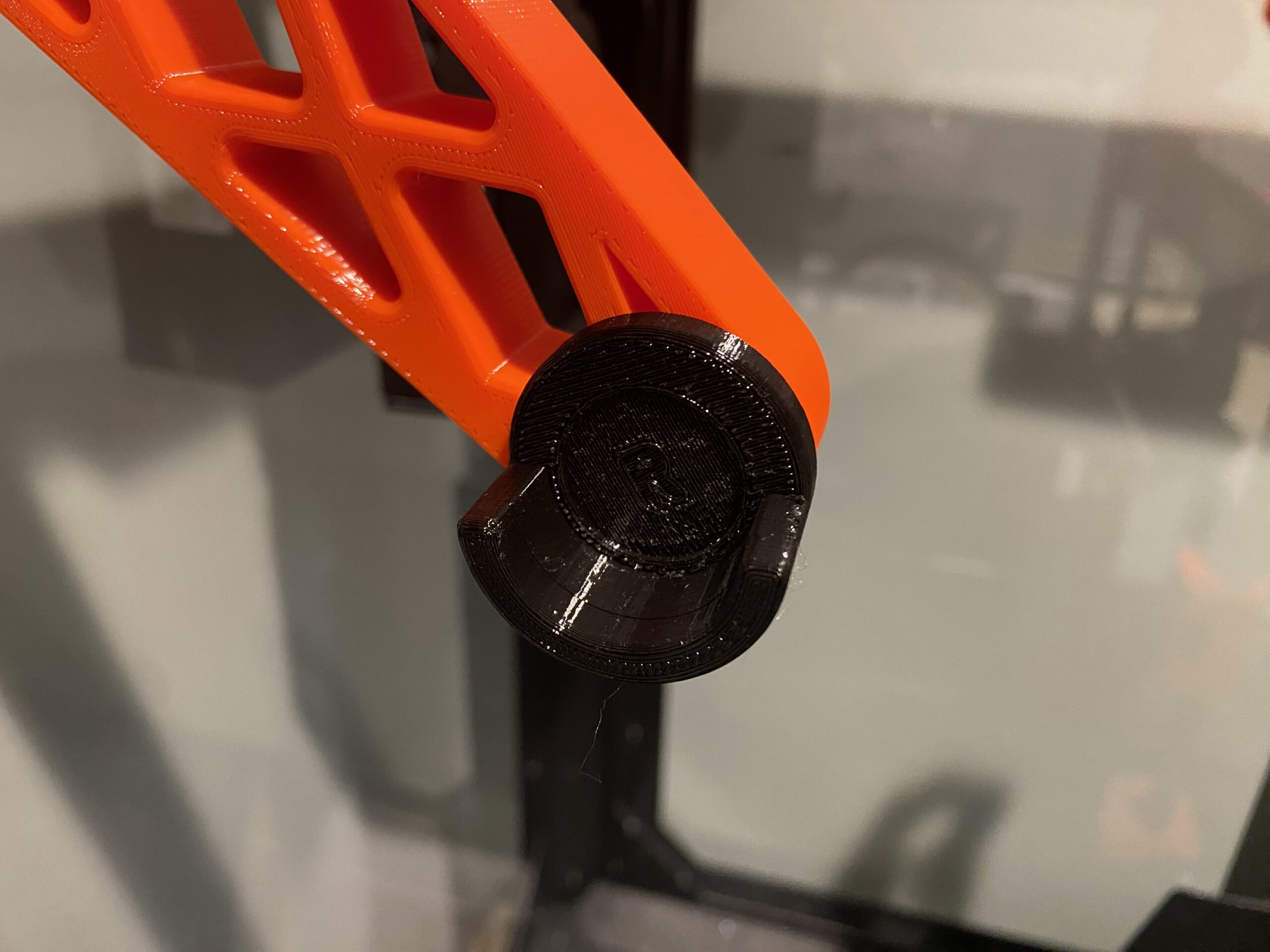

Another thing that made noise was the filament holder touching the transparent acrylic side panel. I've sticked a standard IKEA chair leg protector on the filament holder and it fixed it.
Filament holder noise reduction.
