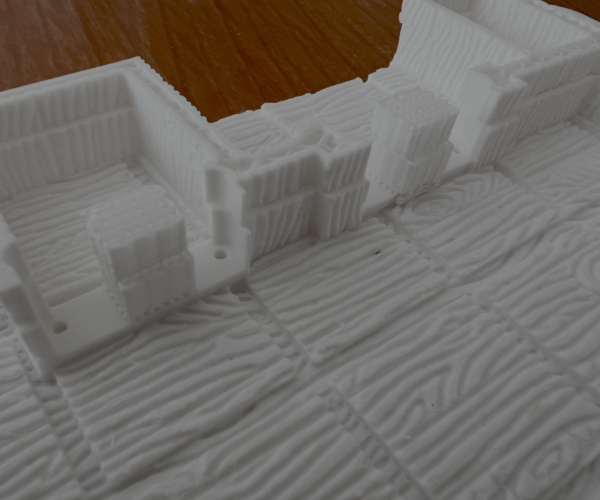

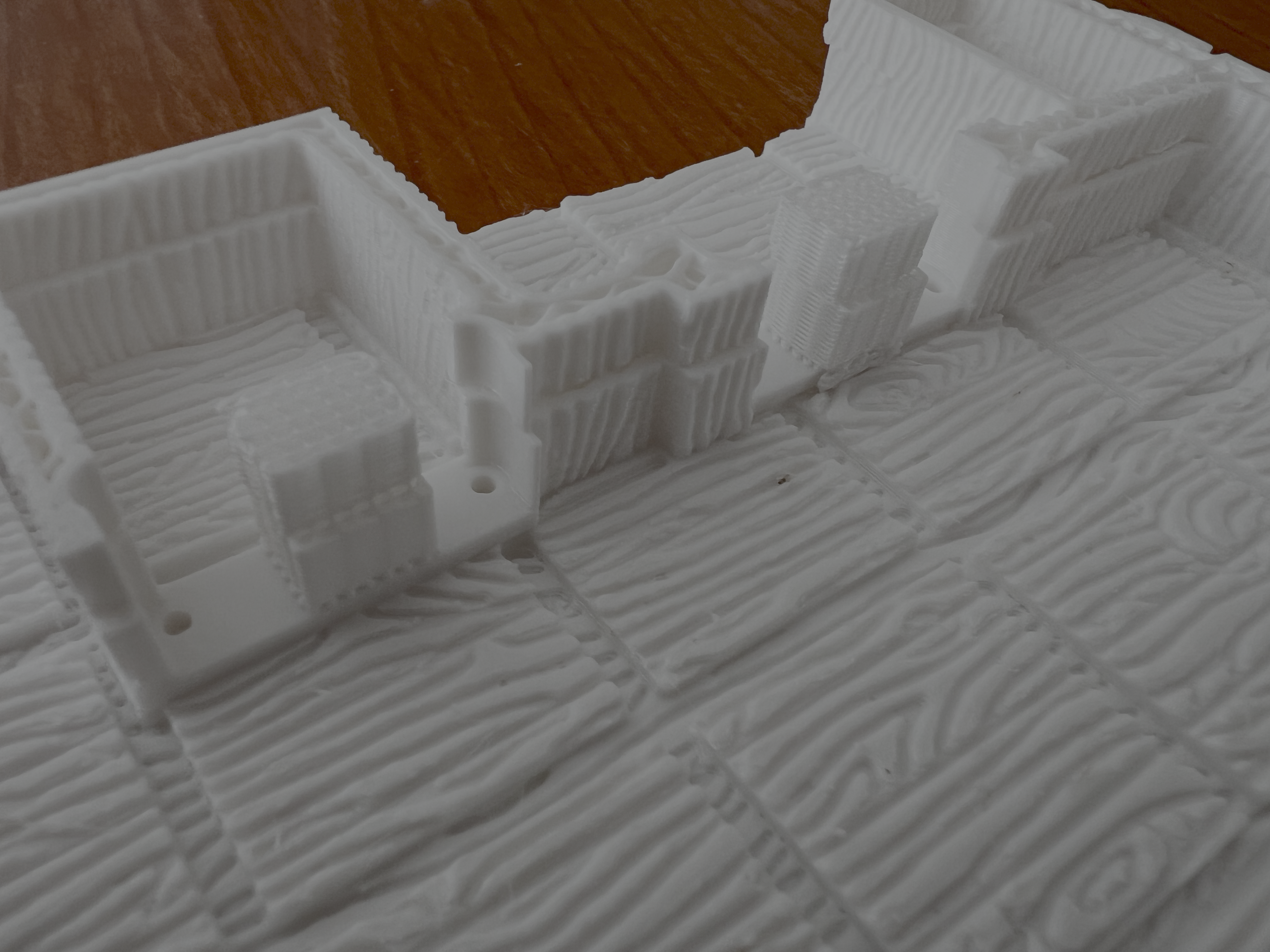

Well, there's the layer shift again. I will contact support. Let me know if you have any new ideas.

I had layer shift issues with ABS on the Core One (without the L) when printing two circular parts. Slowing down the speed was the only solution that worked for me, but it was probably already suggested.
