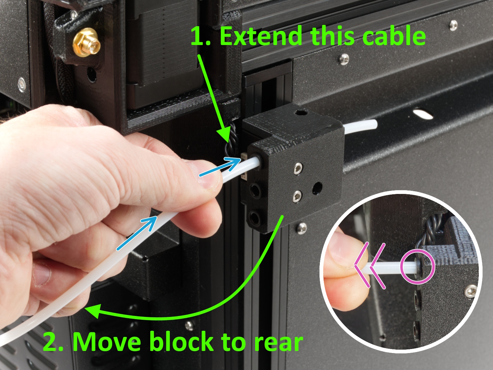

So now it remains for me to figure out how to move this sensor to a location that works best for my particular installation of the XL.
Where are you hoping to move the sensors to? I was thinking of designing a custom sensor board that spreads the sensors on the back, so we might have a common enemy...

So this mess here is the cart for my XL. I will orient the XL so that the front will face the handle, and the filament dryer/spool container will reside out back. My goal is to orient the filament sensor in such a way as to allow for the smoothest possible feed path.
The filament sensor isn't dependent on orientation based on what I can tell (and believe me, I could be very wrong). So, I'll probably set it all up and then determine the best possible location/orientation to achieve the stated goal.

the printheads already have sensors...why exactly do we need 2? so there's extra filament length and tube bends to bother with when you change spools?
for now i've stuck a piece of filament into the side sensors (since simply unplugging them causes unstable phantom readings leading to surprise filament changes) and run the filament tube from my box directly through the clips on the cable guide into the extruder.

Location would be a different one but somewhat same enemy 😉
I have a duel head and would like to run my sensor on the top left side. Then run the filament from the side through the top of my enclosure. I haven't measured the run yet but it has to be shorter than the long run there is now. I have already switched over to 3mmID 4mmOD PTFE tubing due to some filament binding issues.

These little collets are available in the Prusa store (at what seems to be a rather high price for 1 unit). But the photo there is excellent and shows a familiar but unexpected logo - JG, or John Guest - a brand most perhaps most well known for plumbing fittings in the UK. But they also do pneumatics and so on. I can't find their listing for this specific collet, so I will get in touch with them and see if I can get a part number and supplier.
Now for the cool part and what I didn't realize or expect. The little fittings here are push-to-connect connectors and are the smallest I've seen. I purchased two styles that I thought were rather compact, and they've got nothing on this. The red arrow points to the little metal 'blades' that help retain the pushed in tubing. This ultimately simplifies everything for me, and I've wasted money trying to re-engineer something Prusa has already solved.
The collets are also available from AliExpress - search for "heatsink collet". But note these look like they might have slightly shorter arms, may not be a drop-in replacement for the ones Prusa uses.

Be warned: these pre-assembled molex cables do not have the same pinout as the Prusa ones. The connectors on the Prusa cable are wired pin 1 to pin 1, 2 to 2 etc. The molex ones are pin 1 to pin 5, pin 2 to pin 4 etc. It is possible to remove and reinsert the pins to get the order right on a Molex cable, but it's quite fiddly and you need some skill/luck to avoid damaging the pins. However, this may be a lesser evil then trying to crimp up pins yourself unless you have the correct tool and skills.

Can't you just cut the wires on the original cable and solder in extensions? Seems like a pretty easy thing to do.
RE: XL Filament Sensor Mod for TPU
I wanted to keep the original cable intact so I can return the machine to stock configuration if required by support or for warranty reasons.

Oh good catch! Contacted Molex and looks like they don't do 1:1 preassembled cables for that family D:

Btw, I did get the premade Molex cable from DigiKey and I reordered the pins. The wires are separate single cores, not twisted. I used a cordless driver to twist the cable for less tangled routing, Prusa style. The 600mm length reduces quite a lot when twisted and is then only a few cm longer than needed to reach the opposite side of the printer. The 450mm would likely be too short once twisted.
Note that if you use the Molex cable with the original pinout, the printer will fail to boot, reporting that power panic was detected during initialization. However, all fine once cable sorted.
