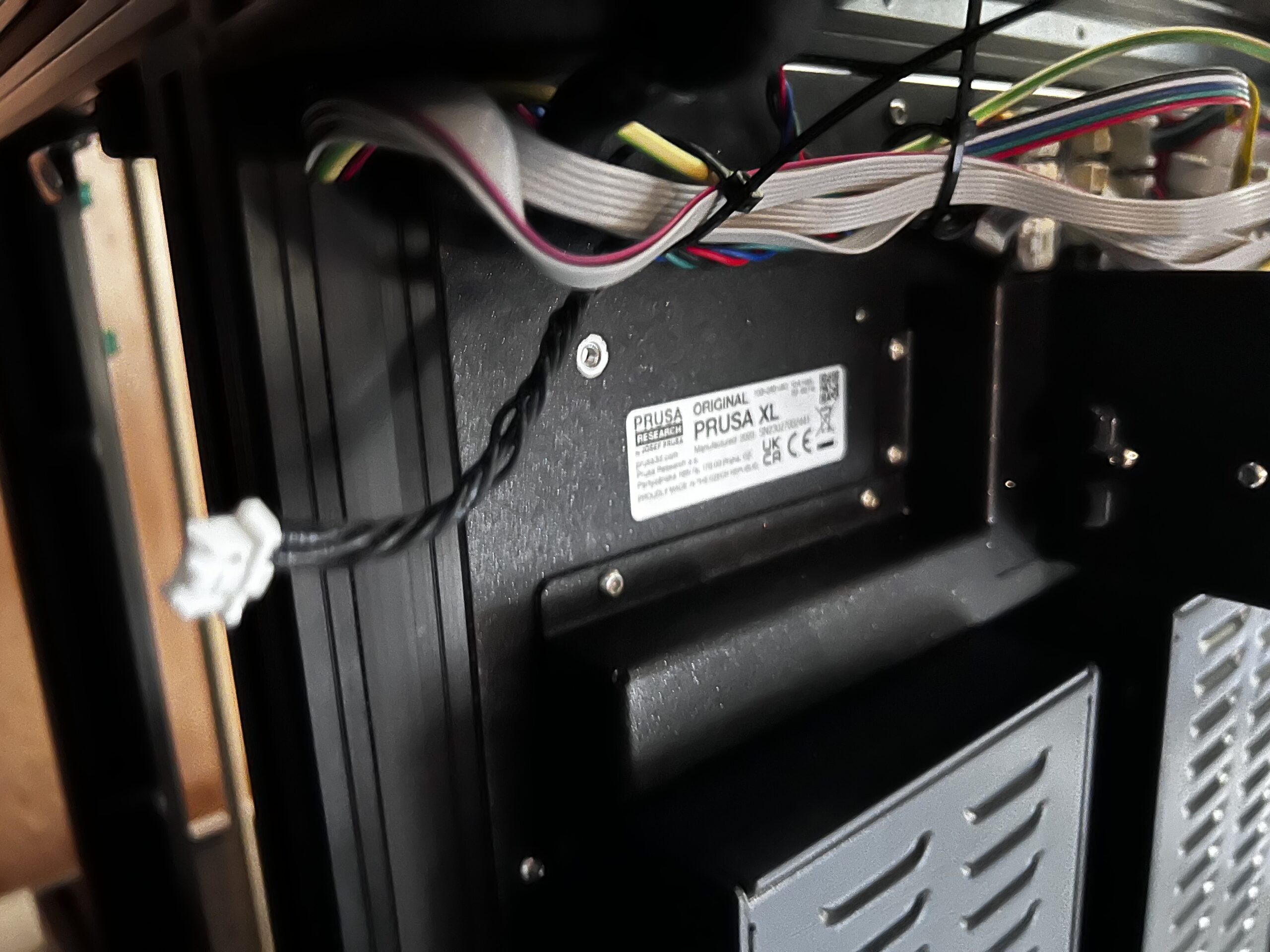

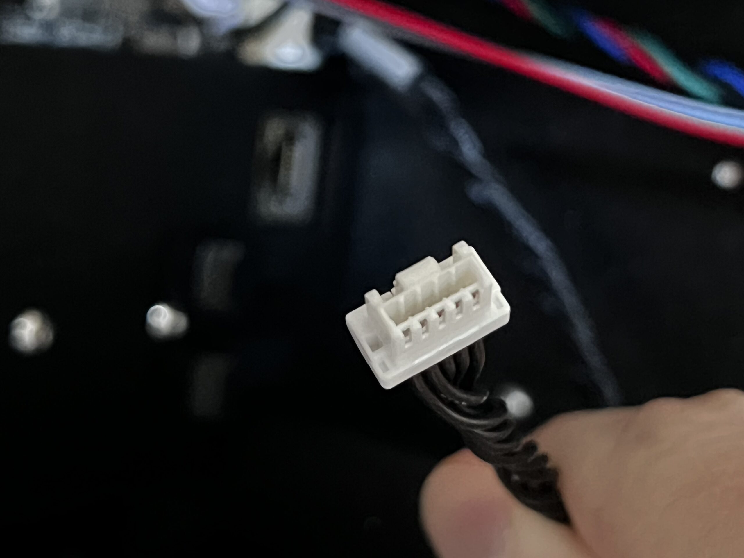

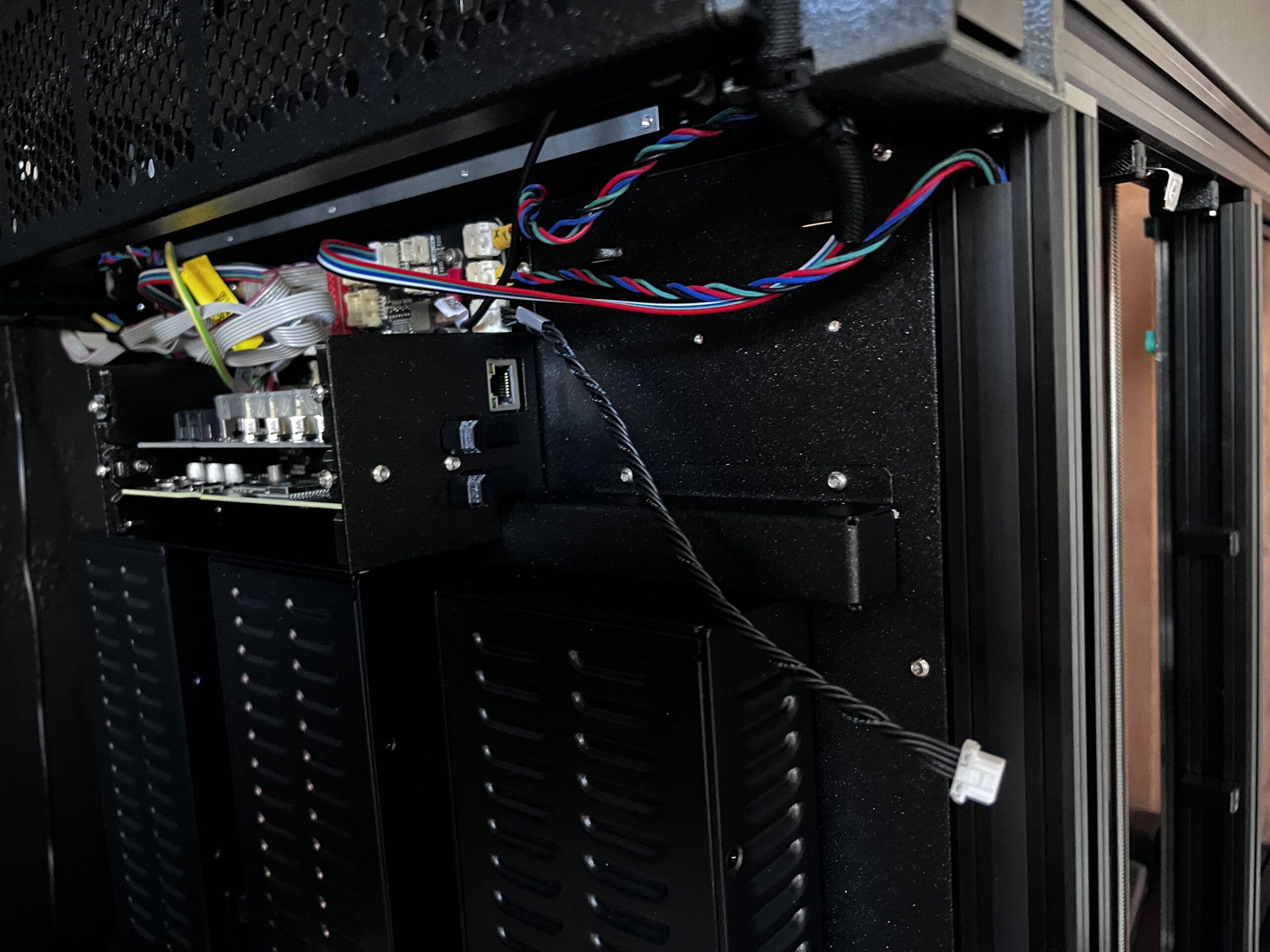

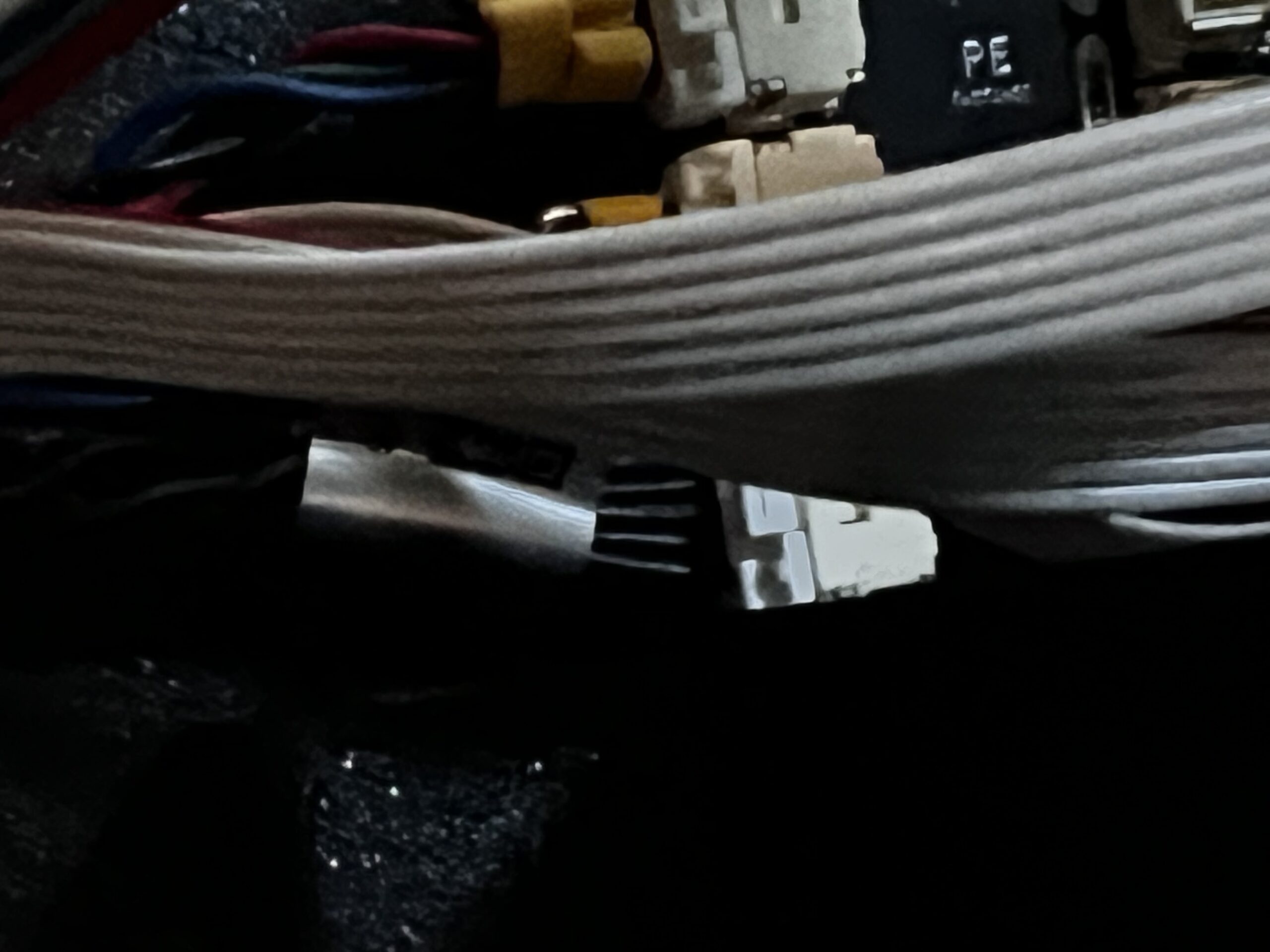

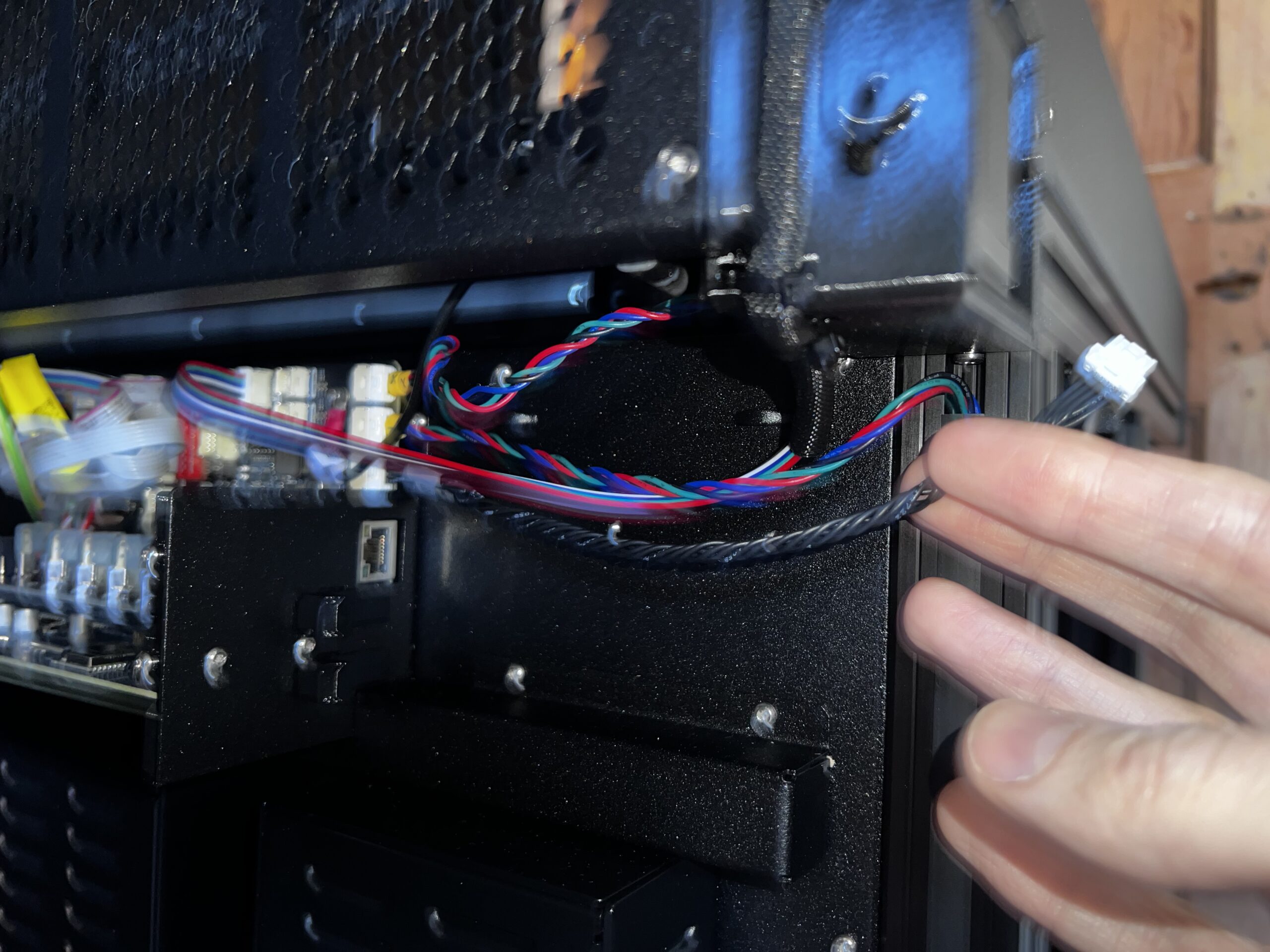

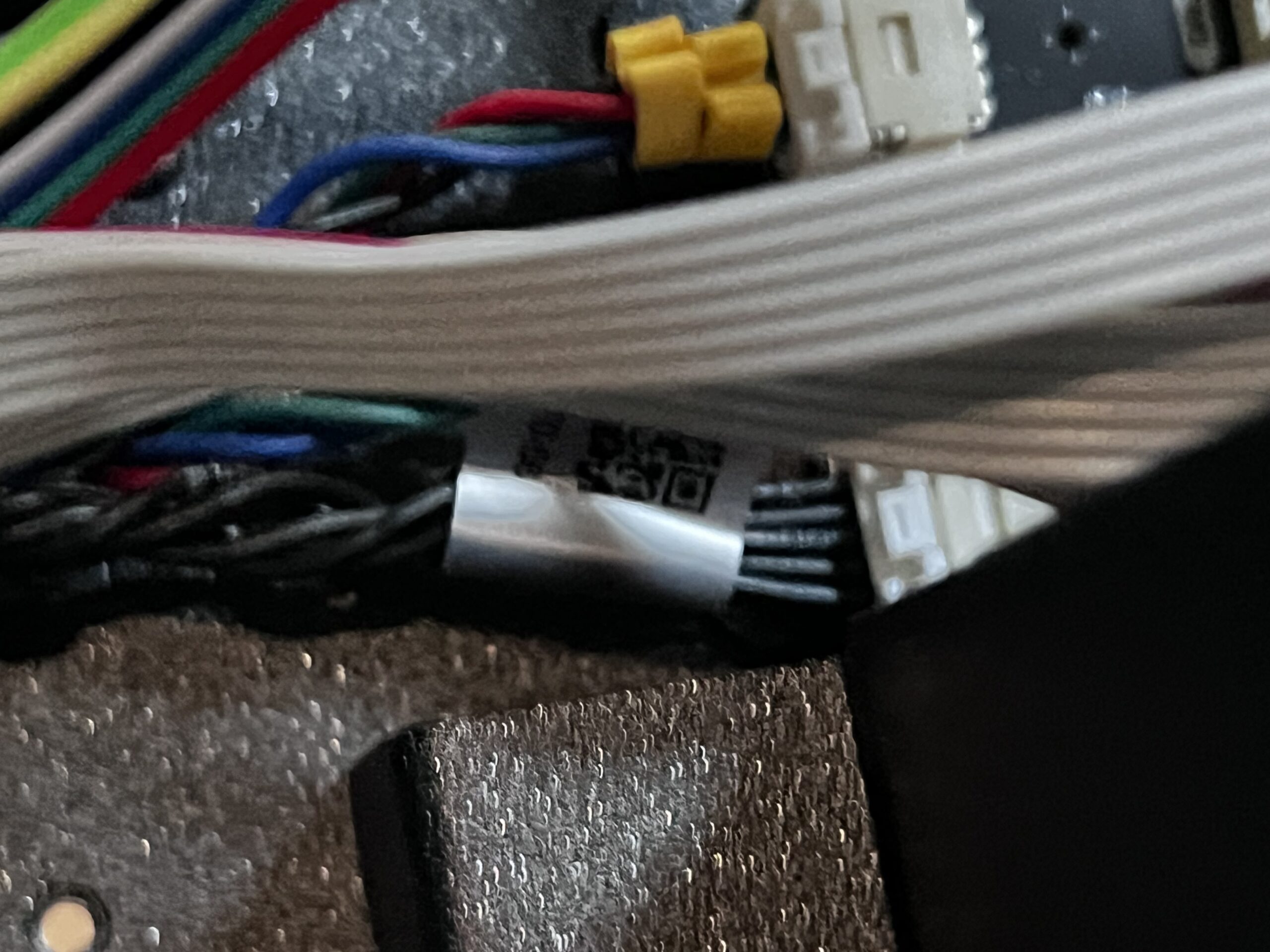

If you’re looking at moving the filament sensors, these photos might also help. If you can sort additional extension wires/connectors out it should be a pretty simple job…
