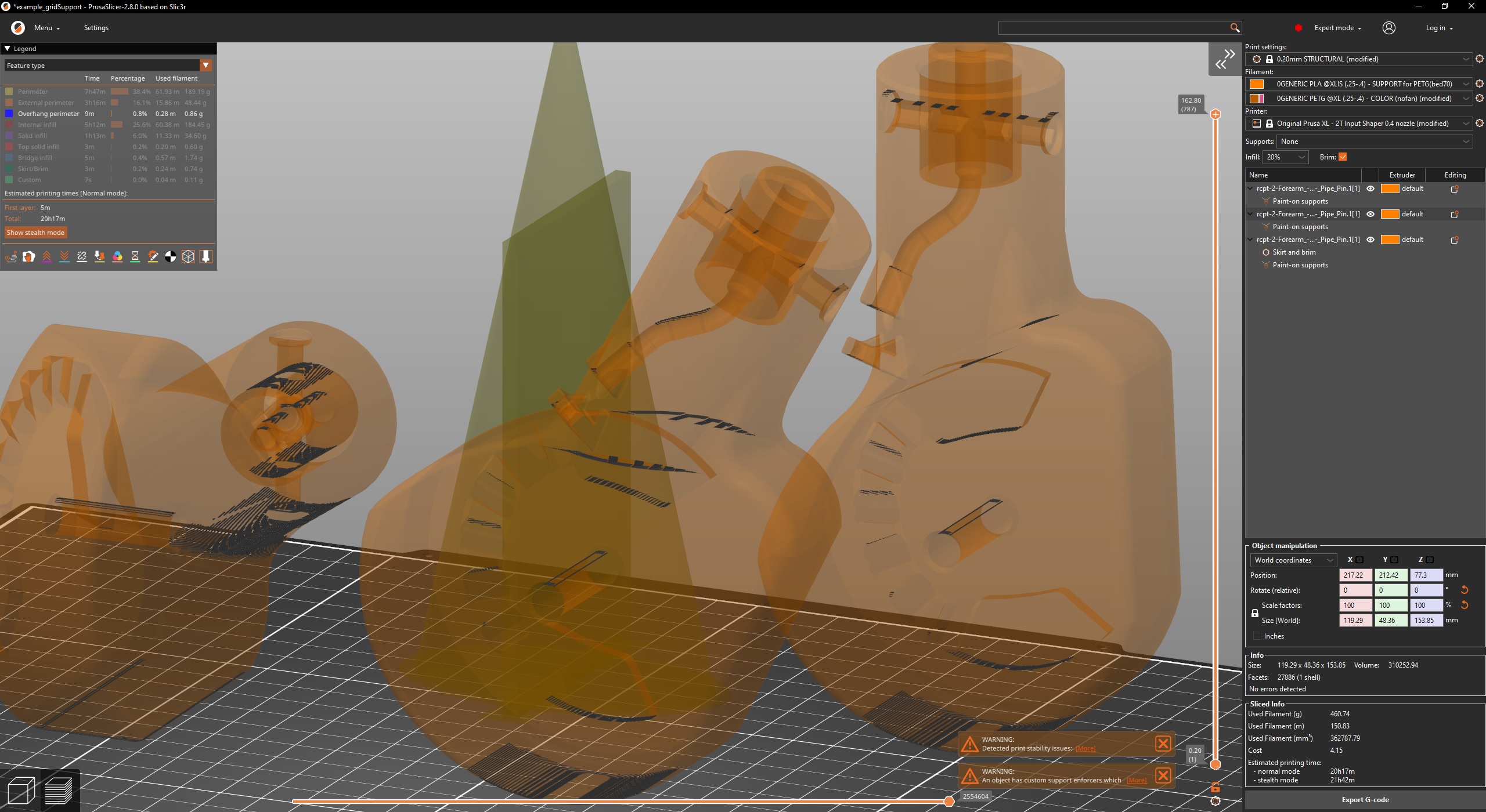

Question. Coming across to the XL from the Mk3S+ printers we have. I have the settings working well for PETG supported by PLA. But now I need to print a fairly complex piece and I know from experience where the supports are needed and where they are not, like inside internal channels. So, I painted on supports and support blockers. I've assigned extruders for support and part under the Multiple extruders tab. But if I don't select "Auto generate supports" but do select "Generate support materials" no supports come up when sliced. If I select "Auto generate supports" the it's like I never painted on the supports and I get them in problem areas. I'm sure I'm missing something?

You have selected 'For support enforcers only' from the dropdown on the plater screen..?

Yes, have those selected. That's why I'm scratching my head!

The file you uploaded is basically just the stl without any of your print settings. But I took a shot at a few ways I'd attempt a print of it. At the very least you can compare settings to figure out what you're missing.
The overhangs don't look too crazy depending on how you orient the model. Horizontal will give you the strongest 'arm' but you'll need some small metal picks to dig support out of there.
example_gridSupport

Sorry, forgot to save the 3mf instead of stl. I'm juggling a herd of cats and people asking for help here! I just can't figure out why it wont just print the supports on the support enforcers. Off to the doctor in the morning then I'll be back on this.
