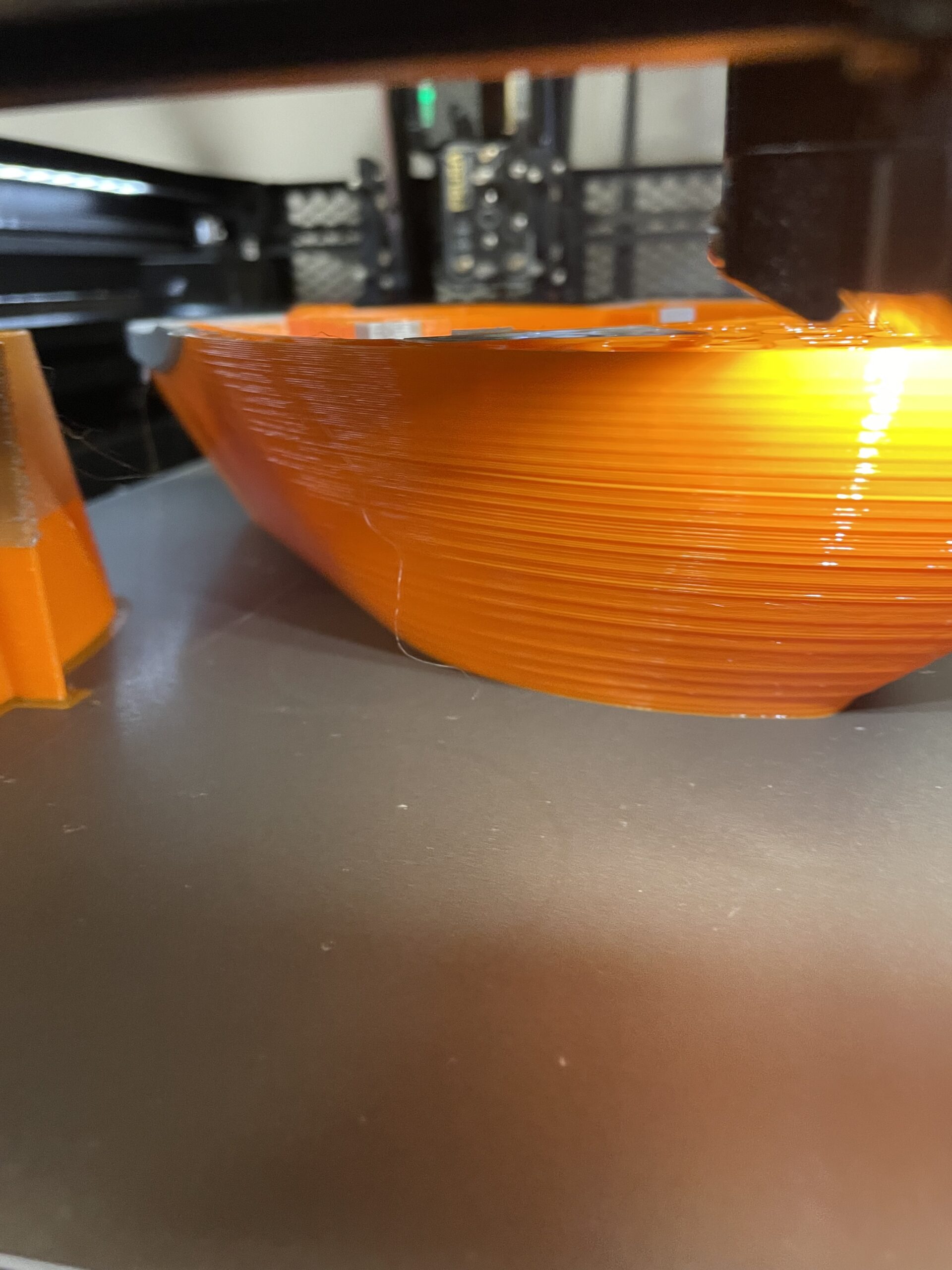

Has anyone had experience with the linear rail making a squealing noise? Prints also suffer from pretty bad z banding. It only has a few hours, test print of helix gear came out clean. I blamed the first ugly banded looking print on the Sunlu filament not being calibrated, after changing to Polymaker it is producing the same results.
Video that has sound of rail https://youtube.com/shorts/G7YvRe_PUXc

It could be that the rail is not tight enough on the aluminum profile.
If necessary, tighten all the bolts in the rail. Hope this solves your problem.
