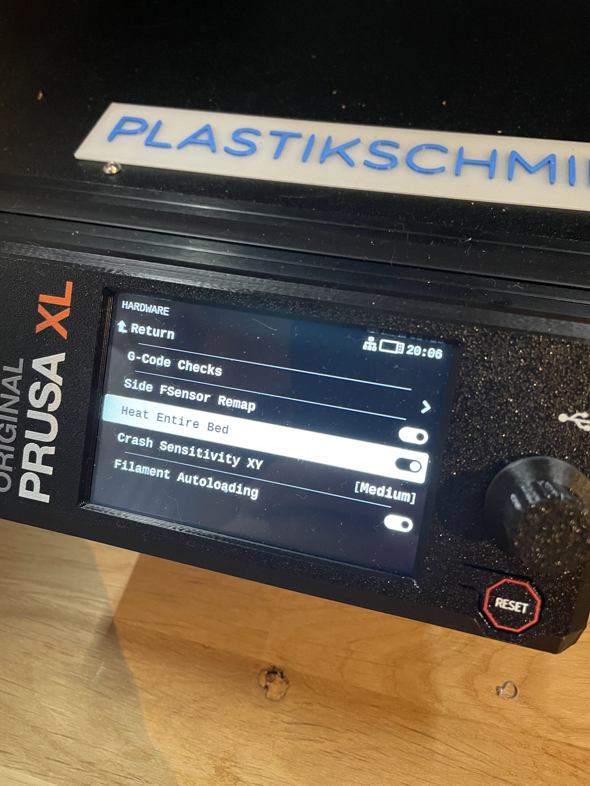

Hi Folks!
How do I turn on the heatbed completely and not just for the area where the model is printing?
I'm having a hard time maintaining a good heated environment without an enclosure so I hope this helps.
I couldn't find an answer elsewher.
Happy Printing!

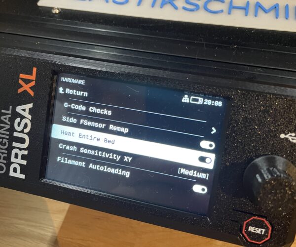

Plastikschmiede
(@plastikschmiede)
RE: Turn on the Heatbed complete XL / Turn on every Tile
Posted : 13/01/2024 7:42 pm
Plastikschmiede
(@plastikschmiede)
There’s an option in the „Hardware“ submenu. Unfortunately you can only access it when your not printing.
