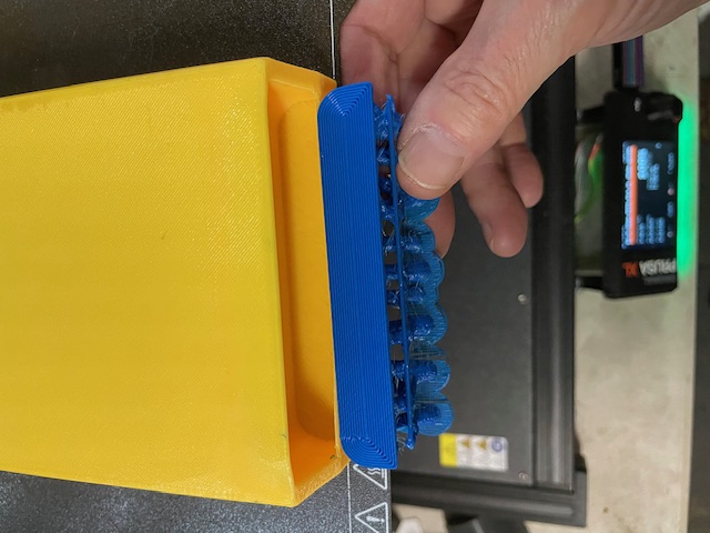

jsawyer
(@jsawyer)
Printing PLA or PETG on the other as supports will not work.
The two materials will not stick to each other. That is exactly why you want to use them as supports for the other. The trick is to only support from the bed.
I run prusament, overture, and a couple of other brands without any issues.
I have filament profiles that have the bed temp at 70C for both materials.
You need to make sure that your top contact z distance is set to 0(soluble) .

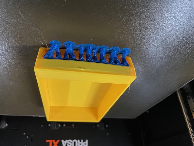

Tobycwood
(@tobycwood)
RE: How feasible is printing PETG for PLA supports?
Works fine. Yes the supports have to be on the bed…
Posted : 19/01/2024 11:30 pm

Tobycwood
(@tobycwood)
Another pic before I remove the supports
Posted : 19/01/2024 11:31 pm
