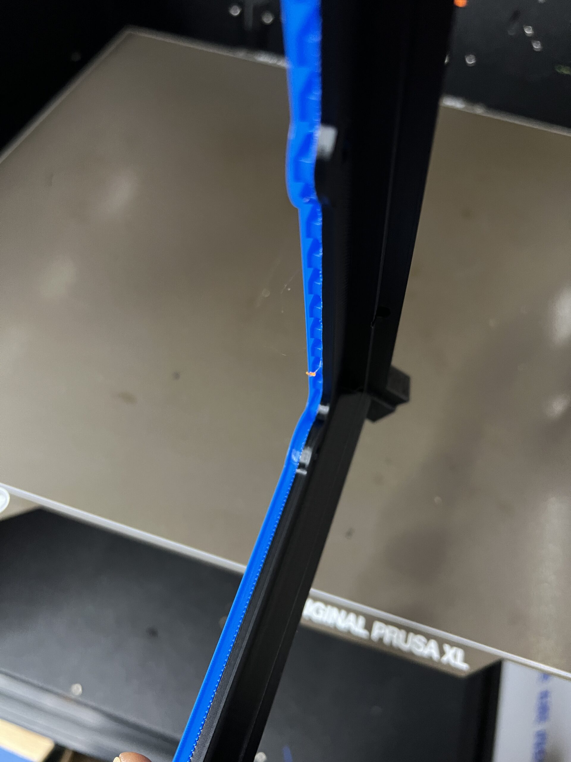

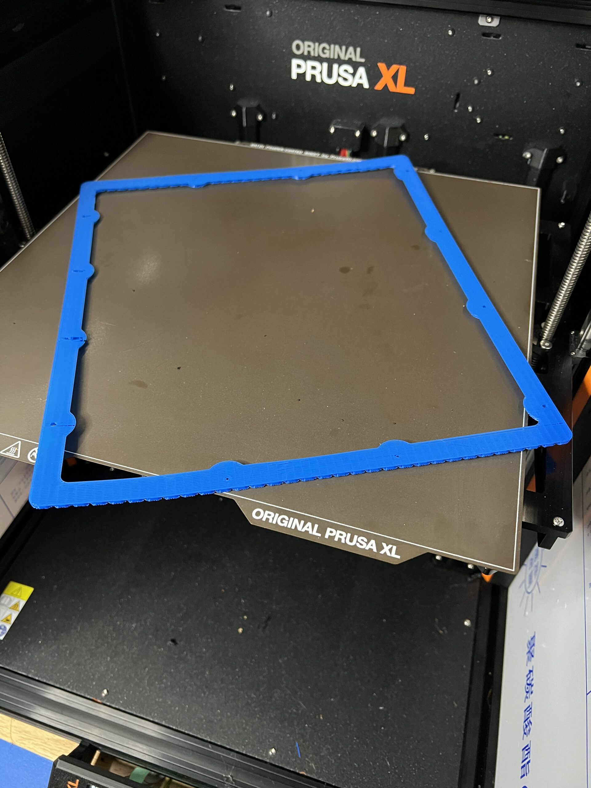

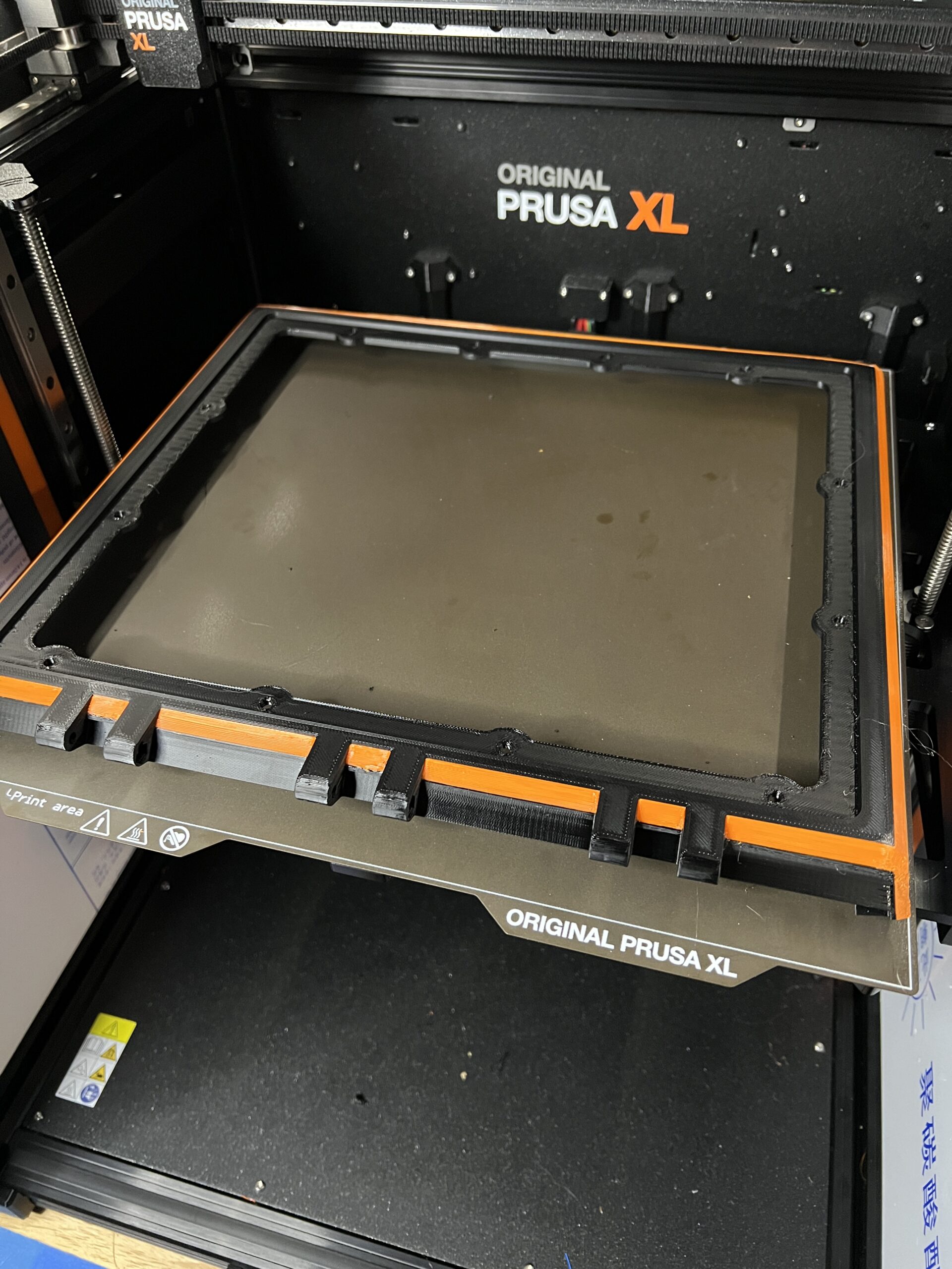

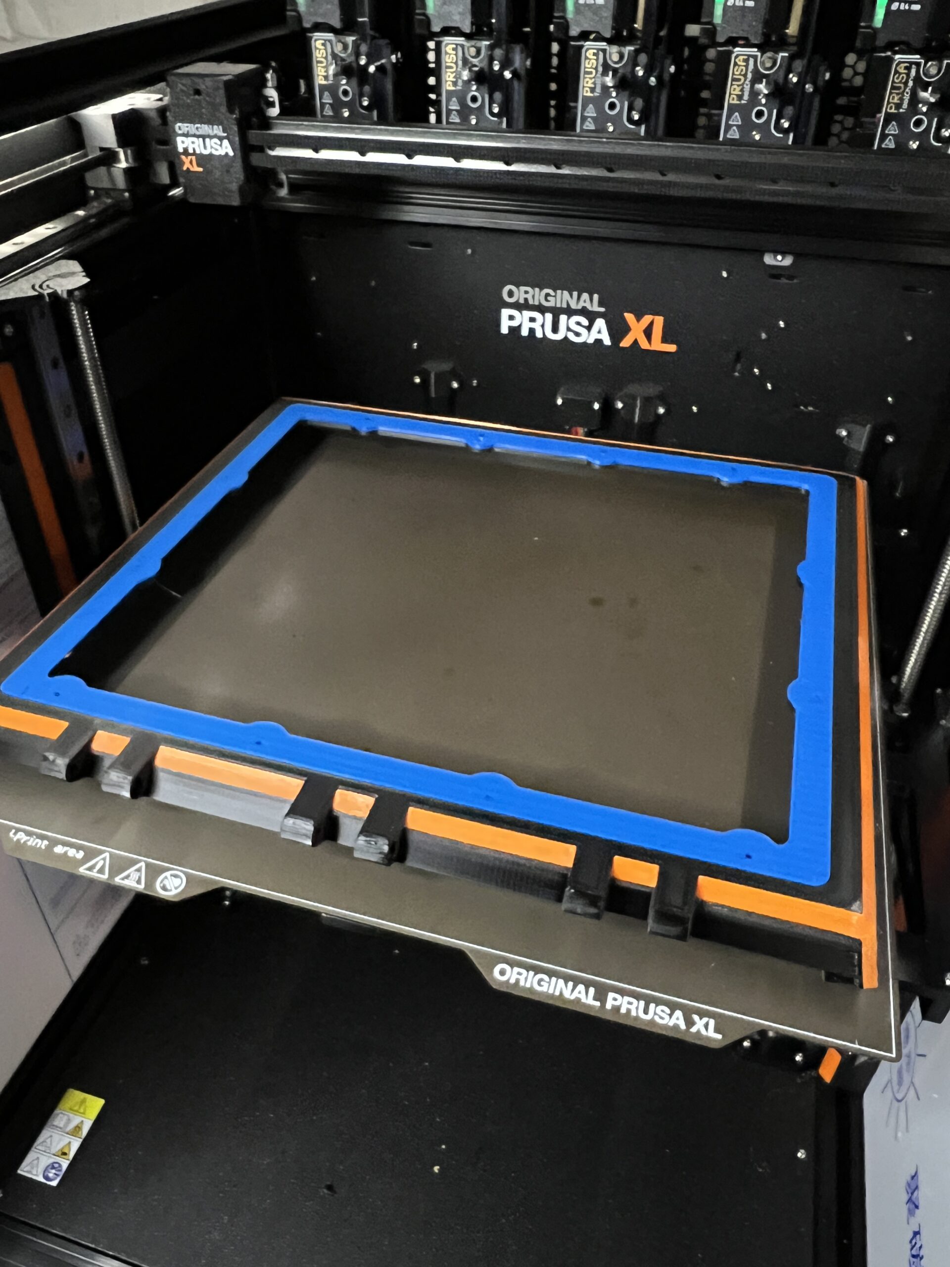

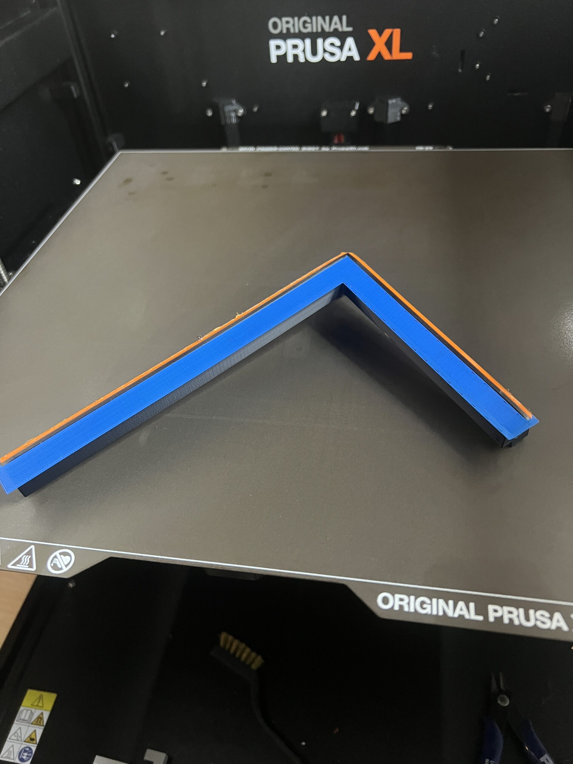

Another pic before I remove the supports
What about parts with small details? I have a test item I print to determine how well they'll work together and I couldn't get PLA and PETG to stick well enough to complete the test. Part of the test is the wipe tower.
The best combination of materials I've found is Essentium HTN with Amazon Basic PETG as supports. It works perfectly. I'd love to know of other similar combinations that stick together when hot but not when cold.
