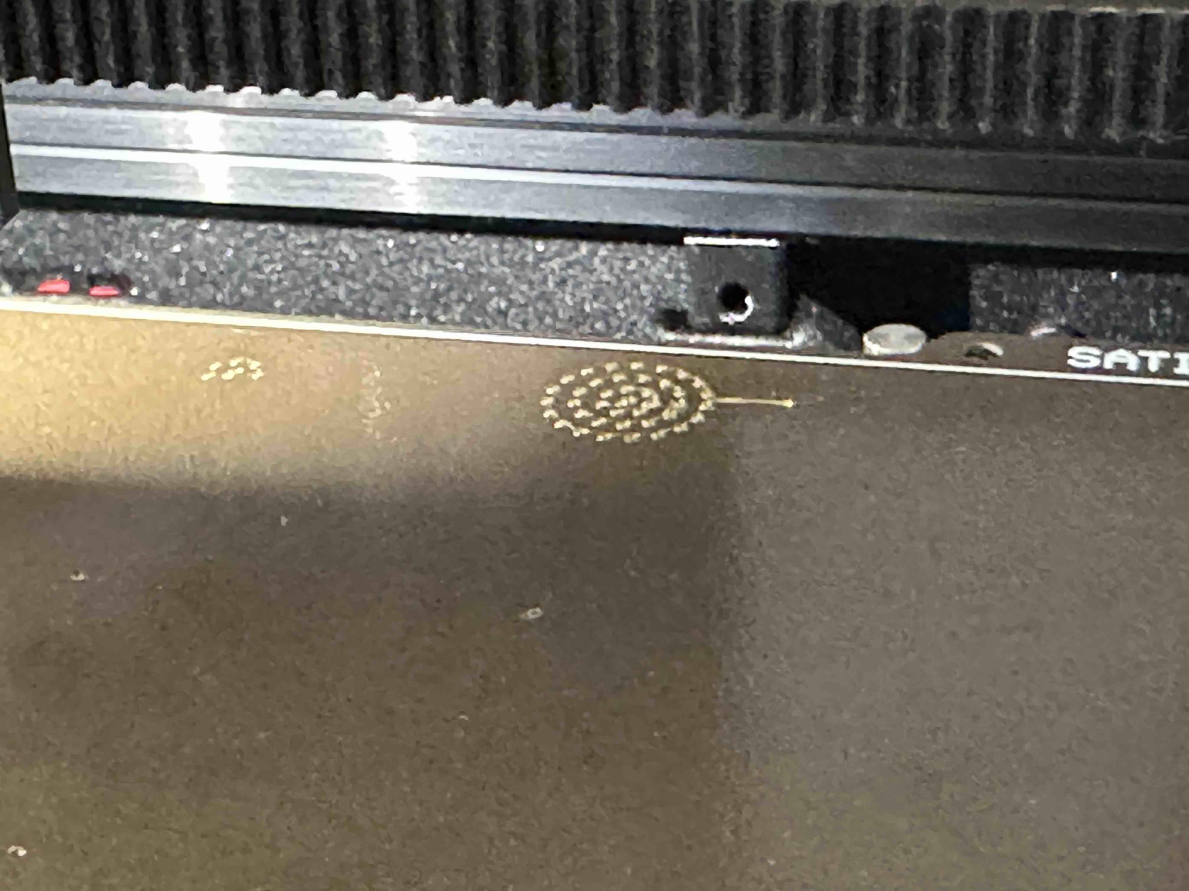

Same, 100% failure rate at the cleaning step at the start of every print I believe. Probing seems slower as well, but I don't keep a close eye on it. It's super frustrating to have to manually intervene on the cleaning every time.
Posted by: @1eye
I'm still having these issues with failure to complete a nozzle cleaning and this annoying "probe the bed a stupid amount of times" issue. How do we turn this off but keep the 6.4.0 firmware? What should be a 30 minute print takes an hour because it insists on probing around each probe point. I have cleaned the nozzle several times and it still goes through this annoying process. This was never an issue before.

Also getting the `The G-code isn't fully compatible` on my 5 head XL with 6.4.0 firmware and everything else updated.
If it is needed to switch to the `Prusa XL-5T Input Shaper` profile, it should be communicated upfront... this is so silly...
Also, I wasn't able to ever use the `Prusa XL-5T Input Shaper` profile because calibrating for input shaping always fails... So maybe there should be a better procedure to make that work.

@james-ramsey, this is funny as I NEVER got any bed levelling issue... except in my last few prints on 6.4.0
before, the head was probing few points here and there, then started to print.
Now, it probe few points, then start probing in square or in circles, then fail...
After rebooting the printer, everything went well...
I guess I'm going to wait for 6.4.1, if that ever comes out...
