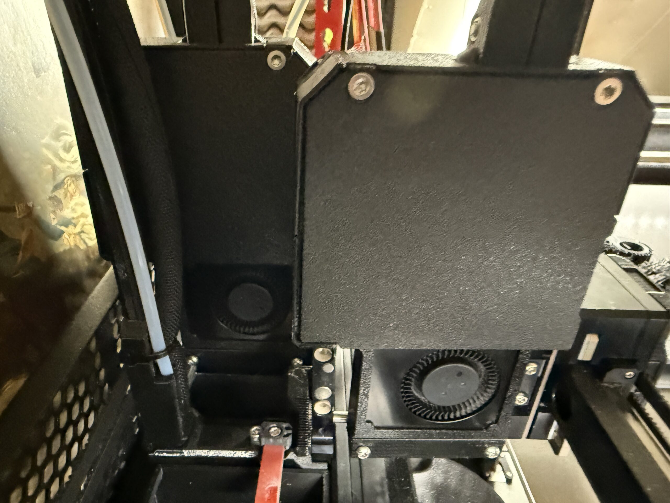

As of 6.4.0, the XL still crashes toolheads into one another. It is inexcusable.
Latest firmware. I do not want to hear that this is a filament drying problem, or something I should expect from such irredeemably ancient technology as a three year old printer, or that this is just the way that tech is, or what have you. This is not user error. This did not happen because of improper build surface preparation, nor did it occur because of some error on my part in slicing. Screws backing out cannot cause this. Improper assembly does not cause this. Wrong torque values also do not cause this. This printer passes calibration tests very reliably. This happened because the latest firmware still cannot recall what tool it is holding.
That is a build plate full of ruined PCCF Prusament, which costs 65 dollars per 800g. It is ruined because the XL attempted to park toolhead 1 where toolhead 2 is.
This machine has done this intermittently on every firmware I've used for it. It has done it for multiple other users.
https://forum.prusa3d.com/forum/original-prusa-xl-multi-tool-upgrades-hardware-firmware-and-software-help/toolchanger-with-tool-2-strikes-tool-1-on-dock/
I cannot imagine this is a very hard problem to solve. Is there some reason the firmware cannot keep track of which toolhead is where? Is the combinatorial complexity of this task beyond that of calculating Ramsey numbers or some such thing? Or rather, I posit the following: it is exemplary of how abandoned this machine is. I am done claiming "it's abandoned but at least it works", because it doesn't. I probably have a 50% build failure rate. The XL has been utterly abandoned. I am not satisfied with a silicone toolhead, because I do not wish to waste specialized silicone material. I do not wish to randomly drop nuts and magnets all over tarnation with the pick and place toolhead. I wish, in fact, for this nearly 3000 dollar printer to work as well as the 10+ MK3S printers I have owned over the years.
This is not hyperbole. Please fix this issue. Thanks.

I was also hoping to own an XL that would work just as stably with the 6.4.0 firmware as it did with 6.2.6. Unfortunately, I was wrong.

Just attempted to print this again. Check that out. Another wasted ten bucks or so. Why? Because it crashed toolhead 1 into toolhead 2 again.
So what do I do now? Go start inspecting firmware source code, tweaking settings like I did in 2016? Go buy a Bambu so they can steal all my data? Because this is simply not acceptable at all. This is not a hard problem to fix.

Reinstall firmware 6.2.6 and be happy that the printer is doing what it's supposed to do again.I had similar problems to yours after I wanted to test 6.4.0.
Since I reinstalled 6.2.6, my XL has been printing again without interruptions, day after day, for hours on end, without a single ERROR.

It's odd that your having so many problems with it.
I'm running 6.4.0 and have been printing pretty much non stop for the last 2 weeks with prints using 2 tool heads of PETG and 90A TPU.  I even used spool join on 1 print as I emptied a roll of petg.
I did have some weird artifacts on a free prints, but narrowed that down to a big in the latest version of PS.  I downgraded to the previous version and no more problems.
I also did 2 prints with PCCF which I run dedicated in head#5.  They weren't real long prints, only about 8 hours, but no issues.
Is it possible you've got a bad calibration on tool head positions? Something's going on mechanically I think, or else everyone would have crashing heads, which I haven't had happen in over 2 years.

There's actually lots that needs to be calibrated.
There's the tool head offset calibration.  If this is off I would imagine lots of tool crashes would occur as the offsets between the nozzles on each tool head would be incorrect.  This would cause the nozzle to crash into the part on multi color or multi material parts.  It could also lead to poor print quality as the layers between heads would not line up.  This calibration needs to be repeated every time a nozzle is changed, and you have to make sure the nozzles are completely clean, no residue at all or this calibration will be incorrect.
There's also the dock calibration.  If this is done wrong, or if the dock is loose, this will cause lots of tool head crashes, and layer shifts.
So I suspect these are good candidates for not being done correctly, or not done when needed, like when a nozzle change is done.
So your comment shows that most users are not familiar with the machine, and don't know how to use it properly.  It also explains why some have no issues and some have many.
