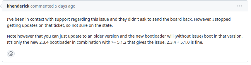

I will wait for a newer firmware than 5.1.2 now because it is pretty obvious that 5.1.2. causes issues for some people: See this discussion: https://github.com/prusa3d/Prusa-Firmware-Buddy/issues/3629
From that discussion:
