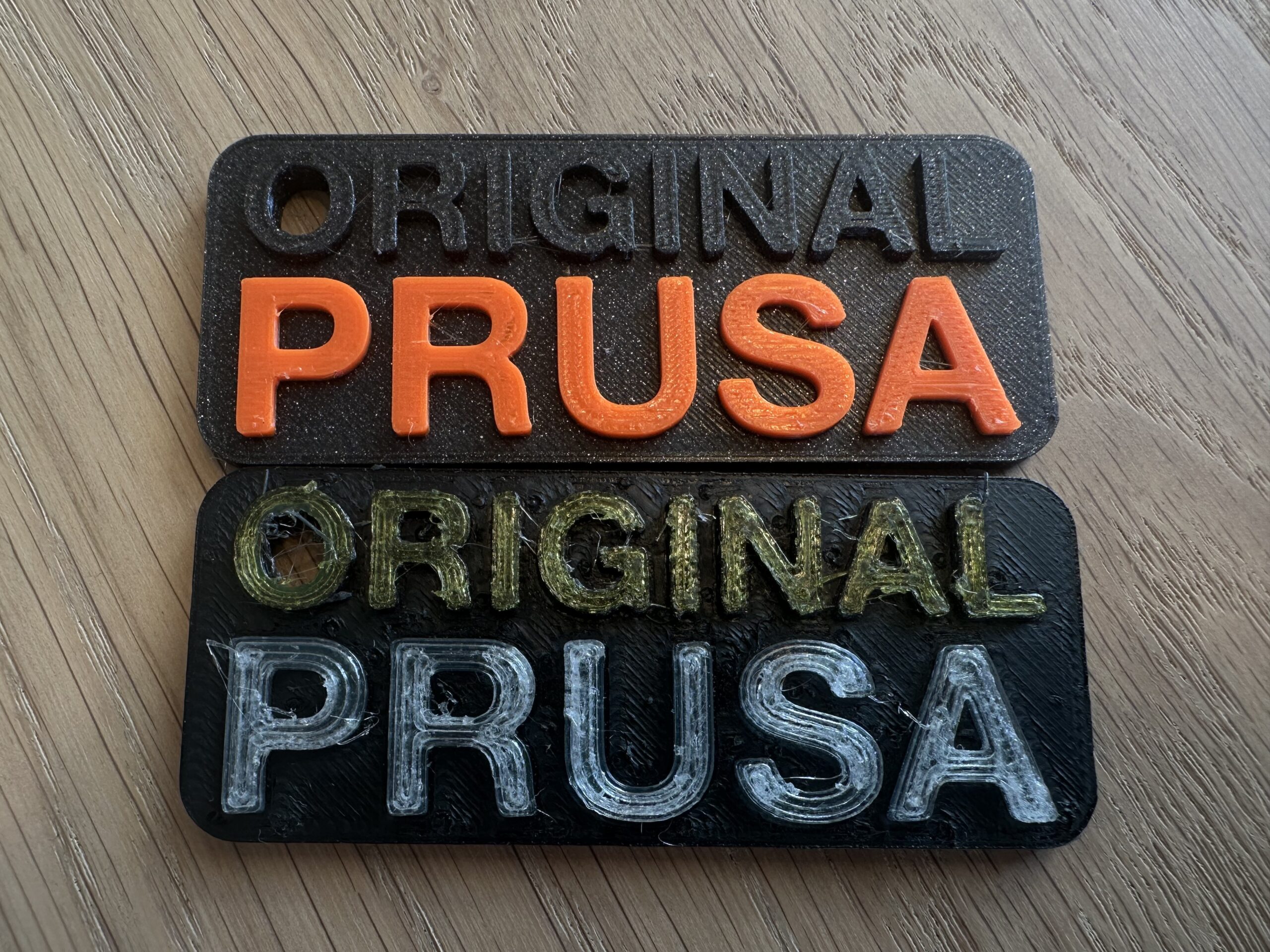

here is a test I did after assembly:
- on top: PLA test print as supplied on the printer bed.
- on bottom: PETG print (Prusament) sliced in prusaslicer with Prusament PETG preset. 5 colors in 5 toolheads. Massive stringing, under extrusion, and very uneven surface finish

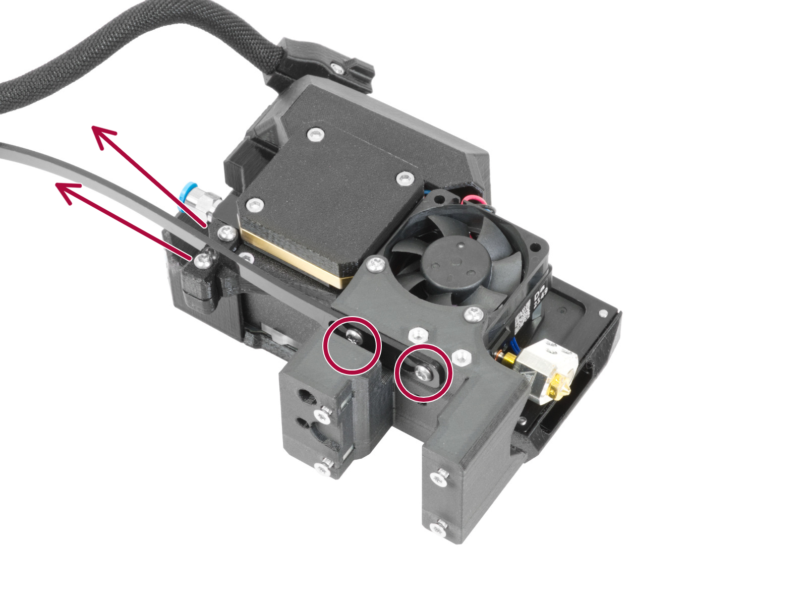

I have two extruder model that was assembled by Prusa.  I am having stringing issues as well as everyone else.  I've been wondering if part of the problem is the way the extruder block is angled towards the part cooling fan.  The multi tool assembly manual images show the extruder block angled toward the fan shroud. When I have the silicon sock on it is blocking a lot of direct air from hitting the part which would potentially allow for stringing.  If you look at the assembly images for the mk4, the nozzle block is more parallel to the fan instead of being angled towards it. It seems like the mk4 gets better part cooling. Not sure if that makes sense or not.

Looking at the actual 3d model for the mk4 there is a huge difference between both. The mk4 has a proper shroud directed at the nozzle while the XL basically just has a slot pushing air in the general vicinity of the nozzle. It's not even close to lining up with the nozzle too. Such a weird design choice.
Can wait for a community-made redesign of that part.

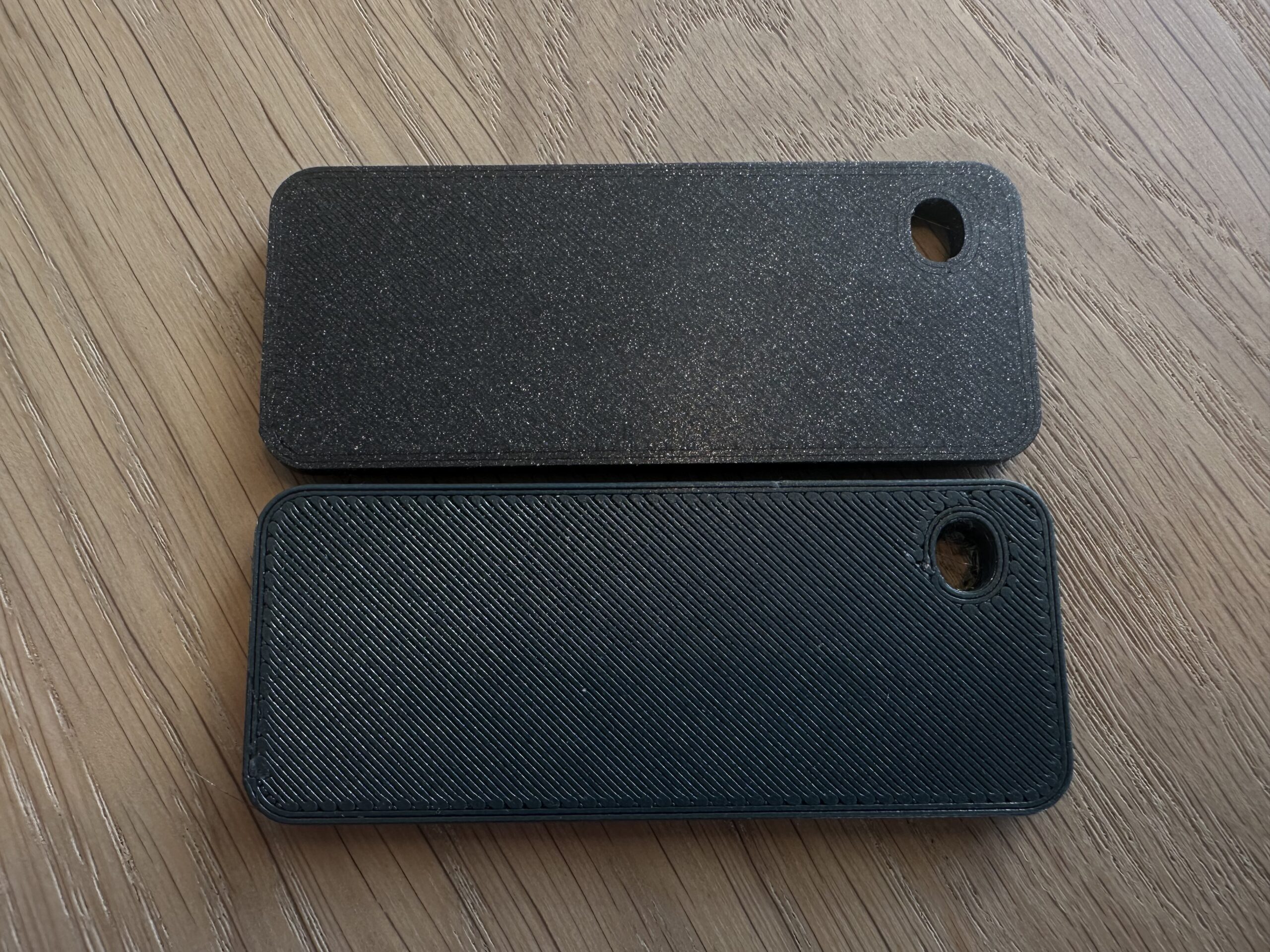

It seems like something has improved significantly.
The print quality has improved significantly since 2.6.1 and the current configuration. Especially with multi-material printing.
I print PLA from Eryone with 205c and 0.6mm Obxidian nozzle.
I also added the 3mf. file. So you can take a look at my config and also print it. Just click me!
It is very important that the nozzle seal is adjusted perfectly!
When pared, the nozzle should only press the seal down a little (1-2mm)
Here you can clearly see the difference!
On the left, you see the new print with better adjusted nozzle seal and Prusa Slicer 2.6.1
On the right, you see the old messy print with Prusa Slicer 2.6
