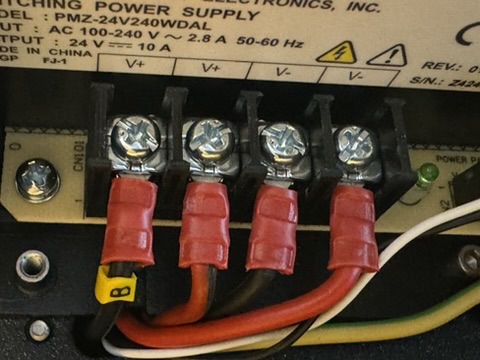

On my first power-up (and all since), the XL does literally nothing other than causing four LEDs on the buddy board and one on the LCD to blink periodically.
I spent many hours with support and have disassembled much of the back of the unit to find that the left power supply is not functioning; the right supply is putting out 24Vdc as expected.
A little digging into power supply features revealed that some supplies go into a "hiccup" mode where they attempt to power up into a short, then shut down again before damaging themselves. That would seem to explain the behavior of the buddy board and LCD panel.
What I don't know how to do is find where that short might be occurring. A schematic would be helpful.
Inspecting the power connections at the buddy board shows nothing interesting. What I can't see is what is inside the power distribution unit. On the assumption that everything tested OK before it left the factory and something was rattled free in transit, it seems to me there's probably a short in the power distribution unit somewhere.
Does anyone have insight into what might be going on?
Best Answer by dlm3:
Problem solved. The power supply terminals were miswired, shorting the power supply and causing it to go into "safe" mode. The correct wiring is the same as on the MK4 photo earlier in this thread - both red wires go to the V+ terminals, both black wires go to the V- terminal.
Machine is now calibrated and running properly.

Update: Took this photo of the wiring to the left power supply after removing the PDU. Does anyone have a photo of the wiring for a machine that works? (Prusa Support is working on it) I'm thinking it may be miswired since the power supply functions just fine with the loads disconnected and the colors of the wires don't look correct vs. the markings on the power supply (V+/V-)

that doesn't look right to me. but I don't have an XL to compare with.
this is how I would expect it to look!

That sure looks more correct. Hopefully Prusa gets back to me and confirms.

I talked to Prusa Support yesterday before you provided the photo. They didn’t have any reference material that could answer the question.
