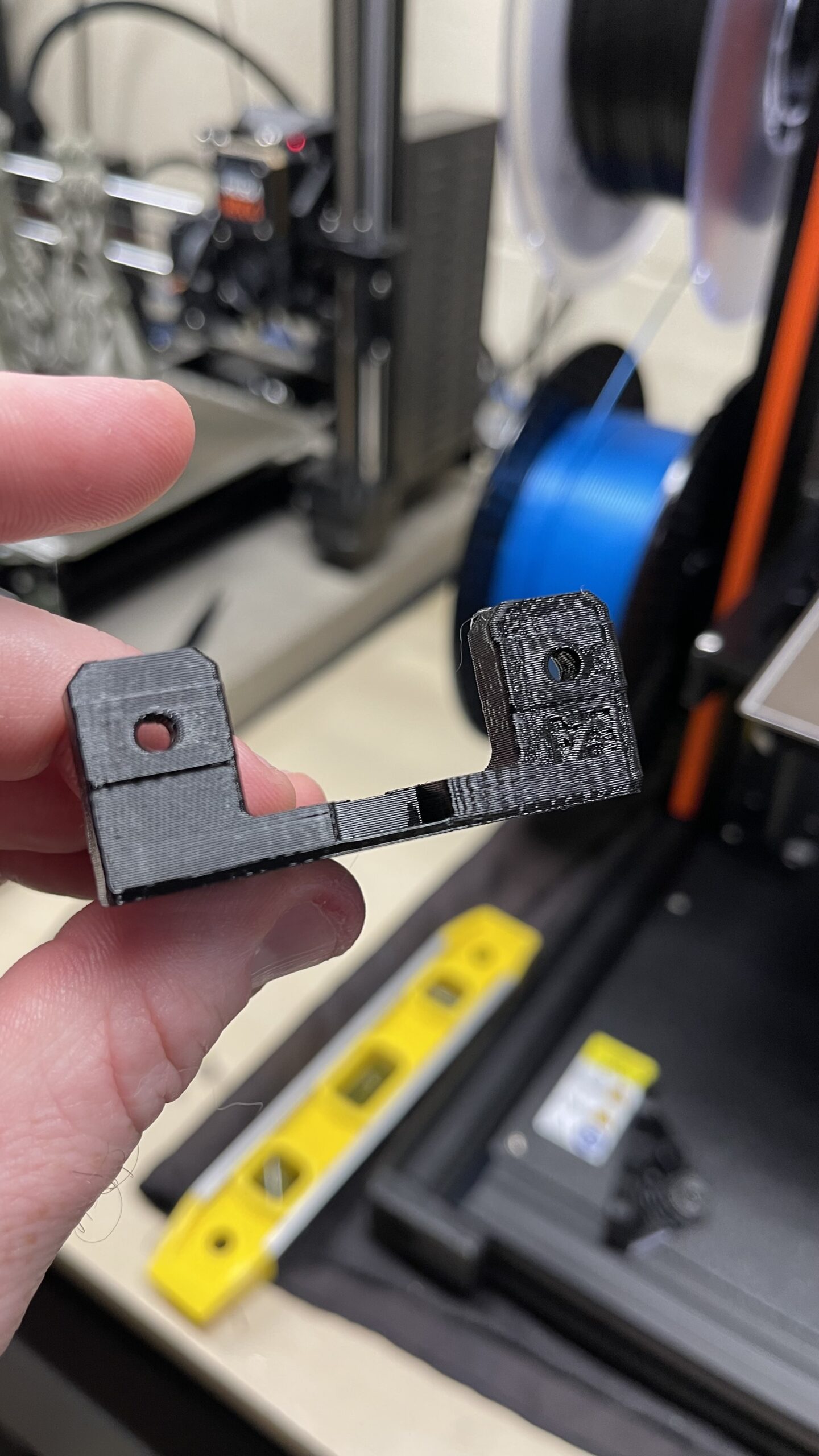

My latest email back from support had forwarded a link to updated Z Rod guides , I printed them out and installing them today while following a few other updates from them in the email as well . This was a factory assembled unit that seems to have had a lot of shortcuts on who ever did the assembly . I’ve attached the photos of the part that came off the machine labeled E4 and the updated part I printed in PETG labeled R2
