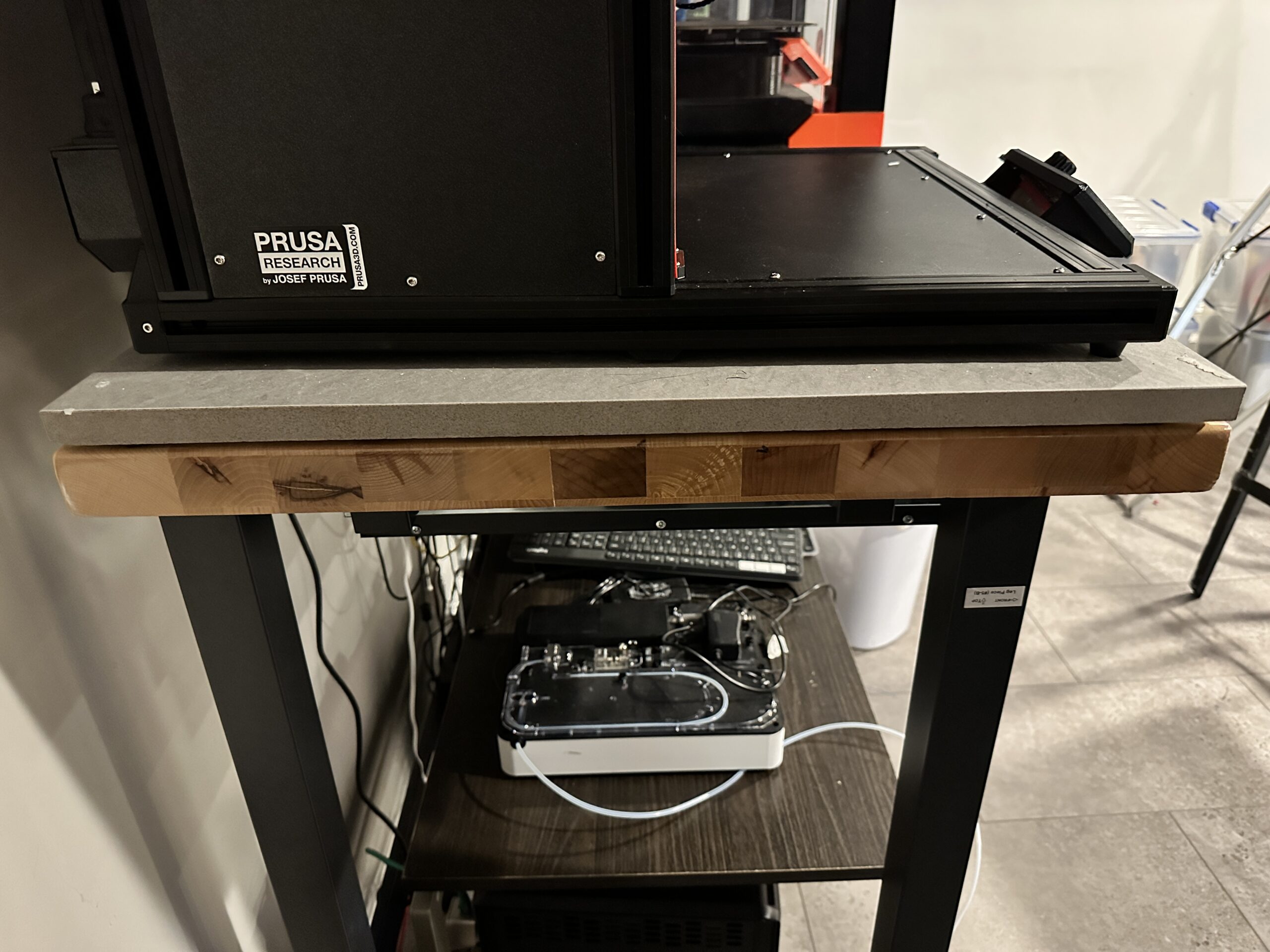

i don't have my XL yet but i thought i'd think ahead and plan where to place my XL. will this workbench work? TIA

24 inches is deep enough. I bought a 36 inch workbench, thinking that's what I needed, but when the printer arrived I found it fits onto a 24 inch workbench. Obviously the LCD display will hang over the front, though, but all four feet are on the workbench.

It's really not enough space. I have to pull the printer or the workbench forward. But then again, the only time I had to get back there was to read the serial number. Thus my pro tip: take a picture of the label!

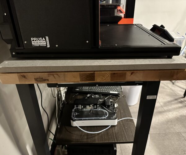

@ fuchsr:
May I ask what "the thing" in front of the picture of your workbench below the printer is (in front of the keyboard)?
Best regards, Clemens
RE: Workbench compatibility
this stone base makes any difference in case of prusa xl ?
I think it does. Without it, I found the vibration levels to be close to unacceptably high.

It's one of my unsuccessful forays into multi-color/multi-material printing. It's a Mosaic Palette 3. Like the MMU2, I never got it to work reliably, and it ended up in a drawer (well, under the XL 🙂). You basically feed multiple strands into the device and it splices it together based on how much material of a color/kind is needed when. It got off to an ominous start by filament randomly coming out of the machine sideways, but I fixed that by tightening all the screws. Eventually it "worked" but I routinely ended up with broken splices at unpredictable moments, so the whole thing was unreliable. Maybe if you spend an inordinate amount of time fine-tuning the parameters for splicing, but then again, you may need to this for any combination of filaments, and this becomes unworkable. I managed to get a couple of filaments tuned okay, but I don't print the same thing over and over again, so having one combination of filaments work is just not good enough,
