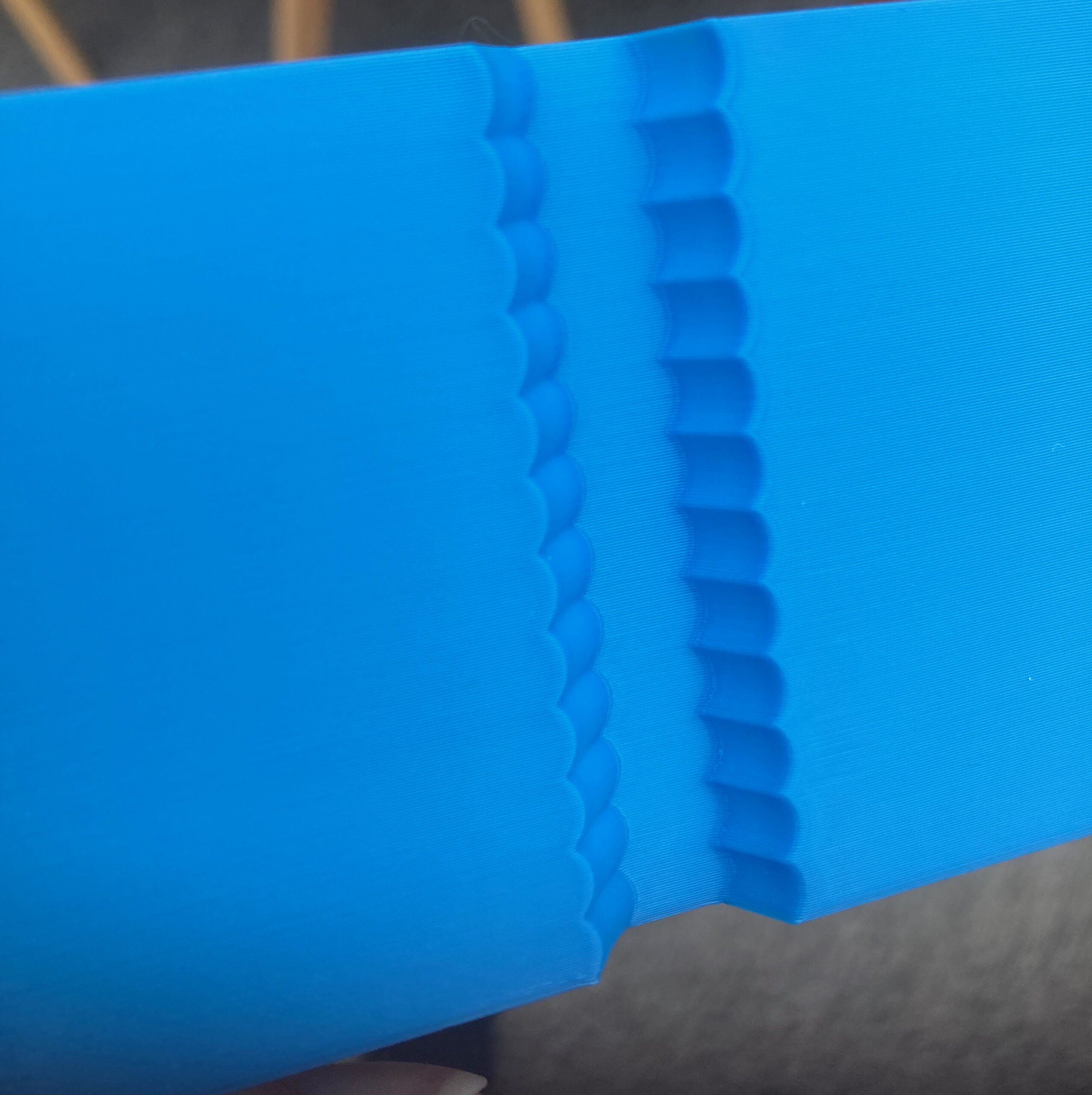

It is for me not clear if the MK3.5 handle input shaping or not.
I follow the YouTube from Chris Basement. When I look to the result than the quality is perfect.
When I compare to the result with the result of Chris it look like it does not have input shaping.
Who know the answer

HI, for me it looks like the Mk3.5 have no IS. Because when I check the .gcode for Inputshaping the Value for F=0
M593 X T2 F0
M593 Y T2 F0
https://help.prusa3d.com/article/input-shaper-mk4-s-mk3-9-mk3-5-xl-mini_451816

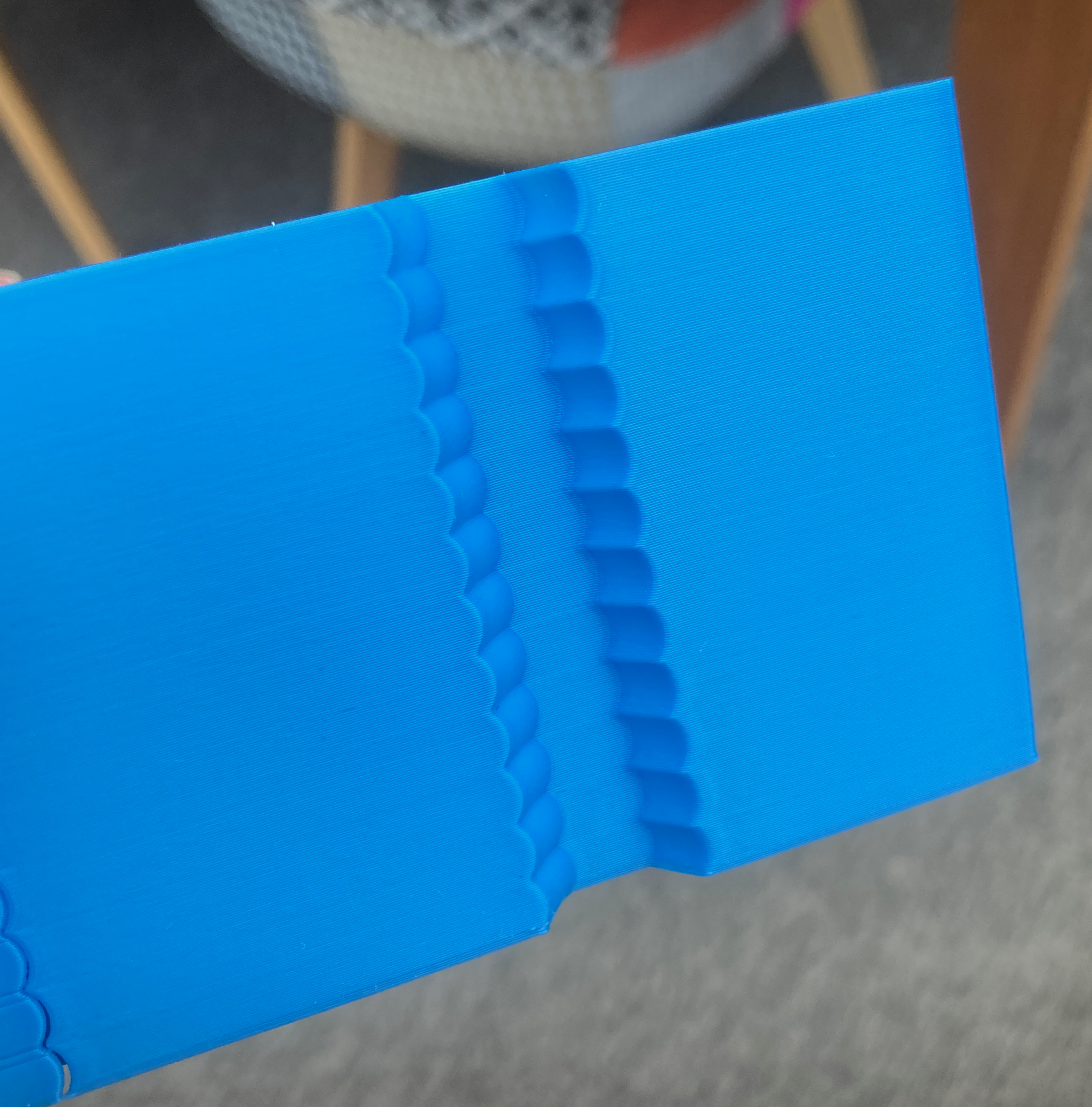

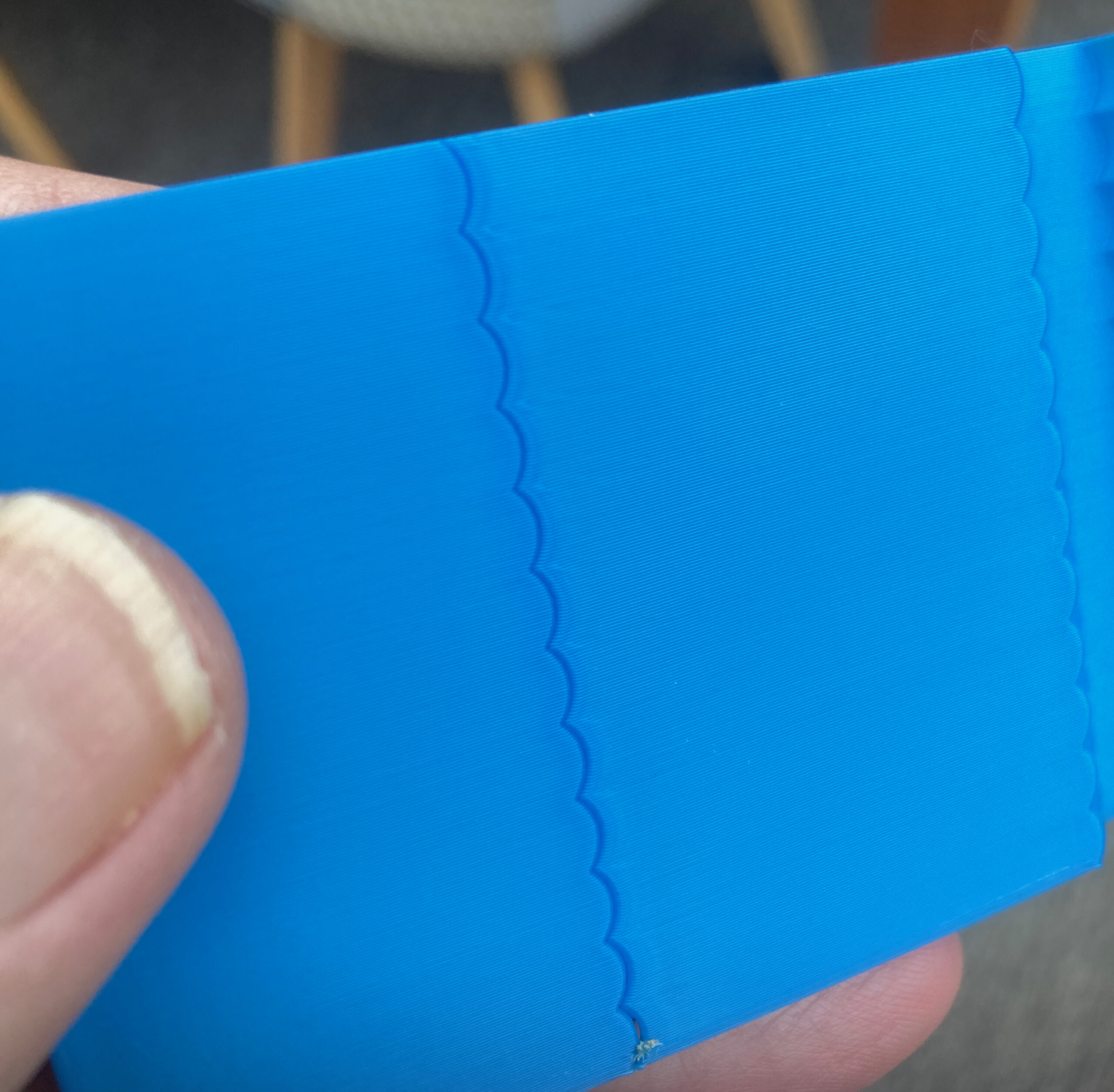

Oh yes is has. You could disable the input shaper in the menu and set it at "null" at both axis. You could hear and see the difference. I calibrated mine using the accelerometer which gave me extra quality and lesser ringing/ghosting. My x-axis gave me 35hz instead of the prusa standard value of 50hz, the y-axis was the same. I am using the lastest alpha2 firmware btw ;o)

the darker line you see is I raised the temperature during print to see what it does with petg. printed @speed profile .20 layer 0.4 nozzle, volumetric speed 12.
