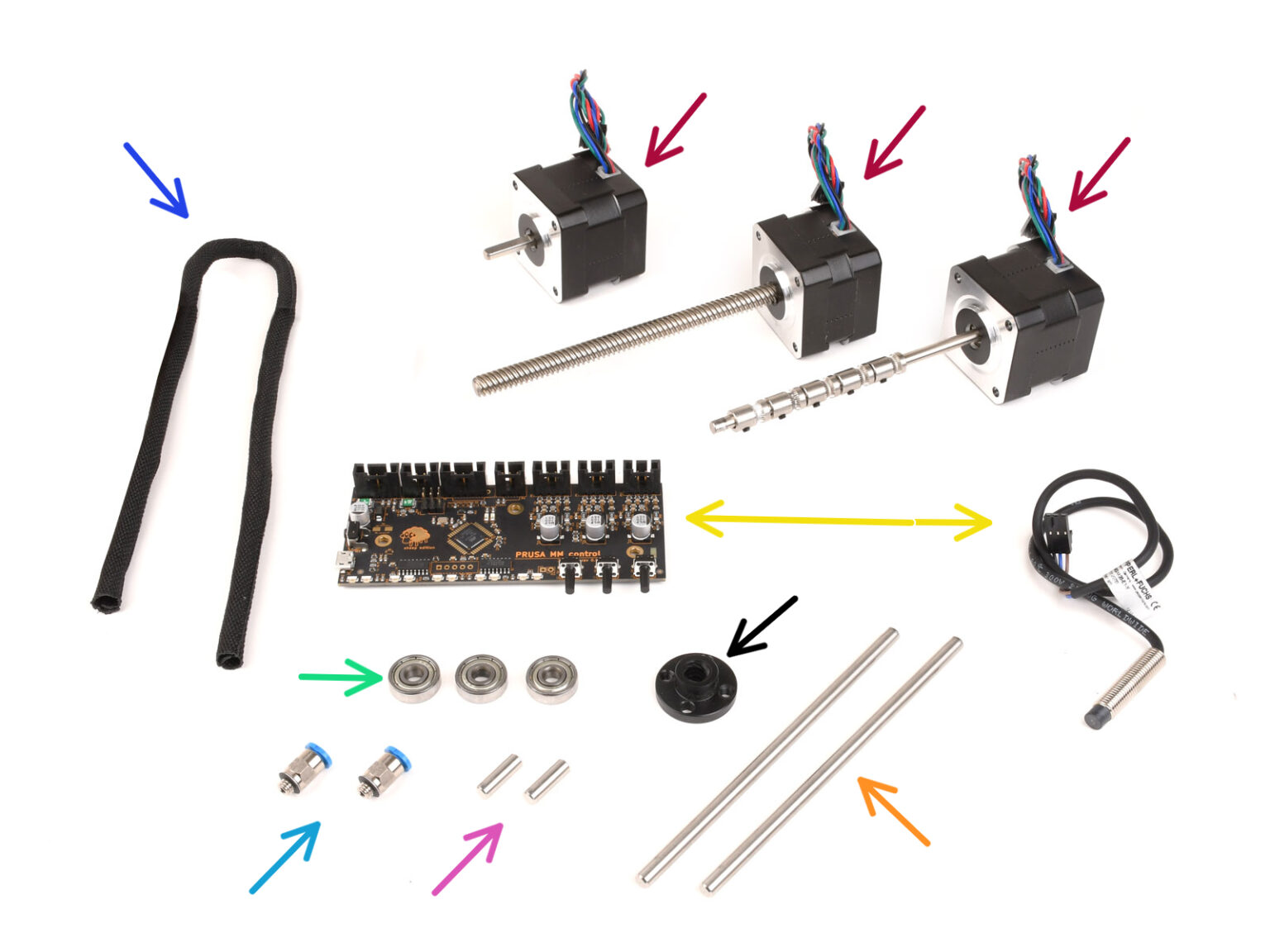

I am curious to know what will be the 99€ content value of the MMU3. I already printed the MMU3 parts on the MK4, except the ones they said will be in the kit.
This is what you should reuse from your old MMU2:
As you see from the picture, you have saved almost all parts of your old MMU2.
To complete the assembly of the new MMU3 the kit could contain only:
-  few plastic parts
-  the new metal coupler
-  power & data cables
-  some screws & nuts
-  the daughter board
-  some PTFE tubes
- the magnetic ball and the rectangular magnet
- the new brass bushing tubes (they do not tell to remove the old from the old MMU2)
At this point, now that the assembly instructions are available, I can't figure the 99€ values from the above parts.
Lets see if at least the main label plate will be there. If they omitted the part with inserts I have no problem to print it, since I have a machine for inserts.
I will not print the spool buffer, since I use the dry boxes with the spools inside. I will let you know what is inside, as soon as the package arrives.
