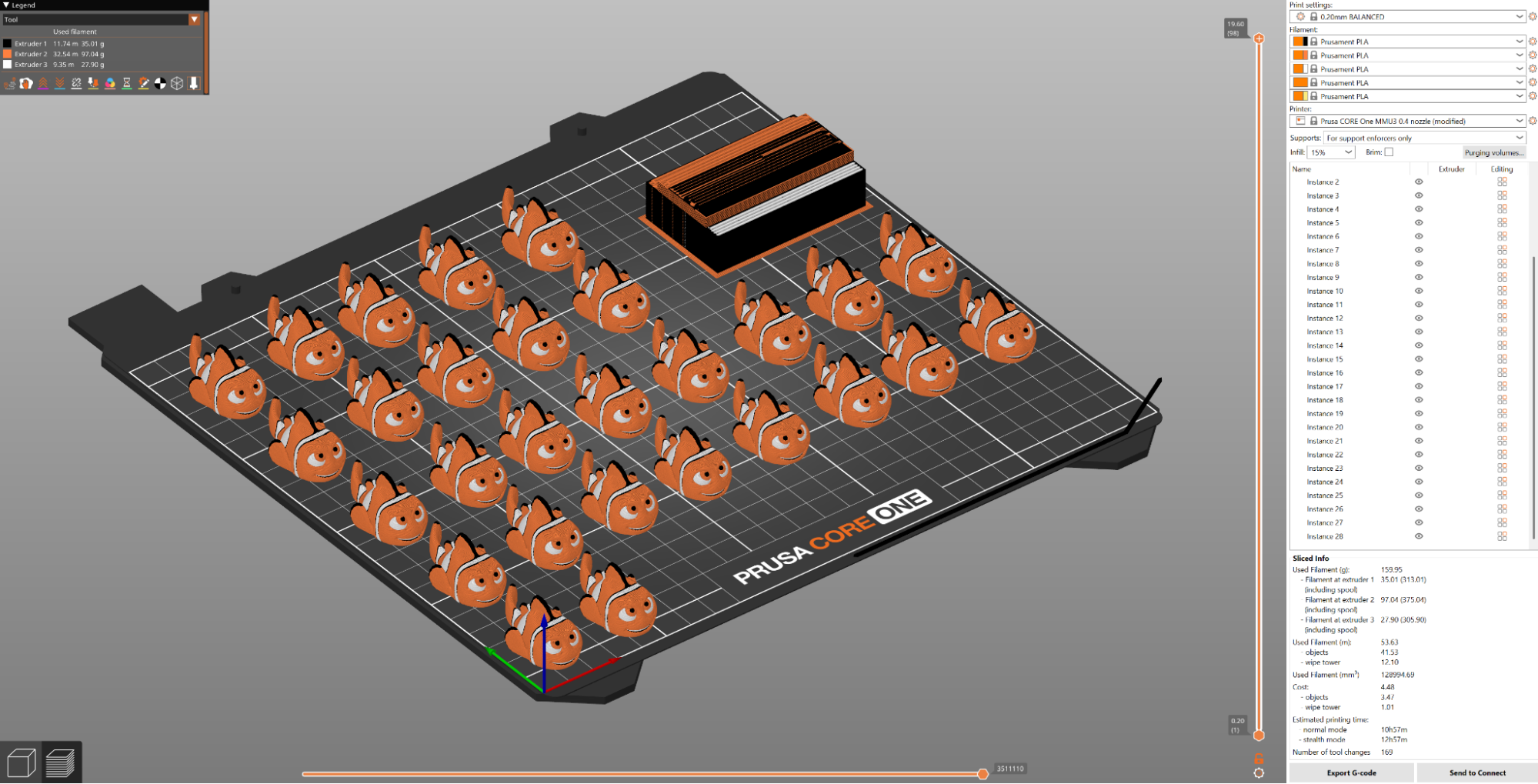

Nemo by Cipis
The math gets even better on production runs. If you’re printing a batch of 25 small items with 150 changes each, you save a significant amount of time. For anyone running a small business or cranking out prototypes, this is a huge timesaver.

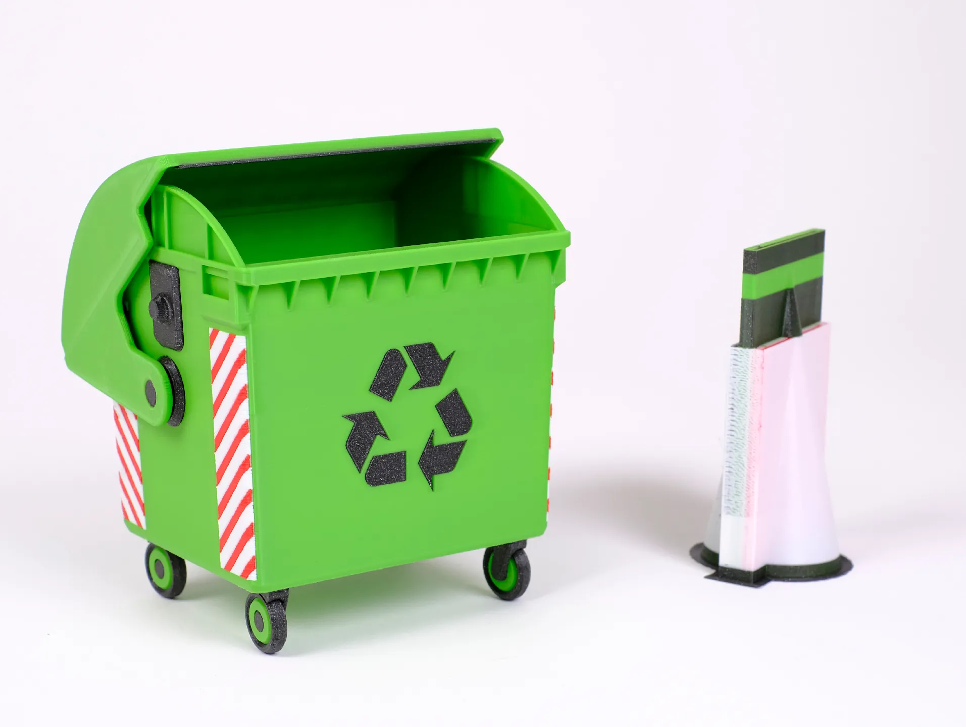

Printing the Benchbin is faster by 2 hours! Dropping from 23:41 to 21:48.

I noticed after doing the configuration wizard, then pushing the toolchange parameters from the Prusament PLA @ MK4s profile over and many changes from the default Printer profile (MK4s MMU3 0.4 nozzle) I don't see the estimated print time change in the slicer.
Am I doing something wrong? Or does the slicer not show the estimated print time changes? My prints are quite similar to the clown fish plate.
