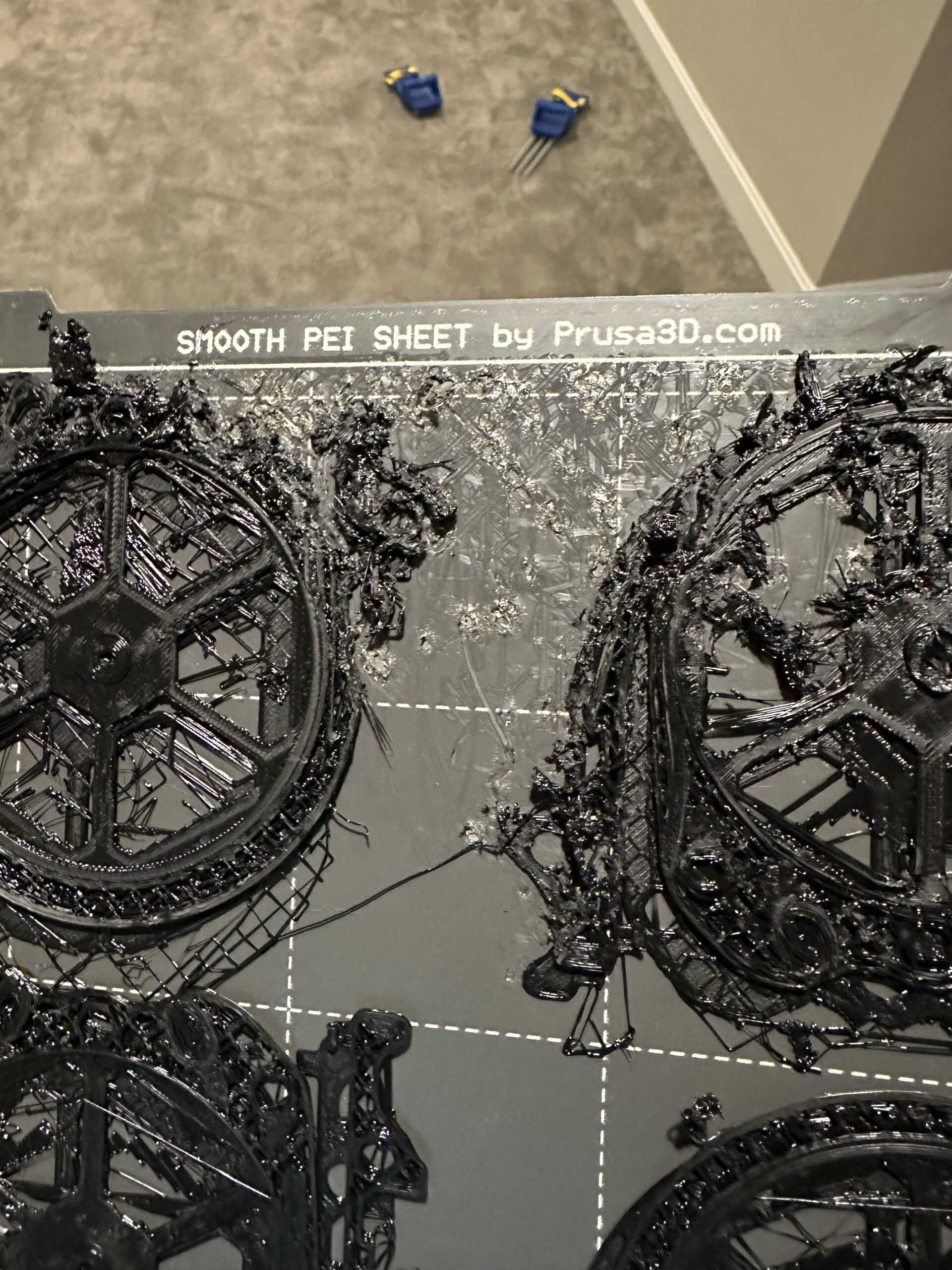

lasagna_printz
(@lasagna_printz)
Also there are some mentions of IS causing issues in PETG prints. I cannot confirm this as the cause but many of my PETG prints of late have been having globbing, which leads to layer shift (even with extrusion set to 0.9). Most recent print somehow knocked the nozzle itself loose and ruined the nozzle and the PEI board.
not being in any rush - i’d love to try non IS profile and see if that resolves.
note: I notice this mostly on prints with big flat surfaces on the bed - box bottoms and the like. Sometimes i can watch the print closely, pause, cut a blob off and resume - but this is a PITA. More vertical prints don’t tend to have the issue.
