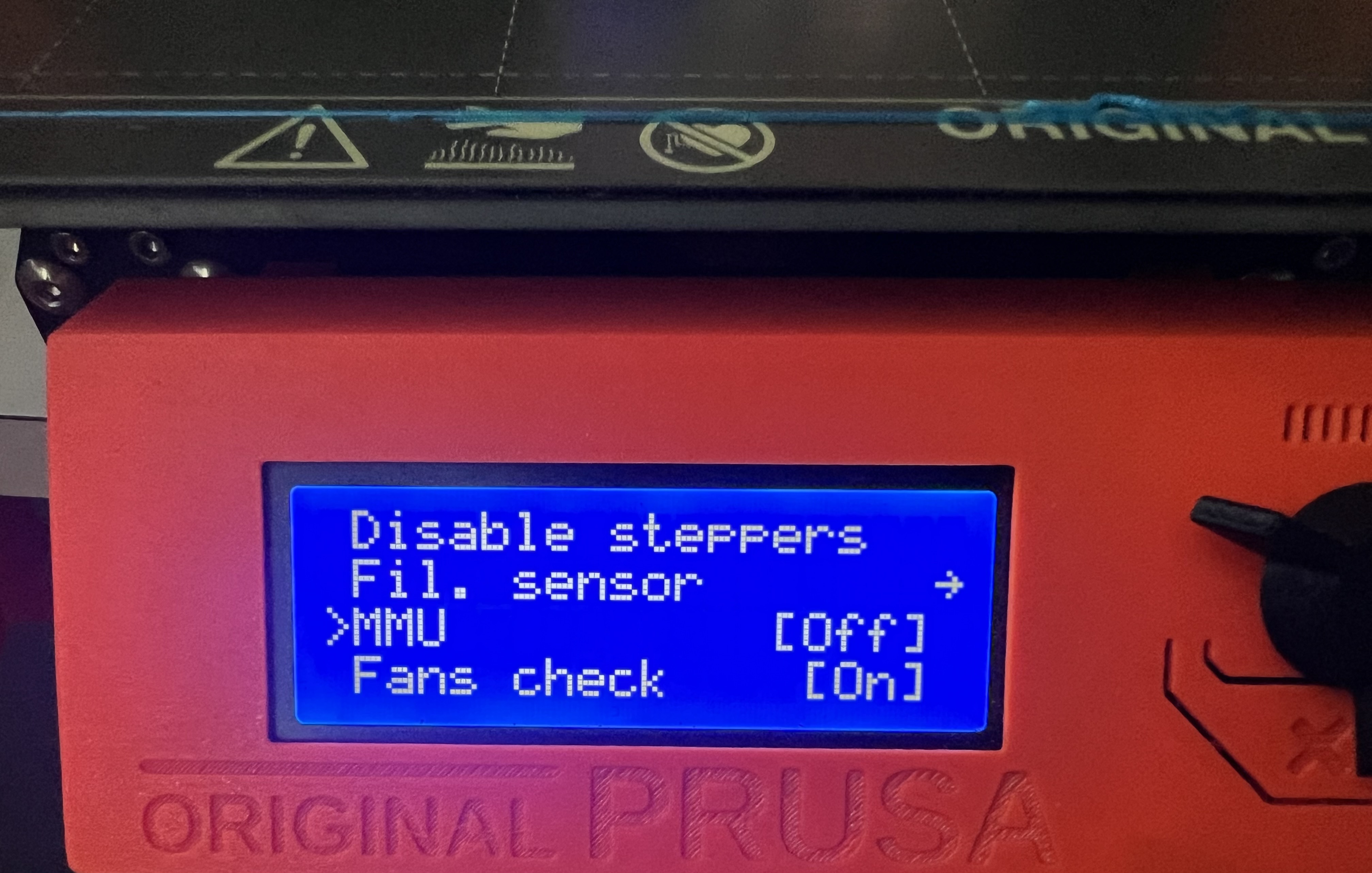

A common problem is people haven’t enabled the MMU in the LCD Settings menu. This is a new setting so the MMU can be disabled anytime, by default the MMU is disabled.

I went through the menu and could not enable the MMU2s.  Which menu option do you enable it through? I went through Settings, Calibrate, Support and was scrolling through. I can't say I went through with a fine tooth comb but I didn't notice any MMU2s enable or Disable option.  I could see it was Disabled in one of the menus.

gudnimg
(@gudnimg)
RE: MMU2s Grinding after upgrade to 3.13.0
It should be under “Settings”. See attached image.
Posted : 24/09/2023 9:05 pm
MikiCab
(@mikicab)
Thanks.  I was in settings and didn't see it.  When I reload the FW I will check again.  I have downgraded to 3.12.2 so I can get some prints done so I cannot do anything for about a week.  I cannot risk bricking my system again.
