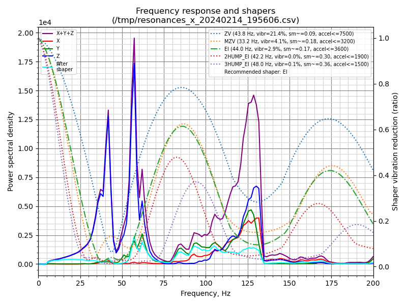

It's nice to see klipper and input shaping being used here. It's an interesting data point but it's probably not that useful for mk3s with stock frames or people with properly tensioned belts. The chart is nice because it tells you where your natural frequencies are. You can see that the axis down at 25 hz might benefit from some stiffening and improve some print quality but largely this data isn't helpful because we don't have input shaping in marlin.... Or slicers.... yet.
This data might be a useful first pass for someone who doesn't have an accelerometer and is willing compromise with using a robust input shaper like 3 hump.

Those data, of course, are anecdotal and I would not recommend using those values for input shaping another printer of the same model.

Just to get an idea of what input shaper does. both the same gcode, 250 mm/s with 6000mm/s^2 acceleration, left without input shaper, on the right with input shaper. This is pretty sketchy for the i3 already though.
And just to get how that looks during printing. Exact the same gcode and machine, just different filament. I had to bin that print as that old PETG was too wet.

I just re-tested my Ender on Klipper last night and the Y axis resonance peak is at 48 hz, so much better that the 35 hz or so of the Prusa. My Ender uses a stock bed and single linear rail instead of rollers.
I wonder how much of it is related to the Prusa y axis stepper mount. That thing flops around like a carp.

Second, the 2 graphs shown in the original post represent the X and Y axes, 1 graph for each. They indicate when the printer vibrates more because the movement of the axis being tested is at a sympathetic frequency. 2 graphs are needed because the axes are tested separately.
Third, the way Input Shaping is done with Klipper is by the use of an accelerometer. Most often, an ADXL345 is used. This is a small, inexpensive circuit board that responds to motion in X, Y, and Z directions.
To test the X axis, the board is mounted to the print head assembly, usually with a screw or 2. A cable is run from the ADXL345 to the Raspberry Pi that is typically used to run Klipper.
To test the Y axis, the board must be attached to the print bed.
Typically, no testing is done in the Z axis direction, mainly because the Z axis moves much slower than X & Y.

Thanks for posting your charts! I've been wondering about the resonance profile of the mk3 for a while. "not exactly impressive" is an understatement - it's basically unusable. Even with the most aggressive shaper there are still residual vibrations and the amount of smoothing is like nothing I've ever seens (and I've looked at a lot of resonance charts)
