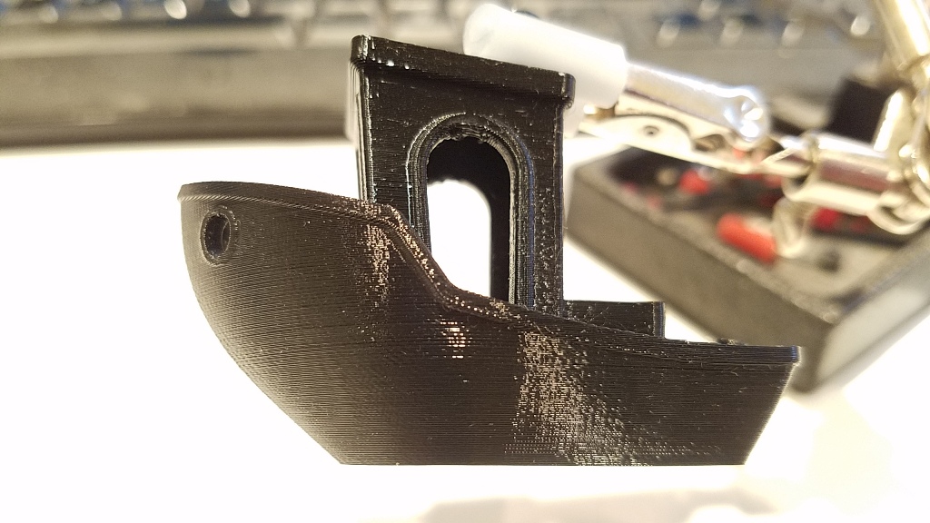

Just off the printer...it’s actually looks worse in the picture than it actually is, it’s definitely an improvement using the LA firmware

Latest benchy, bed time now! Looks LOADS better

Whoever had the idea of the deck infill causing this was correct. I knew it started at the deck layers and was related, but I hadn't considered it might be outward pressure from the infill. Check these two out:
The only settings difference between these two is the top partial benchy was sliced with 0 top layers, effectively disabling the deck infill for this test. Once I saw it was fixed I stopped the print. I don't have time to test tonight and maybe not tomorrow night, can you guys experiment with the Print Settings > Advanced > Infill/perimeters overlap setting? I am wondering if it is pushing these layers outward because things haven't cooled enough, maybe dropping this back 1% at a time until the issue goes away, then test if we're still getting good top layer coverage with no holes?
This one seems pretty important if you ask me. This is probably affecting dimensional accuracy in a way that isn't easily figured out.

I had a feeling it was to do with that after watching the printer do its thing, your LA Firmware really helped the problem so thanks for doing that a sharing it, printing at speeds creates such a pressure in the nozzle and when it slows down to turn onto the next run the plastic has no where to go except up which effects the next layers perimeters causing the problem. I'm assuming it does happen with infill also but doesn't cause an issue due to the extra space inside the model.
