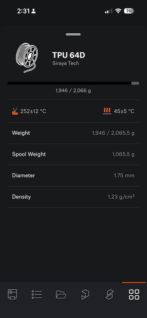

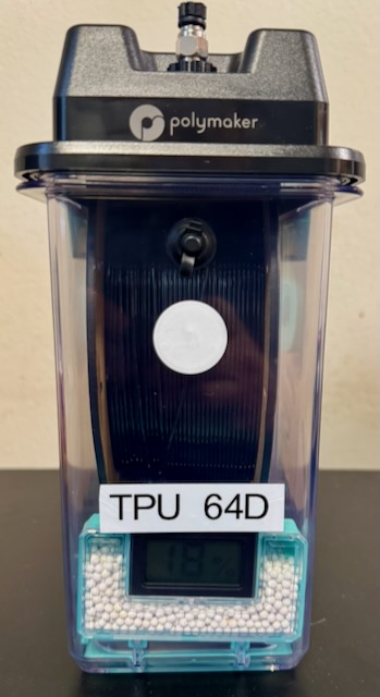

I attach these iCode SLIX2 Sticker Label which are 25mm in diameter to the outside of my dry boxes. For iOS (don't know about Android) I first use NFC Tools to format the tag and then NFC.Cool to generate the OpenPrintTag record for 3rd party spools and then save it to the tag. For Prusa Spools, I use the Prusa App to scan the QR Code and then I write the record to the tag using the Prusa App. Then I read it back using NFC.Cool so I can edit the container weight (to change it from just the spool weight to the box weight plus spool). When generating a record I use the dry box and spool weight for the "container weight" and the container and spool weight plus the filament weight (for a new spool) as the "nominal weight". I then weigh the filament in the box to get the remaining amount of filament.
So far this is still in it's infancy. If I have time (which I don't really) I would think about designing an app that allows me to scan my filaments into a database that can be exported to a spreadsheet.

The answer to all of those questions is currently "Nope". There is zero integration with the slicer. I have a bunch of these tags so I'm starting to put them into use. Even if right now it doesn't really offer much.
Once the tag is formatted and has the filament data stored on it the work flow is:
  1. Read the tag
  2. Weigh the box
  3. Update the weight
  4. Write the tag

So that is aPolyDryer?   $80 for box and dryer or $30 for the box.
Yes, but I don't use the PolyDryer (it sucks) I only use the boxes for storage. I got a decent discount on them ($20 each) so I bought a lot. Most people are happy just using dry cereal boxes and modding them to add rollers and desiccant boxes.

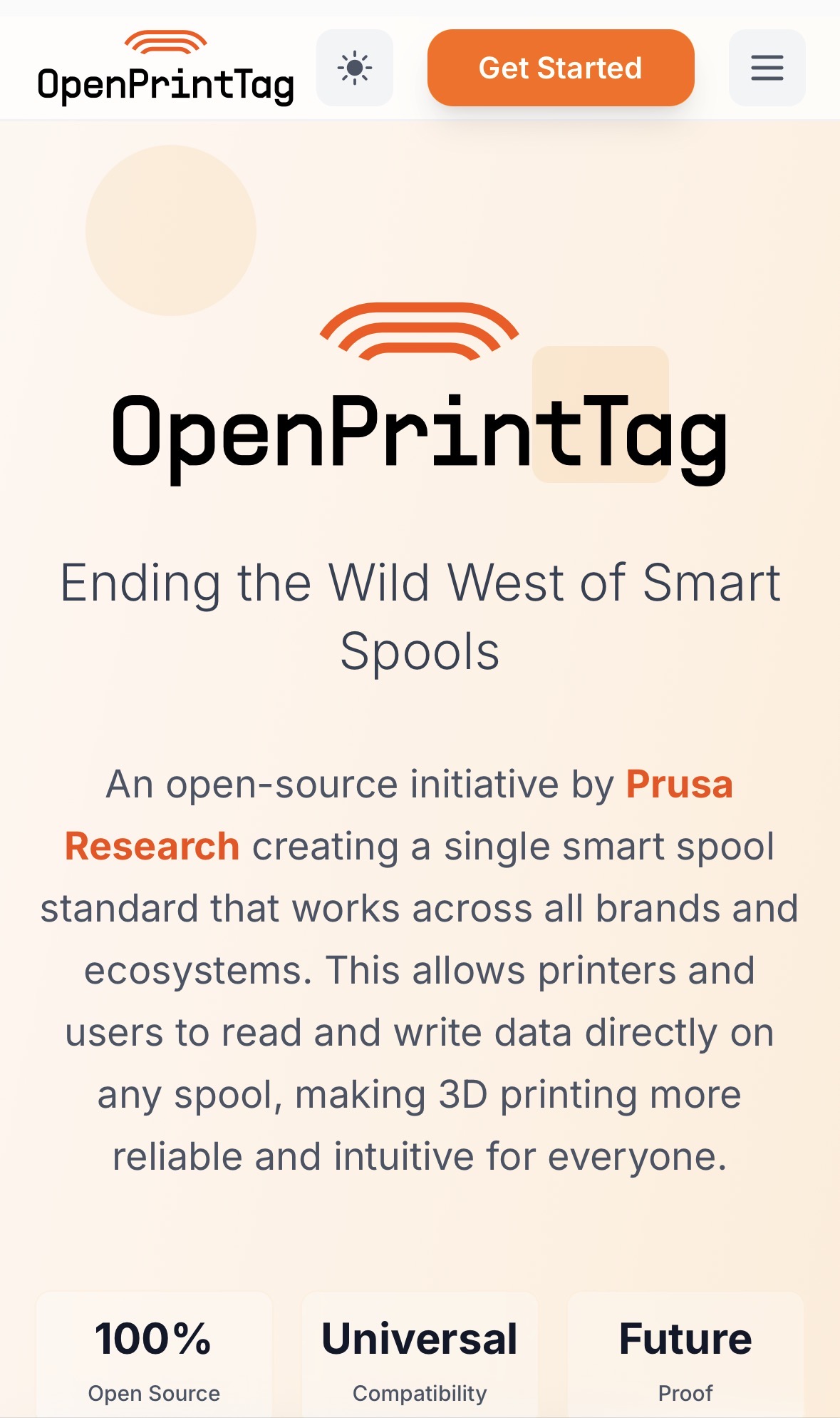

So there is anOpenTag web site. Nice
