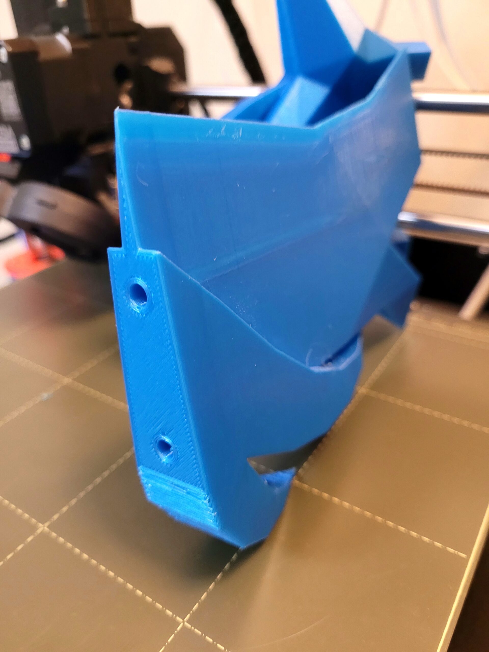

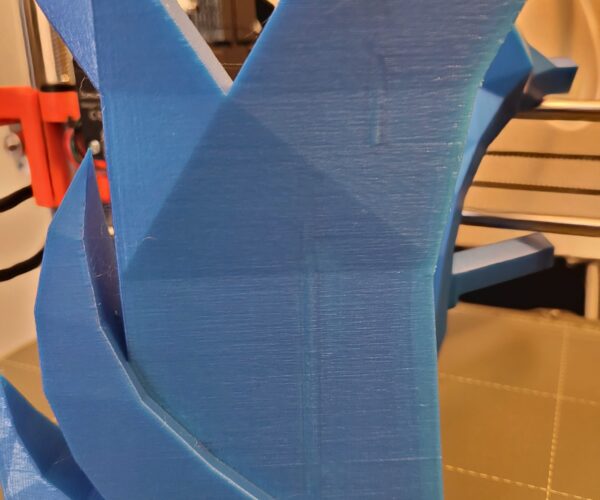

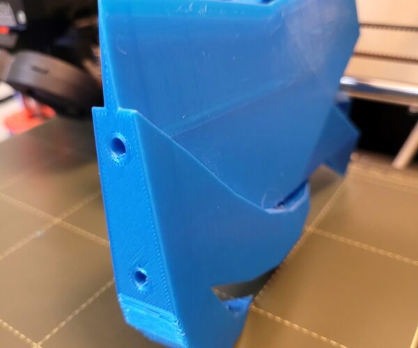

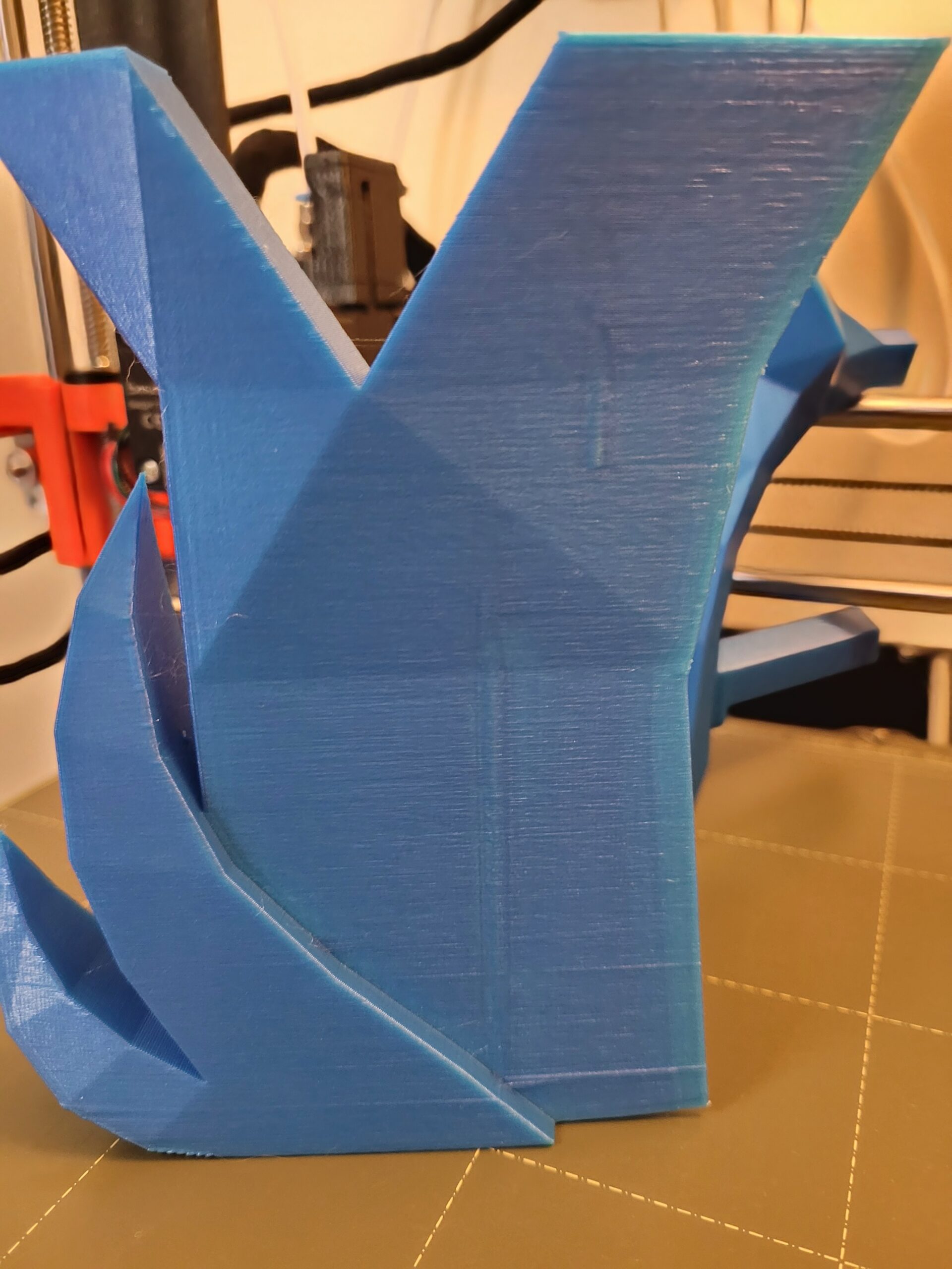

ENHANCE_BLUR ENHANCE_BLURHello,
I am hoping someone can help me out here.
As you can see in the picture, There is a printed hole in my part and it is noticeable through the walls on my print.
I tried to increase the perimeter from 2-3 but it also increases the perimeters in the hole. so it doesn't fix the problem.
Thanks for the help

Seam?
That could be a seam that just happens to be aligned with the hole. If so, you can control where the seam lands. See https://help.prusa3d.com/en/article/seam-position_151069
Also you can see where the seam will be from the preview by selecting it from the dropdown menus at the bottom of the preview view in slicer.

You can use a modifier to limit the area where extra perimeters are required or to set external perimeters first.   Better would be, if possible, to move the hole position so the perimeters don't interact.

I understand, that said the only thing that I can see that might be causing your issue is what looks to be gap file. I have a limited view of the area that I'm basing my assessment on, however try turning Gap fill off and run a test of the are in question and see if it improves your result.
