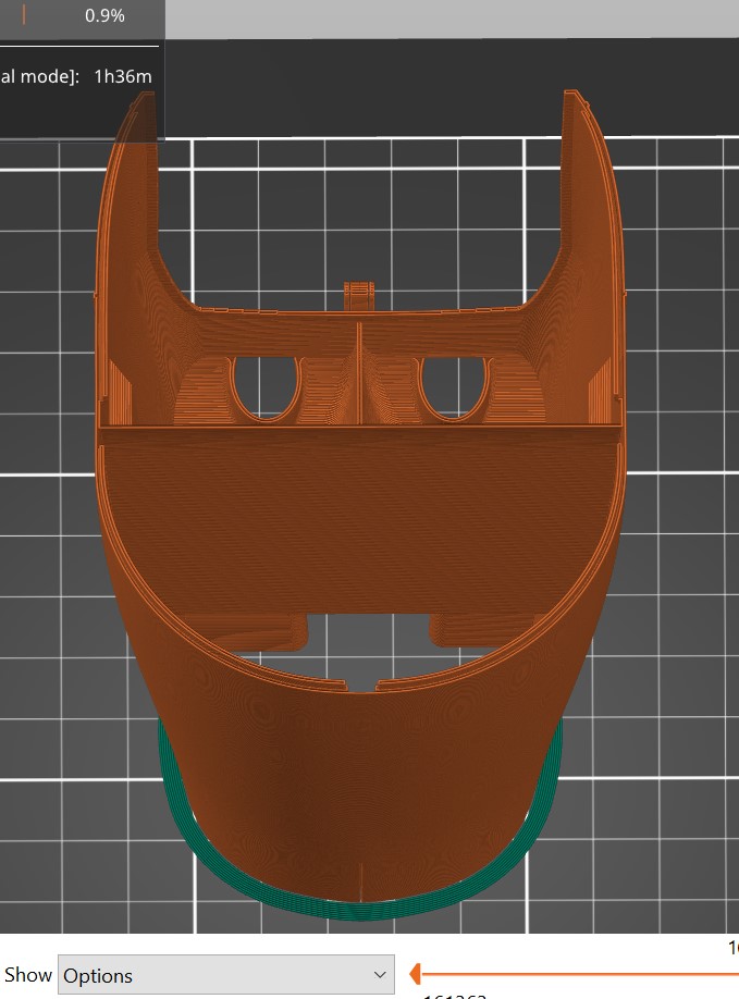

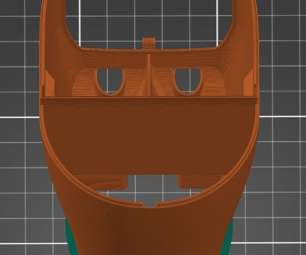

So for starters, I've printed quite a few RC planes already. I've printed both the planes from 3Dlabprint as well as those from eclipson. I've had great success with both. There is a new plane that was released in the last few weeks by a site called planeprint. After talking with the designer they insisted that due to the way the plane was designed, it can only be sliced in cura as there is a surface setting in cura that doesn't exist in any other slicer. I tried slicing the parts in simplify3D and also Prusaslicer and sure enough, I can't figure it out. Would love to slice these in Prusaslicer and was wondering if anyone had any ideas. Attached is what the file looks like when imported and also when sliced. once sliced, all the internal structure is gone. I was told this is due to it being single wall thickness structure and the slicer doesn't understand that. Anyone far smarter than me have an idea on how to slice this with the PrusaSlicer?

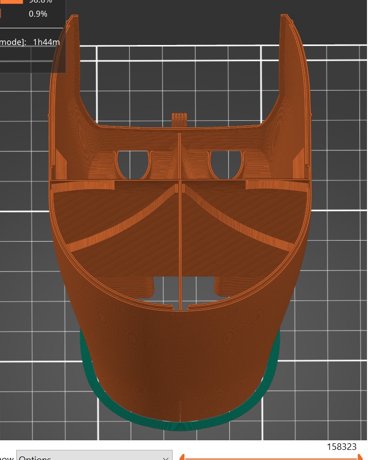

I have just finished printing the Icon A5 from Planeprint.com and it came in at a relatively lightweight 427gms all up for the print job. This is about half the weight of a similarly sized 3DLabPrint plane. Weight is everything in this hobby and we are continually looking for either lighter materials or methods of design/slice/print that yield lighter results. The real problem for me in using Cura, is that it has a nasty habit of inserting ridiculous numbers of travel moves that do nothing other than deposit a zit on the surface of the part. Worse still, these travel moves also result in the restart prime plastic being used up, which causes under-extrusion at the start of the layer. Specifying X,Y starting co-ordinates in a central position in the part can reduce the travel moves somewhat, but especially with complex parts, it doesn't eliminate them.
Most parts on the Icon A5 printed nicely on my Prusa Mk3S, but Engine pod 2 was terrible. It would be really nice if Prusaslicer could do the same as Cura in printing these single width internal structures, but do so without the unnecessary travel moves! Here is an example of the problem in engine pod 2.

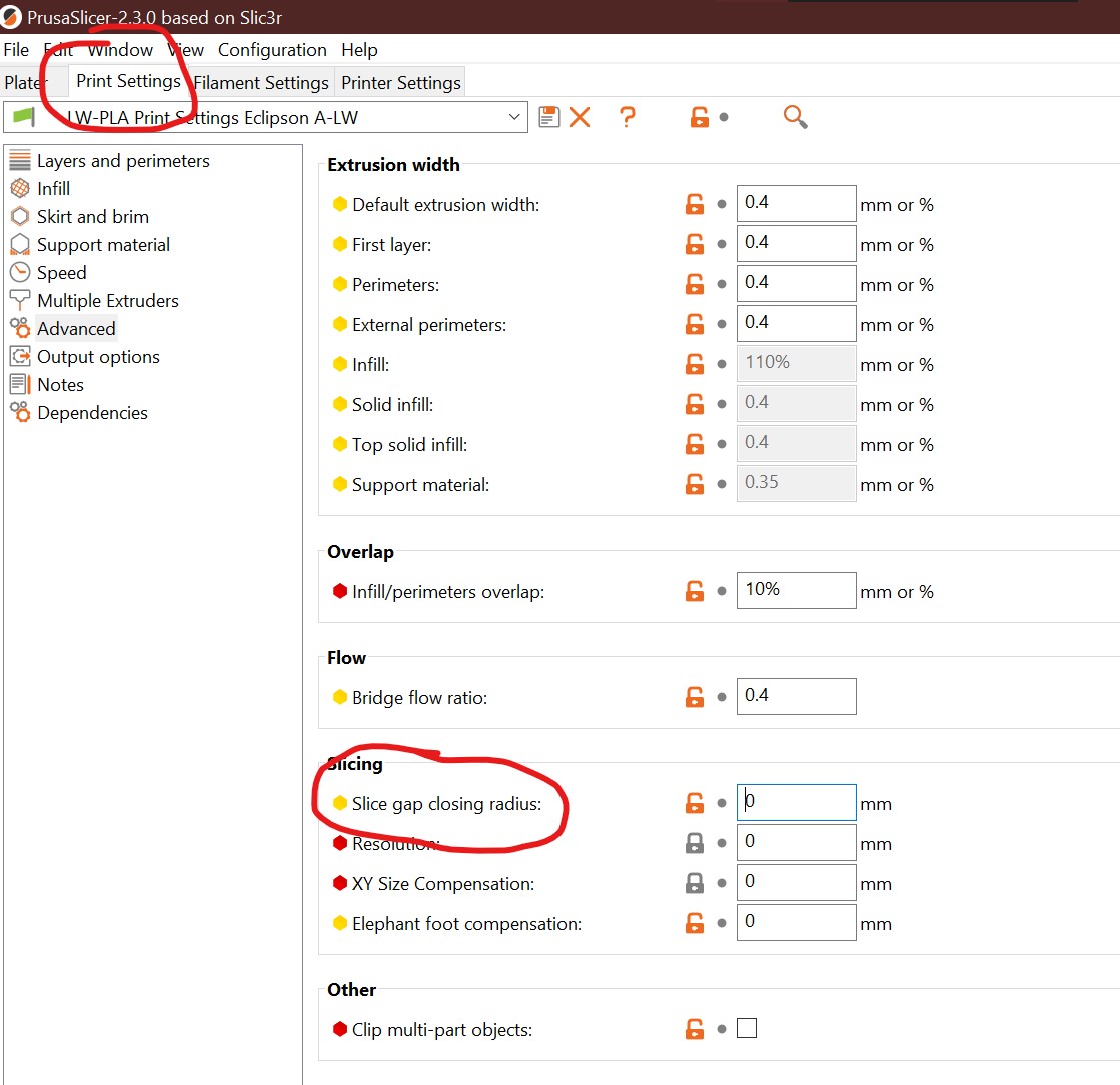

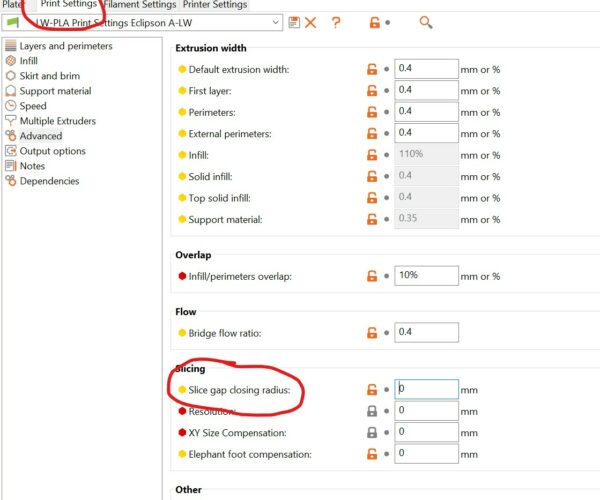

Then I found the "Print Settings" -> "Advanced" -> "Slice gap closing radius" [default 0.049] and set it to "0". This seems to work and I printed some parts which look exaclty like the presliced gcode Files I can check in the Prusa G-Code Viewer. However some parts will print even with this setting a tiny bit different so sometimes I went from "0" to "0.004" for example. It's important to preview the sliced model and compare it to the presliced files.

@crick The setting your looking for is "Slice gap closing radius:" in the print settings.
How to find the setting in Prusa Slicer 0.049 Gab Close Radius 0.000 Gap Close Radius
Posted : 27/05/2021 7:32 pm

@troggy
I wrote down the option with the "slice gap" above. So I printed the files already. Since you are a new member I think you are from Eclipson Planes. However it would be nice, if this info would be shown at your print instructions.
