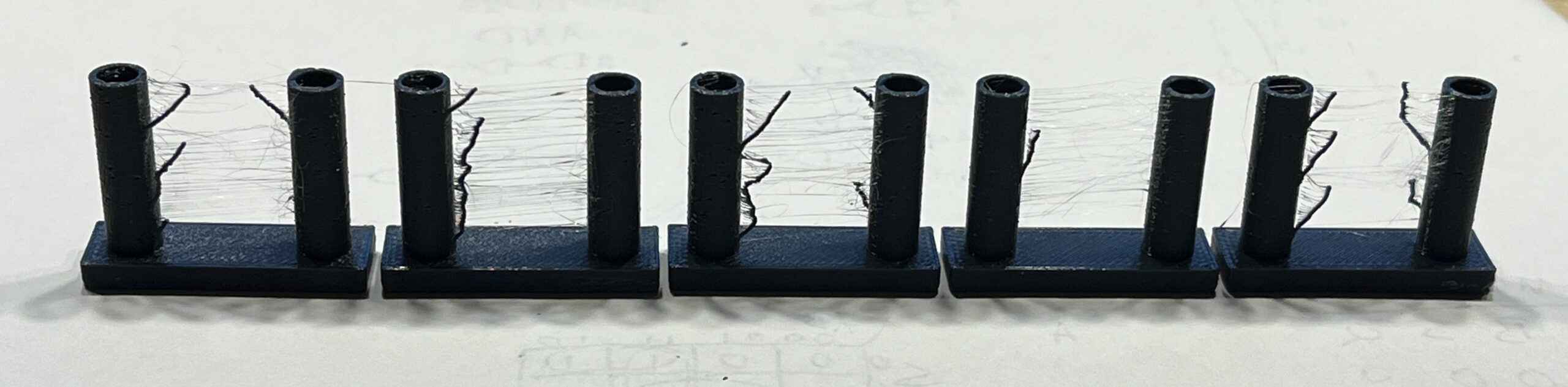

Hi!  I decided to open up a brand new spool of  prusa petg for an upcoming project, but my test prints have been very stringy.  I’ve tried changing a few settings, but don’t see much of a difference.
 from left to right…
1. All default settings (0.8mm retraction length, 250C hotend temp, 35mm/s retract speed)
2. 1.0mm retract length
 3. 1.5mm retract length
 4. 240C hotend temp
 5. 70mm/s retract speed
printer is MK3S kit, filament is prusament petg anthracite grey.
Can anyone suggest some other settings to try changing? Something that has worked for you maybe?
 Thanks in advance!

I print most of my PETG (not Prusa) at between 220-230 .. try a big change like 225 and see what happens. You don't want it so cool it has no strength, but one variable to try.

Try drying it before anything else.  Just because it is new doesn't mean it hasn't taken up moisture (either before or after being packaged).

I wouldn't think that moisture is an issue in this case because the spool was in a sealed bag with a beefy desiccant pack.  I also live in a relatively dry climate (it's currently 10%RH indoors)

Printing at 225C seemed to do the trick. I wonder why this flavor of petg has a recommended nozzle temp of 250C +/- 10C.
The test part's strength seems to be acceptable as well.

All the manufacturers try hard but you have no idea how long it was stored in the warehouse or how it was treated in transit ... a deck stacked container at sea can rise and fall by 30°C daily alternately sucking in and blowing out moist sea air...  you get the idea.
Always suspect dampness first when stringing occurs, your first picture looks typical.
