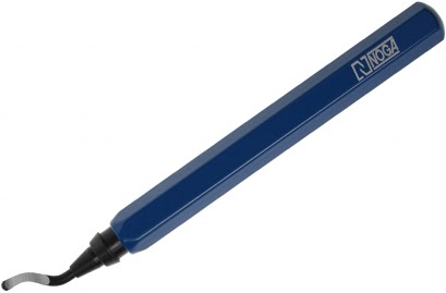

RE: Remove the small edge of the first layer
Elephants foot Compensation,settings in prusa slicer.
But also first layer to low,
bed to hot.
If you want to know how to remove it after printing, use a Ontbramers voor de kunststof industrie - Industriemespunt.nl
deburring tool
