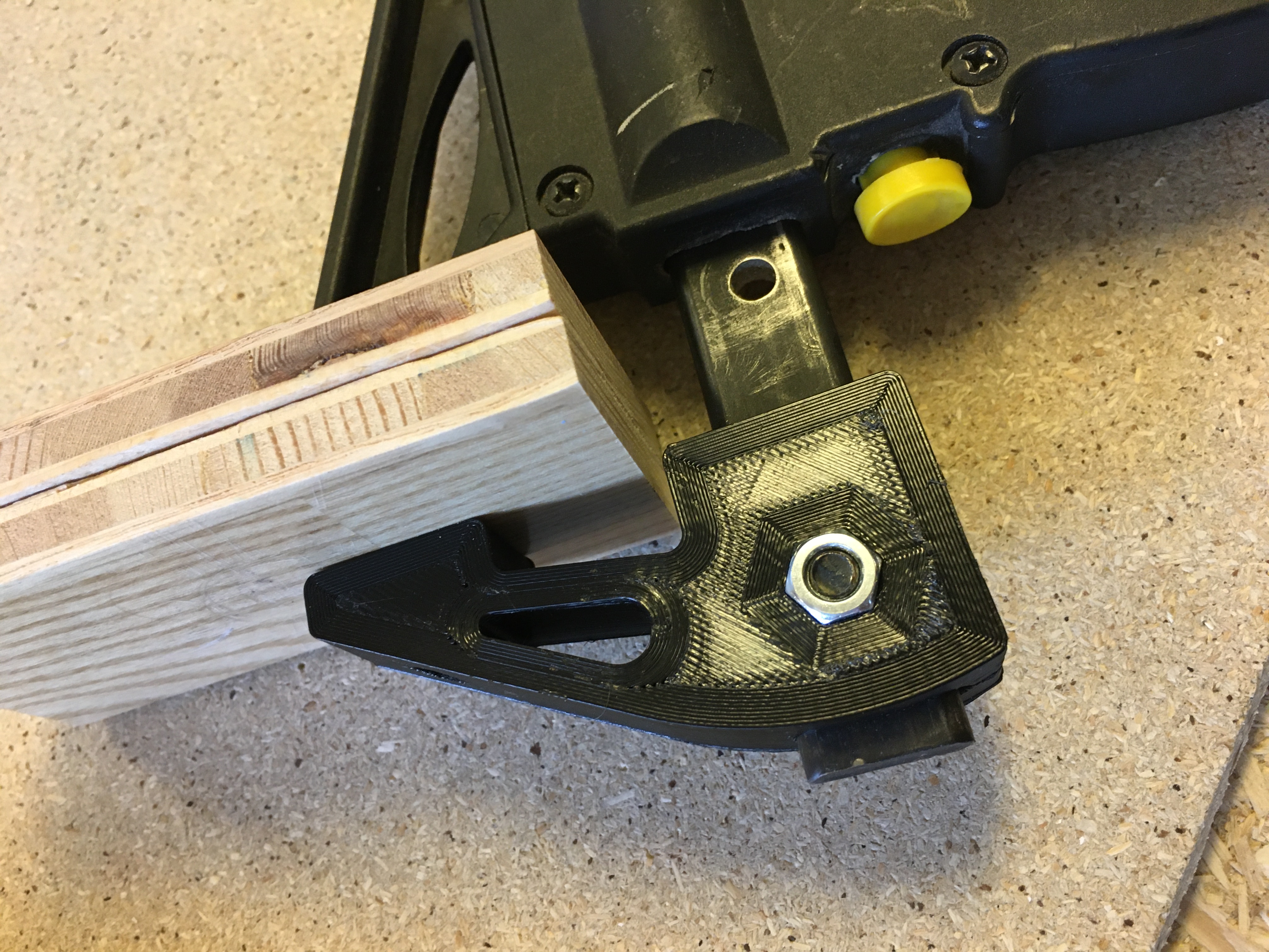

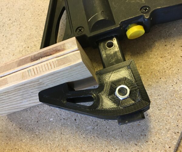

I run AddNorth at 245 - 245 (First layer - Other layers) on a Prusa I3, Bed at 90. Thats the settings I have settled at. I usually get good prints with AddNorth except for first layer issues, but after learning that regular cleaning with soap and water is preferred after PETG prints I have not had any first layer issues.
Regarding strength, trade perimeters for infill. Perimeters provide much better strength than infill. Here is an example of a strong part printed with AddNorth PETG. The part can bear the full load from the quick clamp
