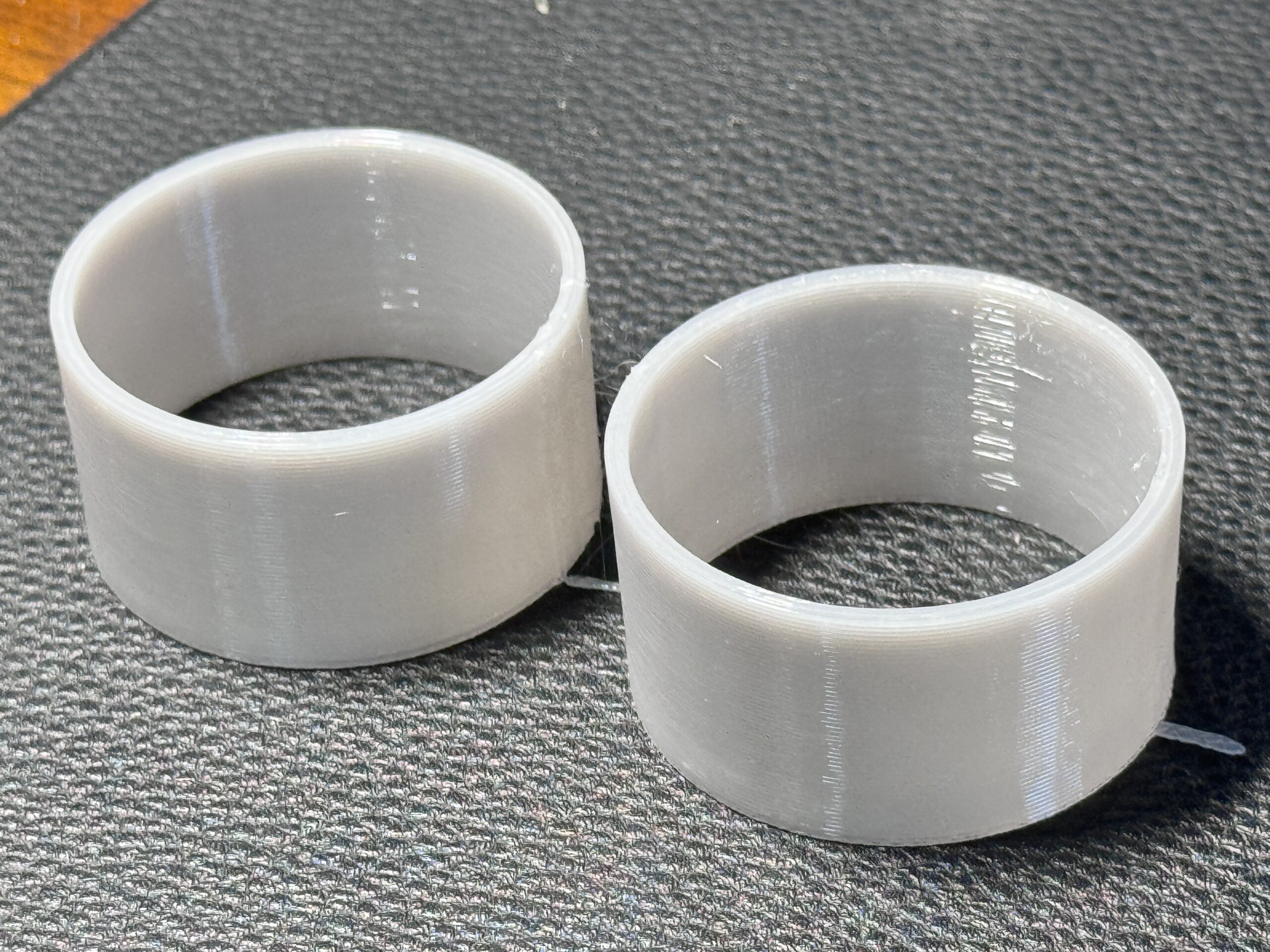

I'm having trouble printing anything very well with a 0.8mm nozzle (mk3s).  Even with PLA, I get unacceptable gaps on curved perimeters where they close -- it's as if the extrusion stopped or the nozzle moved a mm or so before the end of the line.  Can someone who is using a 0.8mm nozzle print the attached stl and let me know what they think of the results?
Basically two short cylinders, 1.71mm walls.  The left one is a straight cylinder, the right one is actually a conic section that expands slightly as it goes up.
Assuming you're satisfied with your results, I'd appreciate it if you could post the .3mf for the print so I could see the parameters you are using.  I've tried decreasing perimeter acceleration to 100, turning off the fan, slowing print speed down to 15mm/s, and turning off retraction, and nothing gets the gaps filled in.  It's as if the circle algorithms are off.
Thanks.

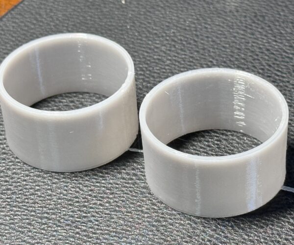

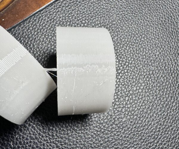

One of my Mk3S+ is permanently equipped with a 0.8mm nozzle, printing a particular model at 0.5mm layer height all the time. The seams are a bit more visible than with a smaller nozzle but not too bad to keep me from selling those models. Alas, this weekend I converted my last Mk3S to a Mk3.5 but I printed your model on it anyway, given that the hotend hasn't changed at all. Here a couple of photos. Looks excellent to me.
The 3mf file I used is attached
