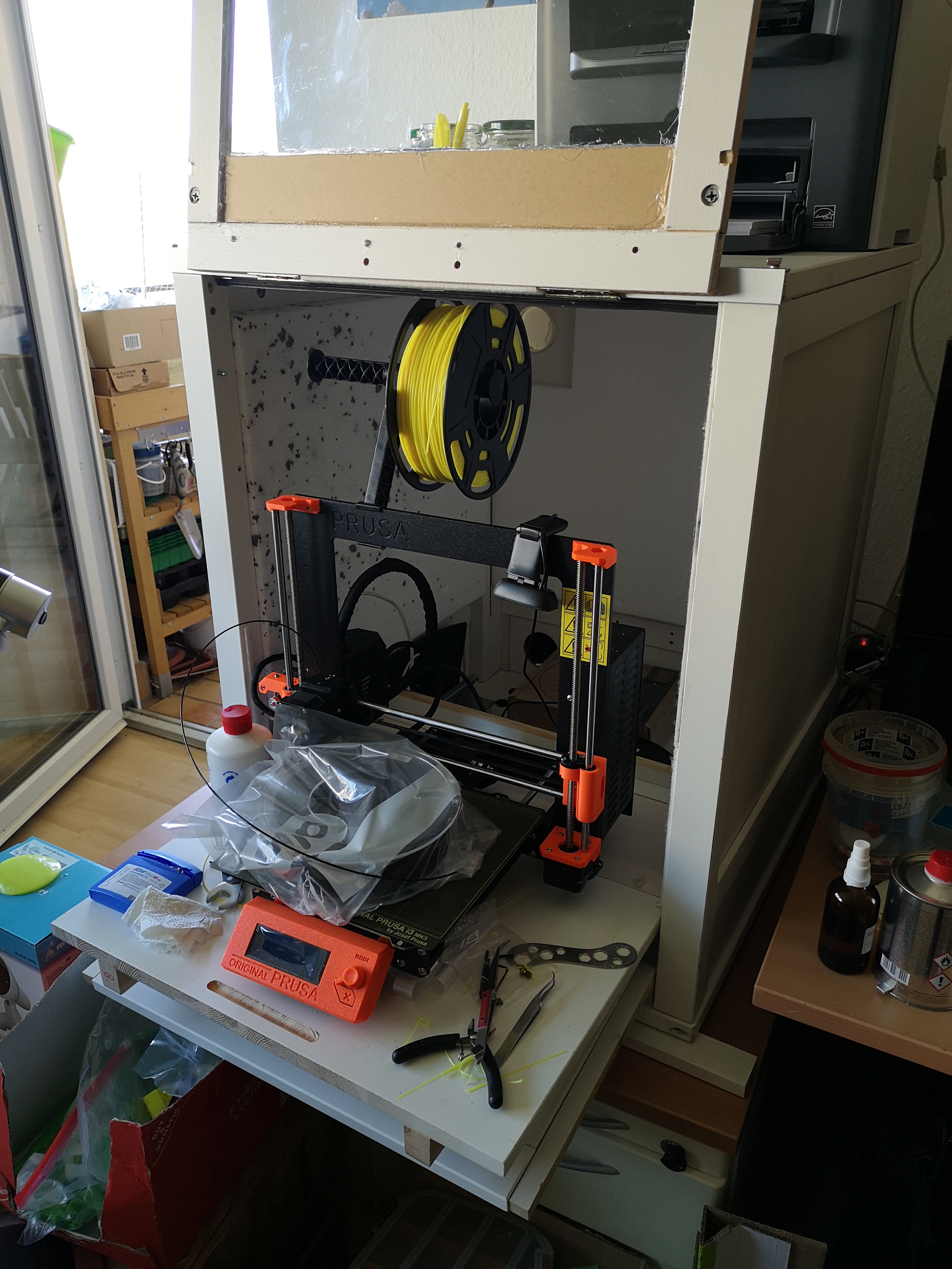

towlerg
(@towlerg)
RE: How to Print with PP? Tape doesn't stick
@manum
"Overengineered housing" not at all, I realy like the idea of putting the printer on slide rails. Do you find it makes more noise?
Posted : 21/04/2020 1:26 pm
Manu M
(@manu-m)
I hardly concerned about it, but with the dampers it is no problem but I didnt tested it without.
It a very usefull case. It's stable so you cut put somethin else on top of it, it comes with 2 doors one upper and a lower one and under the plattform for the printer, it is possible to store 3-4 spools of filament. I should really show this projekt, it is to 95% made from a Ikea writing desk which I found for free in the trash.
