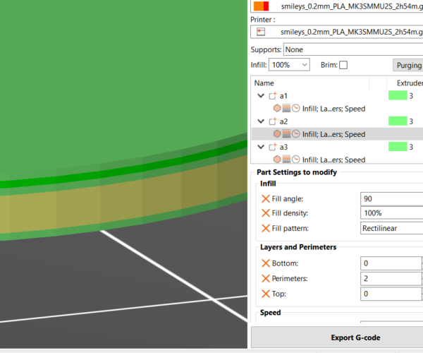

Hi everyone.
If it is for a test or experiment ... You can do it by placing two or more stacked pieces without TOP LAYER or BOTTOM LAYER, and altering the INFILL angle by 90 ° in the midle layer ...
Here you can see the result, 3 layers of 0.2mm of natural PLA on a yellow and black base ... The three layers have the INFILL aligned and the lines that I presume is air trapped between the tracks.

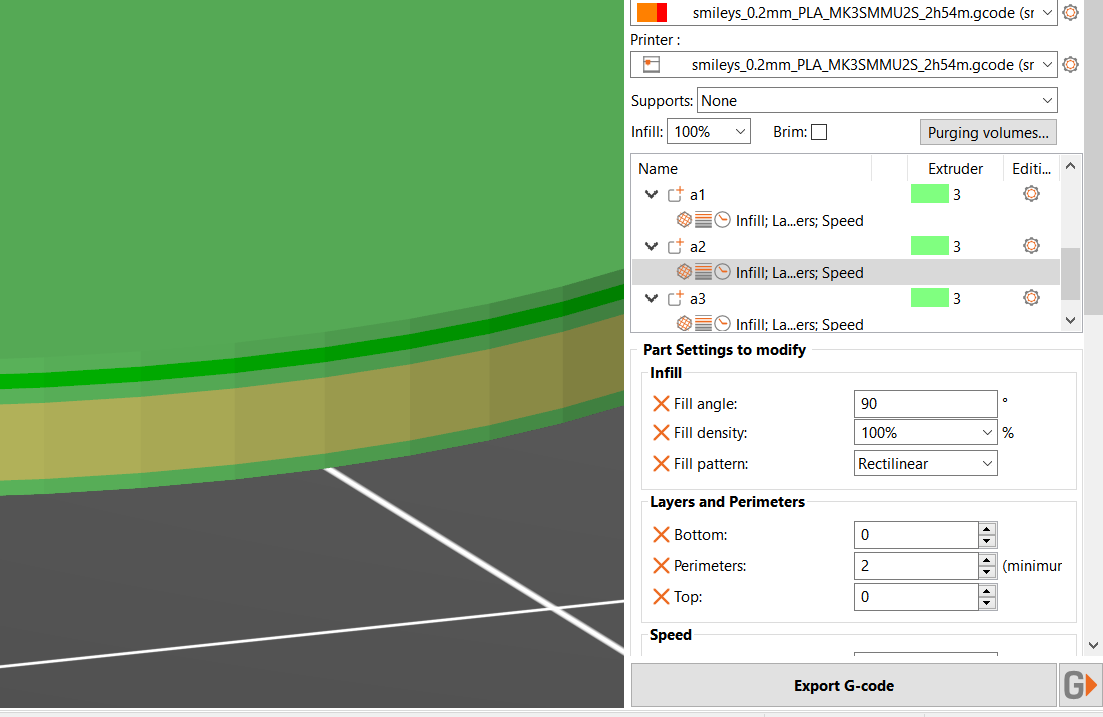

Hello good people:) There is a way to do this, though a little hackie, using the height-range modifier. mrodriguez was onto something. I have attached a 3mf-file (had to zip it) showing what I mean. Here I have created a modifier for each of the first solid layers. I then Add settings --Infill and tick Infill angle. The angle will automatically alternate for each layer, so I set the value to 180 and 90 for every other layer to prevent this.
This will do what you need it to do without too much trouble. Admittedly, a bit of work, but aren't too many solid layers with transparent things anyhow and once done you can load any new model into this scene without changing the modifiers.

If all you want is a simple all infill printed in the same direction then set top and bottom layers to zero and then choose Aligned Rectilinear as the infill pattern with 100% density.  That does it without having to use any height range modifiers.
