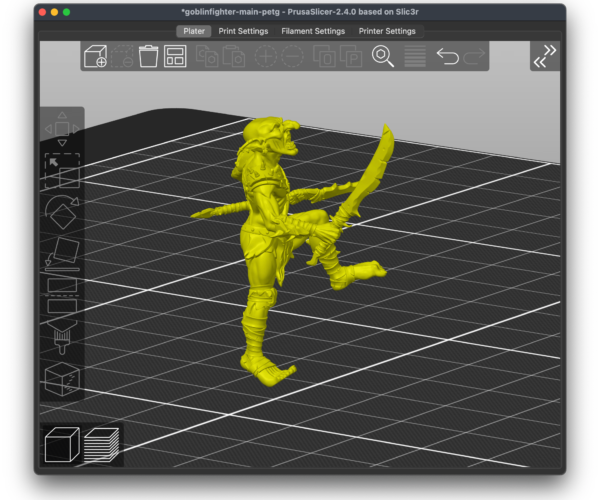

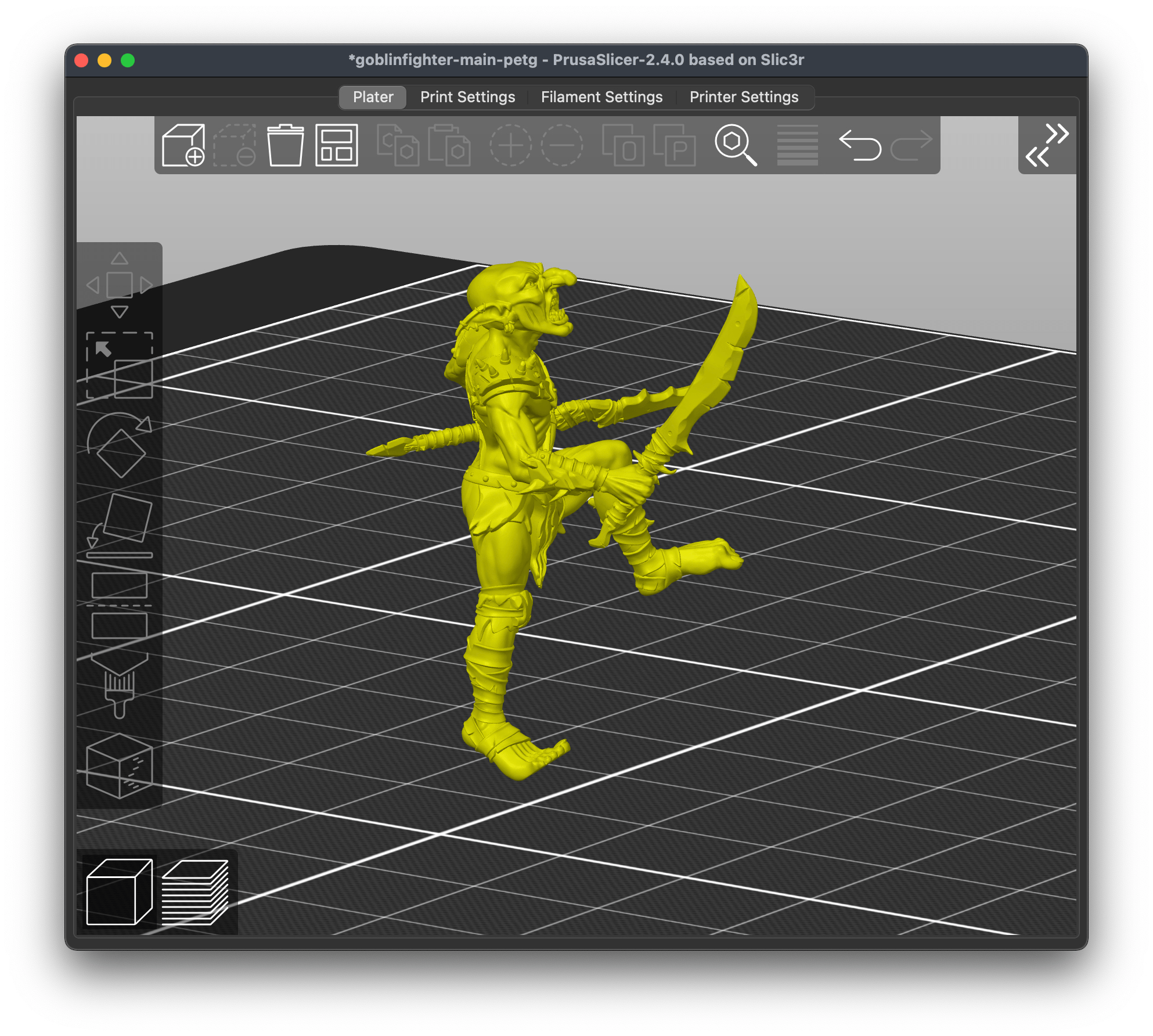

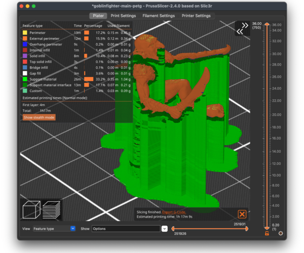

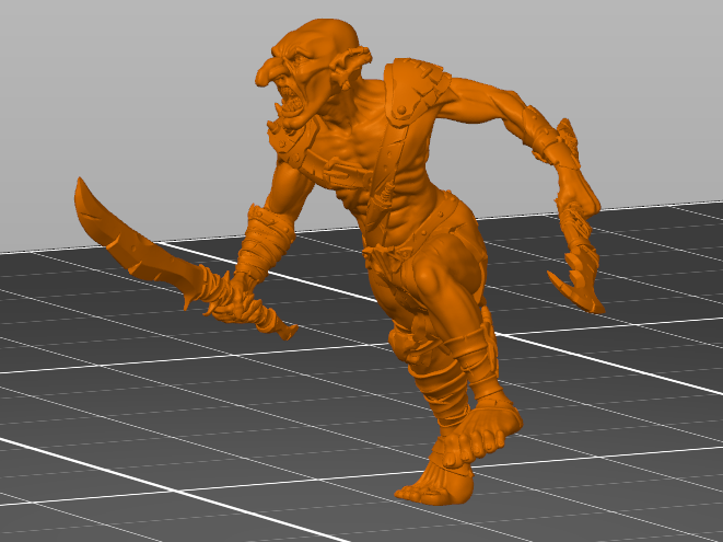

Howdy all!
I'm brand new to 3d printing and have been trying to start with some figurines.
Starting with goblins! I (somehow) got a goblin archer to come out halfway decent, but am now trying a goblin fighter I found online.
No matter what I do he is just coming out awful, usually due to supports being in bad places with really thin features, so if a support is there it just rips him apart.
I've tried customizing the paint on supports but quite frankly just cannot get it right.
Attached is the project, and I've removed everything but just the model. Does anyone have any idea's on how I can get this little guy to come out well?
Thanks so much for any help!
goblinfighter-main-petg

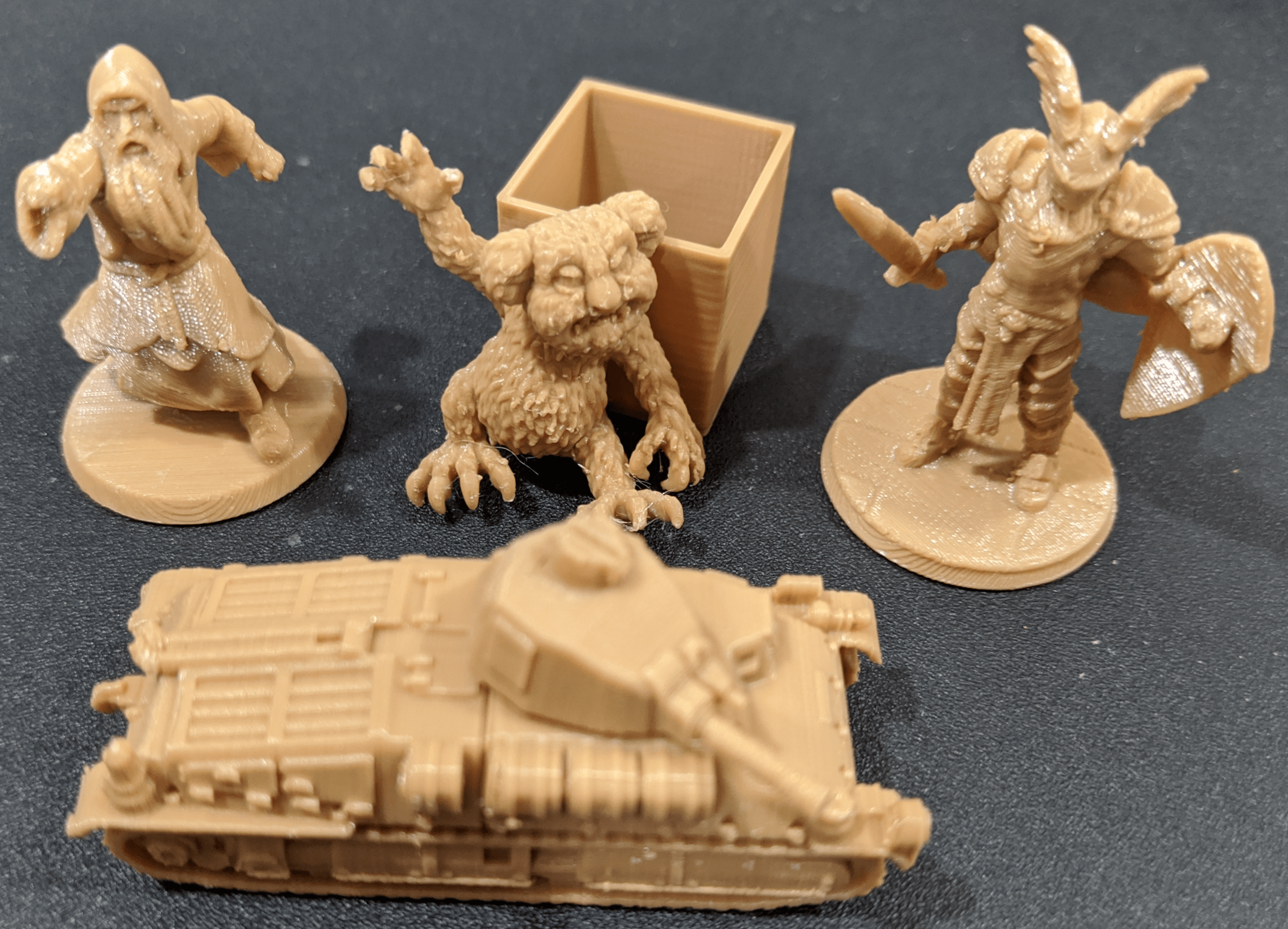

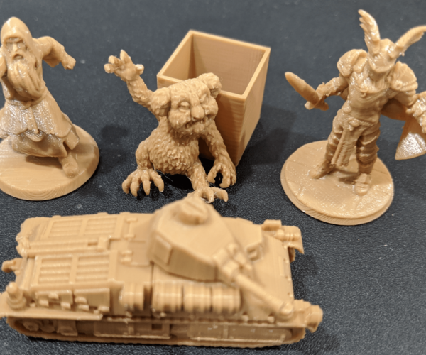

Miniatures are going to be tough with a FFF (filament) printer. You can get results that are decent enough -- particularly compared to the metal figures we played with 10 years ago -- but nowhere near resin quality. Plenty good enough for my "table top at 3 feet" standard. They look horrid blown up 400% in these pictures, but fine at normal distances.
You're definitely going to need removable supports for that sort of figure. Anything hanging out that is not attached to the base (raised foot, arms and weapons) needs support. I've had the best luck with these settings for removable supports for printing miniatures on my Mk3:
  • Contact Z distance: 0.25mm
  • Pattern spacing: 3mm
  • Interface layers: 4
  • Interface pattern spacing: 0.2mm
  • Interface loops: Off
  • XY separation: 75%
  • Don't support bridges: On
  • Try snug supports. If they're too weak, use normal grid supports.
For this print, I'd use:
  • 0.25mm nozzle
  • 0.1mm layer height
  • PLA filament

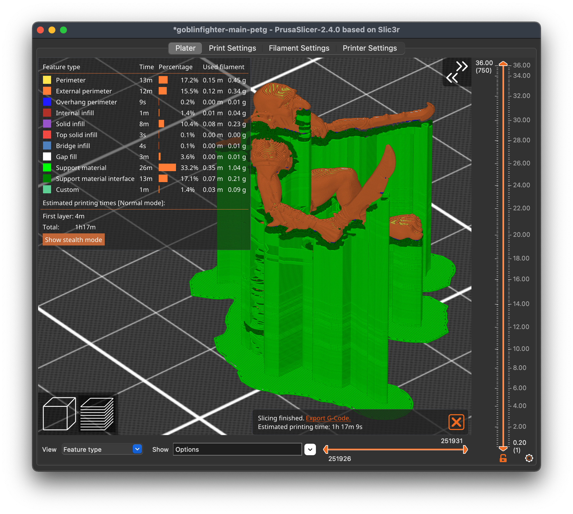

I also find it helpful to reorient miniatures to minimize the need for supports. Tilting the model on its back 45º often helps. You want those parts that stick out as vertical as possible, though that may be difficult with as many floating limbs as you have on your goblin. Here's the orientation I'd try:
These supports should be relatively easy to remove with a bit of care:
Don't expect to peel all the supports off in one "satisfying" move. Use clippers to break the support apart to reduce strength before removing. Remove supports from the strongest areas first, preserving the strength of the weak details until you have them isolated. You don't want to be pulling or twisting around those fragile bits.
As @sylviatrilling notes, a resin printer is going to produce much better quality miniature prints. However, if you don't have one and don't want one (as in my case), FFF prints are plenty good enough for casual gaming.

Postpone that model for a while, several years at least...
The designer got carried away with the details and forgot that someone might try and print it...
There are a couple of people on here who might be able to print it; I wouldn't attempt to.  The best chance would be to use a multimaterial approach and make the supports in soluble filament.
The problem?   That figure has many points where it is unsupported, where you would effectively be laying plastic on thin air, and more where the overhangs are way steeper than 45 degrees so liable to sag away as they are laid down.  This is beyond ordinary support structures.
@sylviatrilling is right, there's not much point in going finer than 0.15mm layers for this sort of thing.
And then look for models which have more than one successful print and no counter indications in the coments, preferably ones that don't need support.

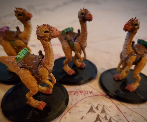

I may be a bit late to the party, but I went head in on miniature printing and feel I have gotten great results with FDM. Once you prime and paint the 50 micron lines (0.05 layer height) are pretty much un-seeable unless you are taking a super zoomed in photo or staring at it up close. I print almost always at 0.05 and with my trusty 0.25 nozzle. I find the details worthwhile and have never had a clog (with PLA). The prints take forever, but meh.. that's just time... (Ignore the fact that I have a printer schedule posted near my desk to ensure I have time to print what I want for game...) Anyway, I have a sensitivity to resin (past work with resins) so maybe I'm biased, but I guess I just add all this to say, don't ever feel pressured to go resin unless you want to. Great miniatures can happen (and do happen) in FDM.... regardless!
I can say I spend probably as much time in prep as I do in print. You can do a lot of great things in blender to reduce or even remove the need for a lot of complicated supports. After a while of printing you learn what details matter and which ones don't (and which ones look great conceptually, but will break as soon as anyone touches your print). For context (as a personal challenge) I print a lot from Hero Forge. The models look classy (and I love my prints) but they require a great deal of prep to fill in unnecessary and un-seeable overhangs and pockets that you don't see at the table. I also take the time to scale up some of the narrow tiny bits to make them stronger. When designing my own models, I try to pay special attention to unnecessary overhangs. All that is to say, blender is a great friend to anyone printing miniatures. I'm glad I took the time to learn it.
Another consideration, when it comes to supports, I use a mix of Prusa slicers SLA 'tree' supports' and FDM supports depending on the model. I find that for tiny bits pointing downward, tree supports are a big assist. The FDM supports are not enough as the tiny downward bits just tend to wobble about in the support cavity.  I also make my tree supports very narrow (1mm) and limit them to only those areas. However, depending on how the tree supports are generated, I paint supports on them.
Another consideration... when I first started printing I printed off bases since I figured I could just glue them later. I found that approach to be a pain in the butt, so I now attach slotted bases to all my prints and then print slotted bases. I find these much easier to print, support, and paint.
For context, here is a group of prints I did over the past week. Can you see the print lines? Probably not? Can you tell they were printed by an armature? Oh yes...
Good luck as you start your printing adventures. 🙂
