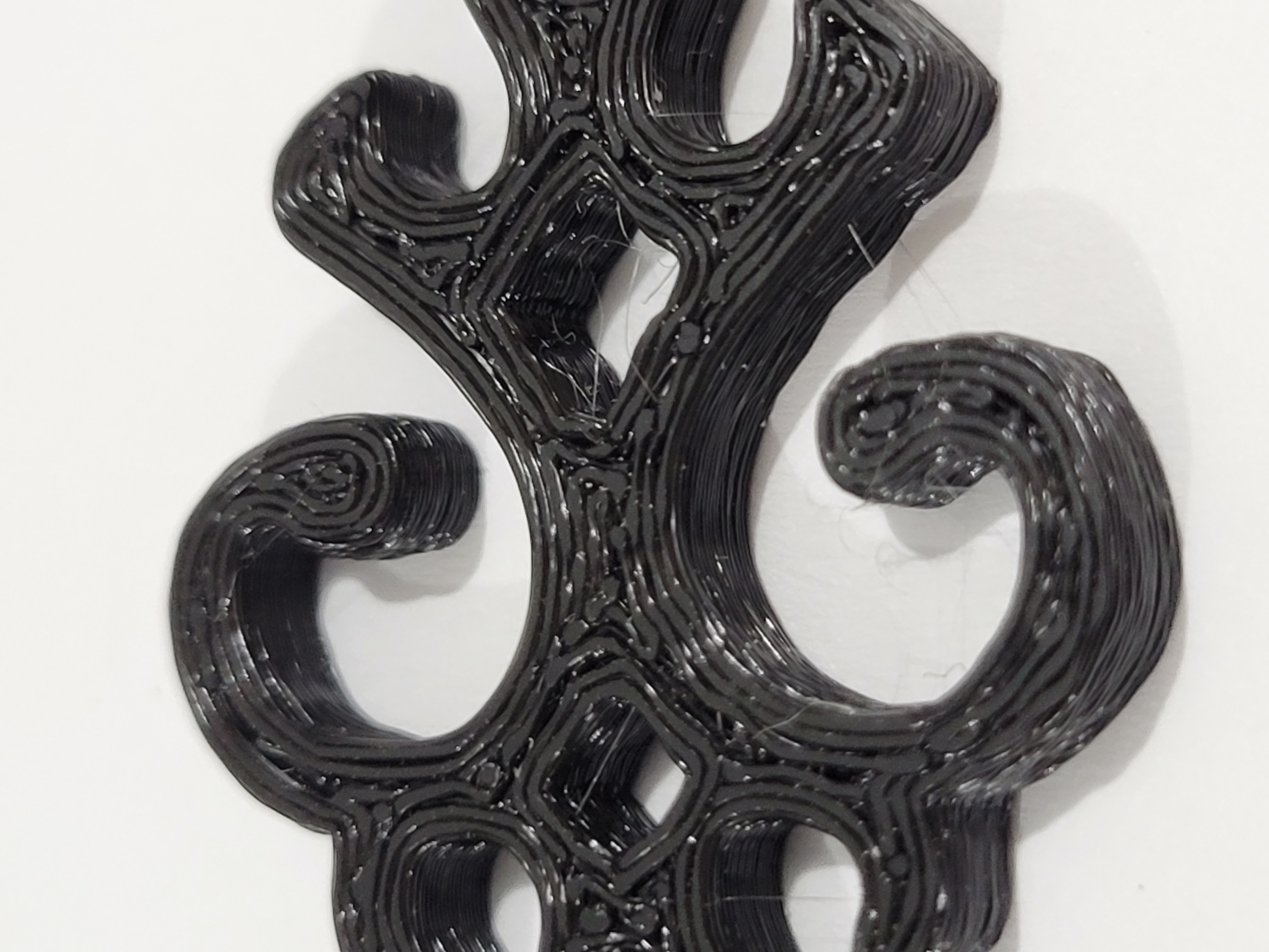

Bad flat bottom
This is the bottom partThis the bottom side. Can you guys give me any advice to solve this problem.
My printer is a prusa mk3s+ Thanks.

RE: Bad flat bottom
@dominicarte
Lower your Live Z, it's currently to high.

RE: Bad flat bottom
If that was printed directly onto a build plate, I would say that the Extruder is too high above the build plate.
I use the
'Life Adjust 'Z' My Way' Process
the test files should be at the bottom of the first post, and on page 42 of the thread.
these images show some of the results of varying live Z values The actual values are unique  to my printer but the changes in quality, due to the relatively small changes in value,may help you set up your printer, I suggest that your live Z is further out of adjustment than my examples
