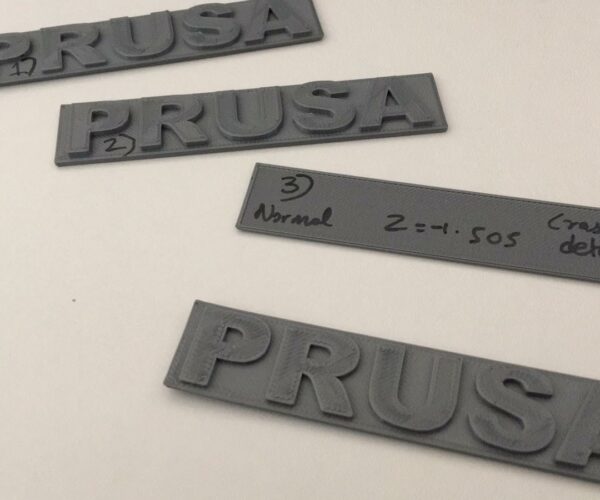

I havent had the chance to work on the system yet, but somehow its printing fine! I've been printing over 30 hours since (need to get the parts out for my work since its working!). The build quality on "Draft" setting in the PrusaSlicer software is acceptable for now, I intend to do a full service once there's some time to spare.. I am confident it will only improve the prints, which aren't too bad as they are I might add 🙂
(I printed Nefertiti at 250% speed)
