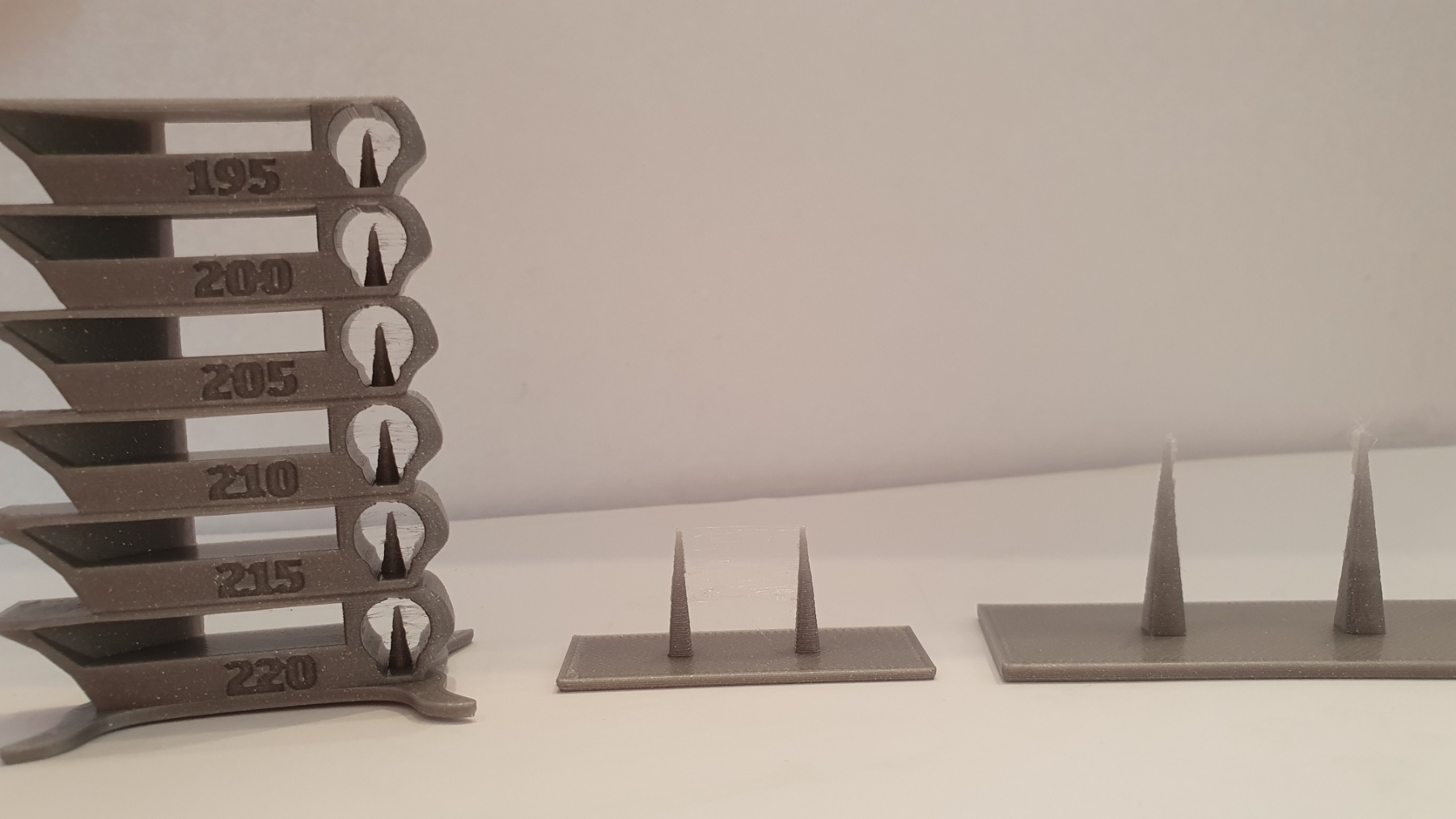

I finished the assembly of MK3S+ and I printed a temperature tower 195~250 C. Bridges and overhangs are all good in all temperatures, and stringing is almost vanished from 215 C and below between bridges. But it is present in all temperatures between the small cone and the surrounding cylinder.
I printed the typical thin pyramid test with various extraction lengths and speeds (at 205 C) but the result was the same. Strings were created in the area that pyramid side was less than 2mm. So it seems that if we do not have so thin elements, strings will be vanished at 210~205 C. Even at 215 C, benchy had very small amount.
So the print of an Eifel tower was full of strings, as most of the tower elements are less than 2mm. After some tests I found that if I reduce the "Lift Z" in the retraction, strings are vanished even from the top of the pyramids. The drawback is that blobs are created at these areas.
The small pyramids in the picture are with default Lift Z (0.4) and the big ones with zero.
