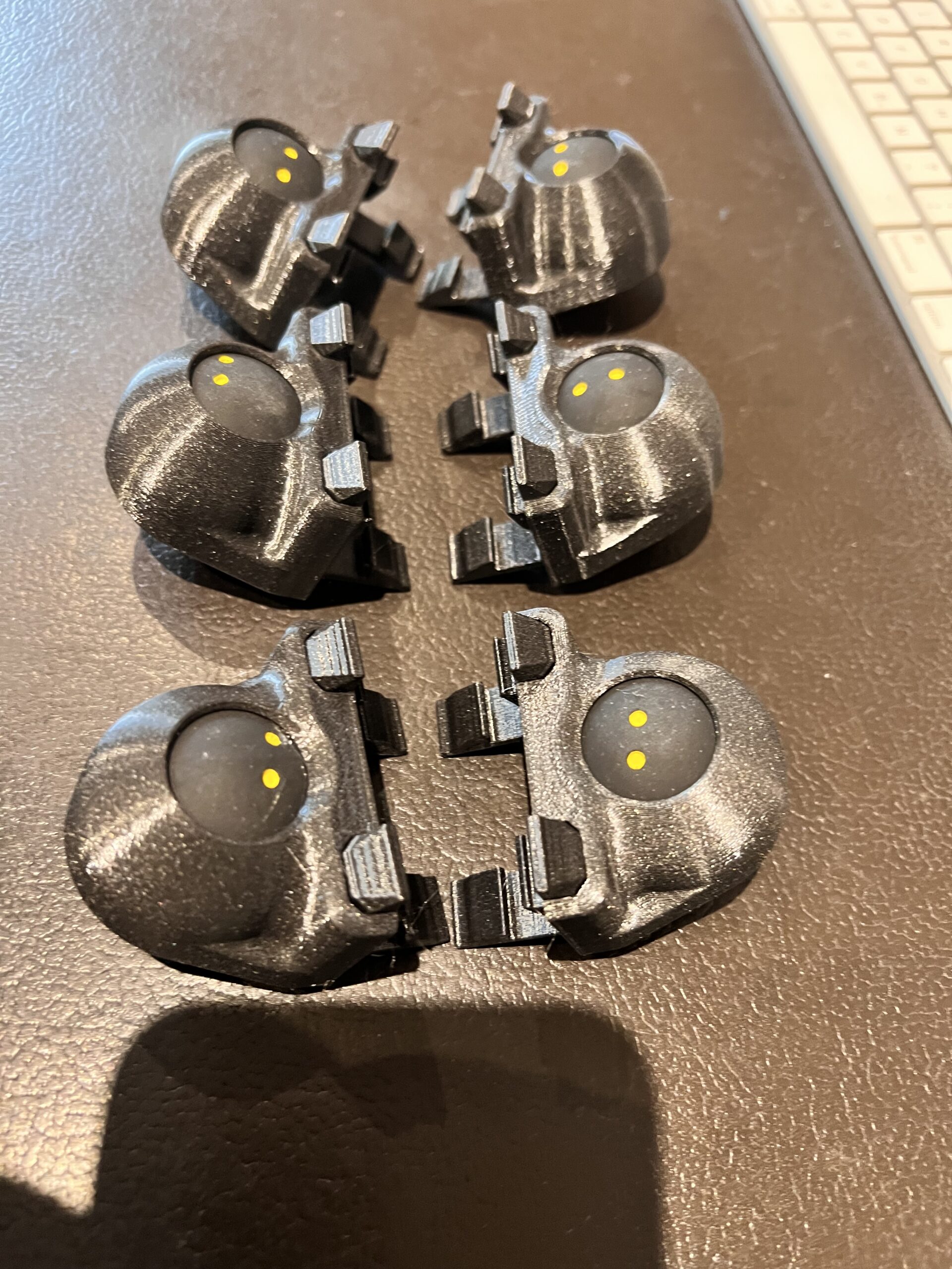

Hello everyone.
I have been wondering if someone could help me understand how to fix the high noise and vibration of the printer. It can be heard/felt in the common stairs outside the apartment...
https://storage.googleapis.com/prusa3d-content-prod-14e8-wordpress-forum-prod/2025/05/7bbd5042-vid_20250303_145008_segment_0_x264.mp4
The printer was assembled by me from a kit back in like 2020, and although it was never silent, it used to be mostly quiet. But it feels like it's getting worse with time. I recently cleaned and re-greased the bearings, rods, screws, and am using some custom larger feet I found online, as well as TPU bearing/bed holders. I also am using a custom Y-axis mount piece that keeps the motor separate from the frame to avoid further vibration (hasn't helped). As you can see in the video, both the X and Y axes are noisy.
Absolutely any help would be appreciated. It's come to a point that the noise/vibration are almost headache inducing.

Hello
I had a similar issue with my MK3S+ i got since 2/3 weeks now.
To avoid it, or rather reduce it a lot , I used this feet : Snap-on squash ball foot for Prusa I3, or rather this one slightly higher Squash ball foot brackets 5" higher
I printed 6 , but 4 are enough in fact.

Thanks for the suggestion! I'll definitely give that a try. Ordering some squash balls tonight! Did you do anything else at all?

blauzahn
(@blauzahn)
RE: Help with noise and vibration MK3S
Try to get the squash balls with two yellow dots as shown in the photo by @Lakwell. They have the highest dampening.

Lakwell
(@lakwell)
Absolutely nothing more.
It reduced the noise for sure

Hi again!
So, the balls did make a huge difference, thank you for suggesting it! It didn't become completely quite but pretty much back to an acceptable range.
However, I upgraded to the MK3.5S in the meantime, and it became even more silent, but perhaps because of the increase in speed/acceleration causing less vibration overall. The sound tone of moving axes is completely different too, now being a lot more "electronic" rather than the "mechanical" from before.
