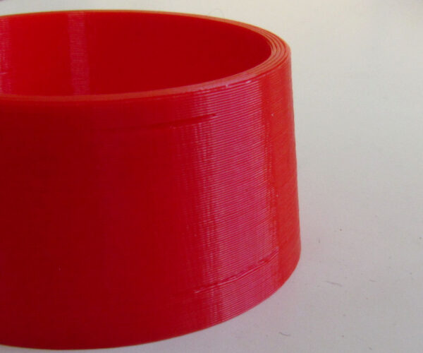

Recently my MK3S+ developed the problem of occasional extruder skips. At first I thought it was the result of me replacing some hot-end parts, or a clogged nozzle. But it turned out to be dry bearings in the extruder idler. It made squeaky sounds, but I wasn't expecting it to have the skipping effect. Lubricating the bearings fixed both the squeaking and the skipping.

These were the bearings on the extruder-idler* shaft. I didn't replace them, as lubricating (tiny bit of oil) fixed both the squeeking and the filament skips.
