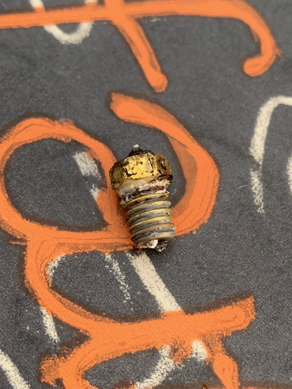

Hello guys, I’m new to 3D printing and bought an Mk3s kit a week ago and have been printing fine till yesterday when the extruded got jammed and I was near by and stoped the print and pulled the filament, today was worse because I only heard after a few minutes and I lost three hours to disassembly the extruded and get the filament out. And after that and more almost 4 hours of printing happens the same, tomorrow I’ll see what to do to get the filament out again! 😳
What’s causing this? I’m using Prusa PLA filament and Slicer PE. Hope you can help me.

@joan.t Already changed the images above.
Today morning I disassembled my extruder again to remove the filament I still tried to do a cold pull but the filament break, and after that I made a cold pull to see if there is something there but I don't think so. I was printing inside an enclosure with doors closed and the filament being loaded a bit to the right side of the printer. I'm printing now the same file but now outside of enclosure and with the original filament support.
Here are the photos of today morning and my extruder settings, I will see what will happen with this print and report here after.

This is the original Prusa filament that came with the printer, I manage to get the print done at the third try, as I told above I was printing in the ikea lack enclosure and now I printed without the enclosure and with the original filament support. I don’t know if that was the problem but I’ll keep you guys informed.

Your jam was above the cold end, this is enfdemic of PLA in an enclosure,
working with the door open may be enough to prevent this sort of Jam

The extruder motor is air cooled. If the enclosure temperature is elevated. Which is normal when the doors are closed. The motor is not cooled as well as normal.
Pla has a relatively low softening temperature.
The motor spindle conducts heat into the bondtech gears and softens the filament above the cold end ptfe liner. Causing distortion and blocking the extruder above the Cold end.
Often openning the enclosure door is enough to stop this happenning
Regards Joan

After a while when printing PET it start leaking between nozzle and heating block, now I need to know the best way to clean this, any good tips? I just don’t want to mess up, with afraid to break while mounting now I have a lot more to do. I need to buy one of those little steel brush to help me out.

Now that I disassembled a little more I can see there is some PET also in the upper side of the heat blocker. 😕

the top end of the nozzle needs to press firmly against the bottom end of the heatbreak, inside the heatblock.
this is achieved by screwing the nozzle all the way into the heater block, then unscrewing it 1/2 turn, then the heatbreak is screwed in until it firmly presses against the nozzle when the heat block is hot
I use a socket spanner like this
I usually use Coppaslip on the heatblock threads, and CPU thermal paste on the heatsink threads
I prepare the cold end PTFE like this
(shorter for the mk3s extruder)
with the heatsink unscrewed about 1/2 turn, I press the PTFE Into place, firmly and while keeping pressure on the PTFE i pull the black plastic ring away from the heatsink, then I screw the heatsink into place, slightly compressing the PTFE tube... in this condition, the 'C' clip is not really needed beneath the black ring, however, if you have a clip, there is no harm installing it now...
re assemble the extruder housing, and wiring etc. catch the initial extrusion in a tissue, to prevent surplus grease contaminating the heatbed.
re run live Z adjustment, and once complete, try printing a known model
Reards Joan
