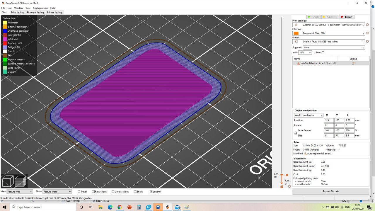

Hi guys,
As I have said, I'm new to this world of 3d printing and trying to understand why Slic3r is slicing the way that it does.
The simple design is basically a credit card sized pattern with a depth of 1.5mm.
https://postimg.cc/HVmJ4qTz
https://postimg.cc/vxF4KjfQ
When I slice it, the bottom layer is absolutely fine but the second layer is not printing very well. This layer is longer and wider than the first and the portion that 'overhangs' the first layer is filled by bridging infil. The thing is, the perimeter of the second layer doesn't adhere very well and I'm not surprised as the extruder has moved vertically.
Here are the layers:
https://postimg.cc/0KYz1f07
https://postimg.cc/vDfgnYwD
I don't really understand why all the layers of this pattern aren't the same size with a common perimeter rather than this overhang and bridging business. Also is there a ways I can alter the settings in order for the CAD to be sliced in this more logical way?

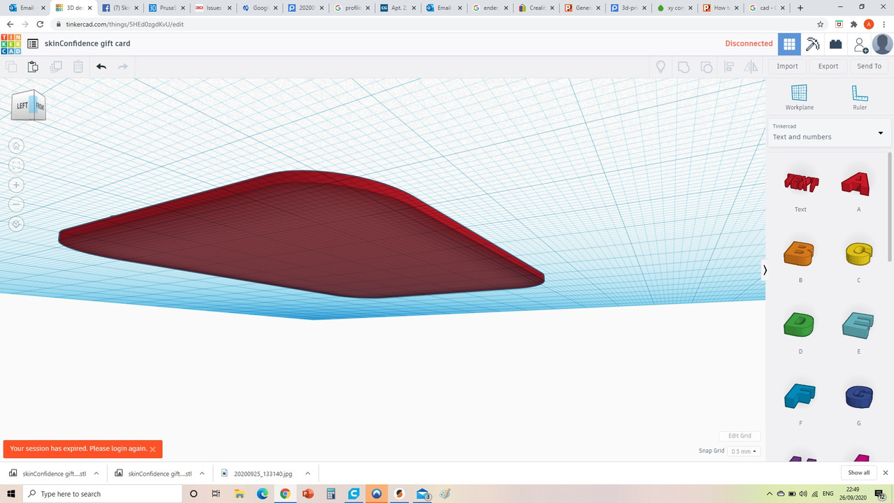

As I thought.  Your baseplate that you have the letters on isnt flat.  It curves slightly on both the bottom and the top.  That is why the outer edge is printed as bridging, because the design dictates that.  Its also apparent on the top, as the S and E (outside letters) dont actually connect to the surface below them, except in the middle where the base is an extra layer thick, they are printed mid air too on the end ones.  Look at layer 11 on the preview.

I think when you added a bevel to the thin rectangle it applied it equally proportionally to all the edges.  Which gives you this - this is the bottom of your card.  Its the same on the top except with all the letters.  That is what the triangles of the stl are made up of.

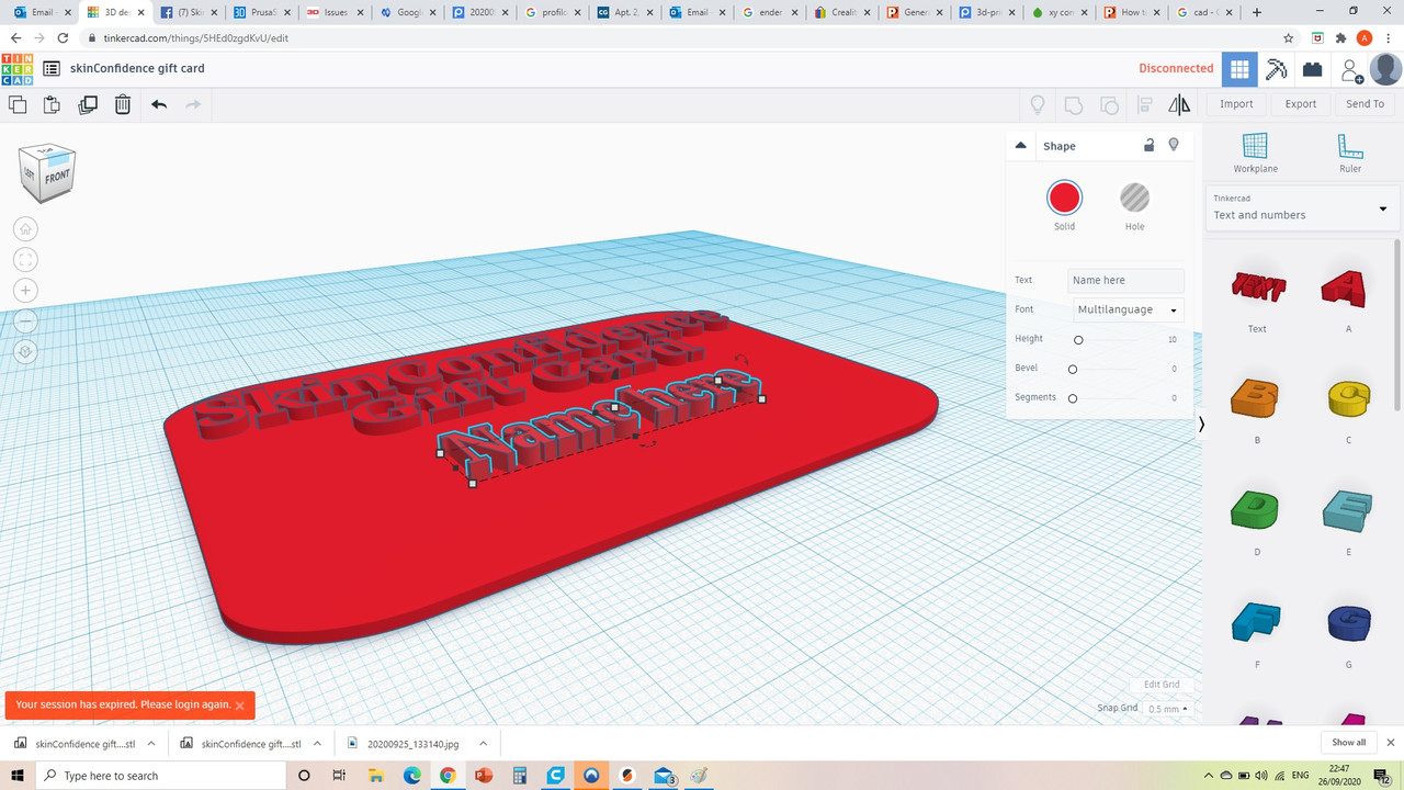

When I saw you were using TinkerCAD, my first thought was that filleting/beveling might have caused your problem. I mostly use Fusion 360 these days but I go to TinkerCAD quite frequently.  It's so easy to use and it's straightforward to create simple models or to make modifications to existing STLs, compared to other tools such as Meshmixer.
A few thoughts on TinkerCAD that may be related to this topic:
  • While TinkerCAD is actually surprisingly powerful once you discovered some of its more obscure features, it doesn't have great ways to apply fillets. I assume you used a box shape and then the radius option. Unfortunately, it applies the radius to all edges equally, so you will end up with rounded edges at the bottom as well -- this is what you saw in your design. The only way you can apply fillets to selected edges only (such as the vertical ones) is to use the MetaFillet shape generator, which you can find in the right-hand pane under Shape Generators/All. Alas, the shape generators are displayed in what appears to be random order, so you may have to browse through a dozen pages until you finally find it (but you can then add it to your Favorite shapes). MetaFillet works great but it's a royal pain to size it and align it properly with the edges you like to fillet.
  • When you add any object including lettering to a flat surface, make sure you use the D tool to properly drop it onto that surface. To this end, create a temporary workplane using the Workplane button or W on the surface you want to put the lettering on, then select the letters and use D to drop them onto the workspace.
  • Make sure you select all elements and group them before exporting as STL.
  • In my experience, TinkerCAD generates STLs with issues quite frequently (as you can see from the warning PrusaSlicer showed you in the screenshot you shared). So whenever I import a model from TinkerCAD and see an error message I run it through netfabb (right-click on the model to get to that option) and then Export to STL (also right-click on model) to generate a "fixed" version.
TinkerCAD is a great tool but not without its issues.

It's one of the "hidden" tools in TinkerCAD. There's no menu option for it, you just select a shape, then press the D key on your keyboard, and voila it'll drop down to your current workplane.
Bonus tip:
Check out https://blog.tinkercad.com/keyboard-shortcuts-for-the-3d-editor. It's a convenient crib sheet of keyboard shortcuts.
Extra bonus tip:
Another hidden but handy feature is that you can double-click on a group to quickly edit a component of the group without having to go through Ungroup and Group again.
