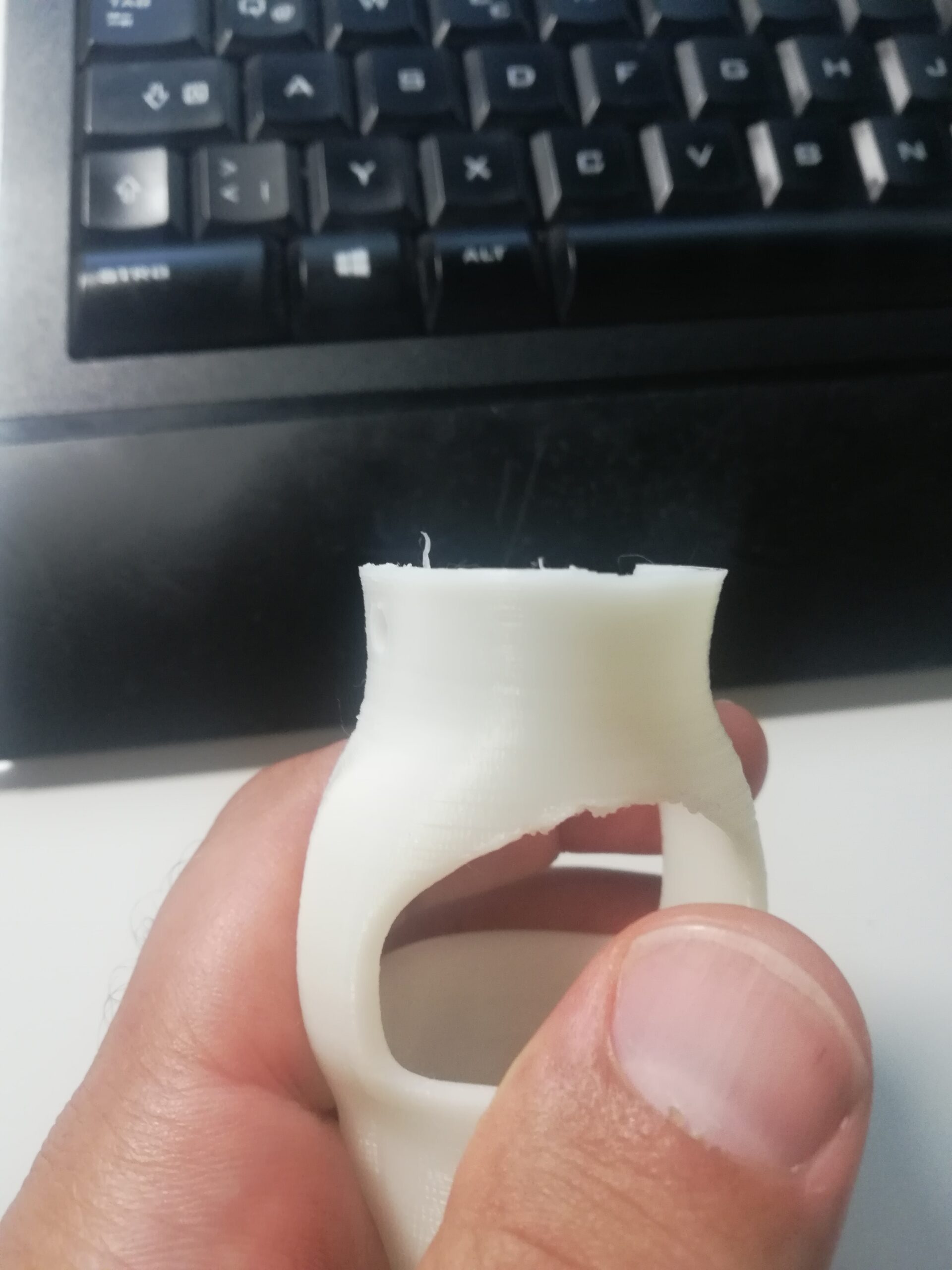

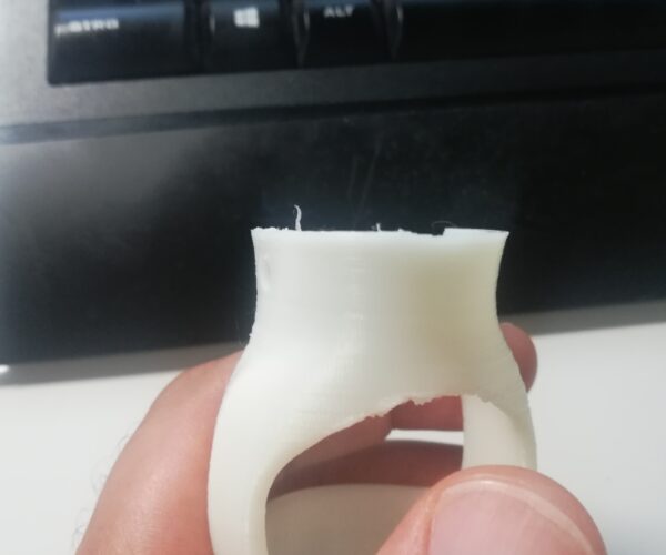

Hello,
 This is my first post here and I am very happy to be a  member of this forum.
I have just bought my first Prusa  i3MK3 and i am very happy to be able to print my designs. I want to print a model that looks like a cylinder with Prusament PC Blend  and because I am new to Prusa I let the settings default for this filament. Everything looks fine at the beginning but after a while has crash detection and tries to recover printing. This isn't happening to a spesific layer so I can not tell if the problem is my design. When the error is coming I see a small piece of filament stuck on the last layer and because of this has a crash detection. Unfortunatelly I do not have experiense to fix it. I have already print it 4 times by changing some settings but always the error is coming in different layers. The model is good stuck on the bed and I am not seeing any kind of lifting.
Does someone knows what the problem could be and how can I fix it?
Thanks a lot
Kyriakos

Hi.
It would be a great help if you can post a picture of the failed print while it is still on the bed to see what that tells us.
Based on the information provided, it sounds as if your print is warping on the bed which leads to a 'crash' when the nozzle hits the warped print.
PC Blend is tricky to print and a printer enclosure is generally recommended to keep the air temperature around the print high so that warping during printing is minimised. That said, for smaller prints you may be able to get away with printing a skirt and generally minimising air movement around the printer.
Hope that helps.
Cheers,
Tim

Kyriakos
(@kyriakos)
RE: Crash Detection with Prusament PC Blend
Hi Tim,
Thanks for your answer. Unfortunately I do not have a photo during the print with crash but I have one with this small piece of filament on the top that causing the crash.
Tomorrow I will print it again and I will try to make a photo. But I do not see any wraping on the bed. The model is good stacked on it.
Cheers
Kyriakos
