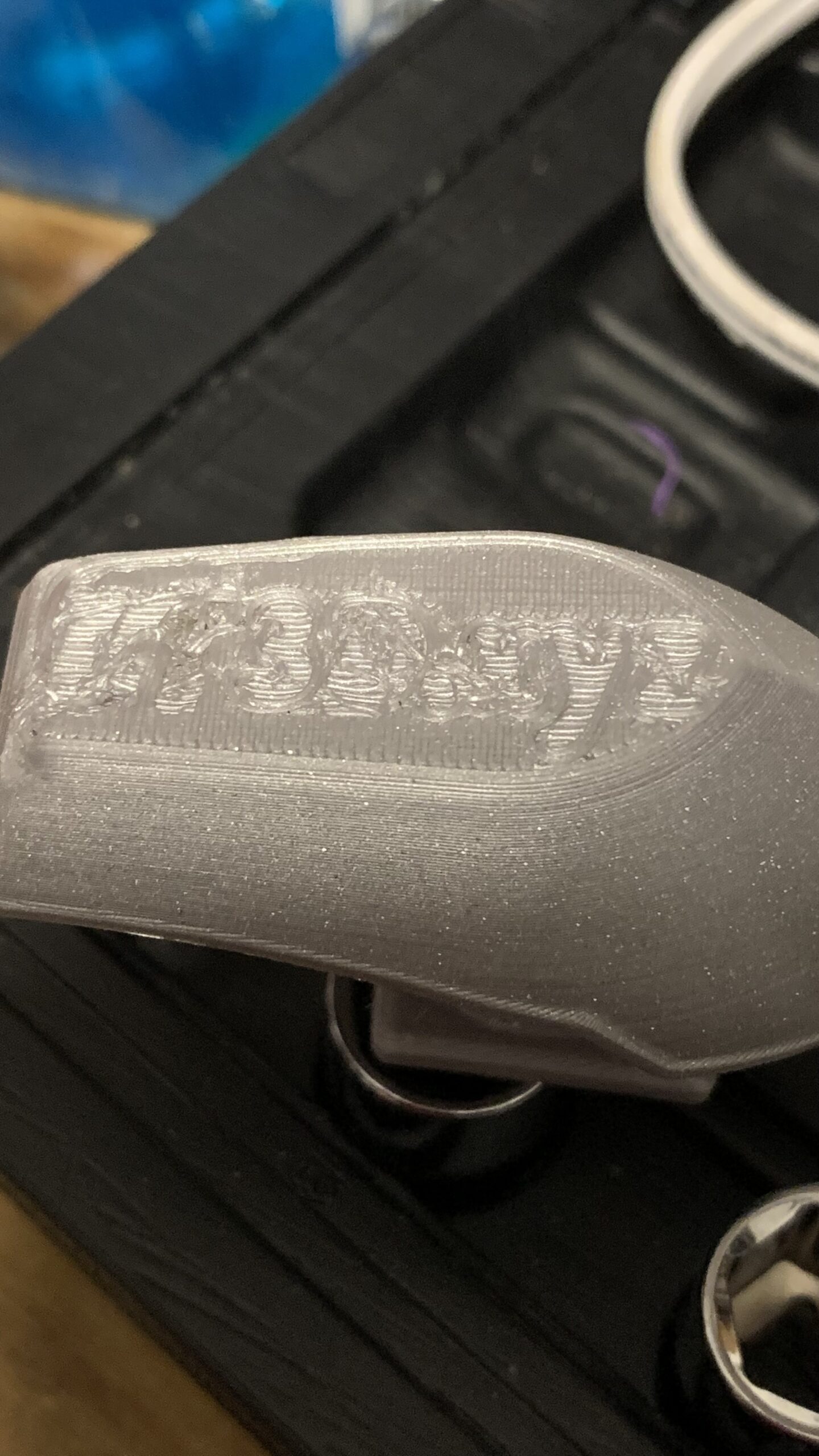

gamefe
(@gamefe)
The first print that popped off
First the print that popped off at roof
then print that held. Looking at it the second looks worse.
Mimi printing the test print now. The successful print bottom The print that popped off bottom The print that popped off at roof

Bottom of print Aide Close of front left Full printWashed surface with windex. Then with isopropyl alcohol, then added glue stick. Then isopropyl to slightly dissolve it and spread a thin layer

Benchy reload
Bottom of success printFailed printBottom of failed print
Posted : 08/10/2021 2:50 am
gamefe
(@gamefe)
Not correct.
Now it’s aweful. Idk why it changed after the benchy.
Posted : 08/10/2021 2:54 am

towlerg
(@towlerg)
Beef up first layer of support.
Obiously one of the support towers has detached. Given how little material you have between it and the bed it's probably no surprise.
Did a nozzle strike cause the divits out of the top of the hat? Doesnt seem likely.
Posted : 10/10/2021 11:54 am
gamefe
(@gamefe)
Big base prints seem to be good
This is the print on the as card from factory. I didn’t design the supports. I’m hoping it is just a bad slice. It also could be that I had it at 70% speed and that is what messed it up.
im printing the castle print as supplied on as card. Huge base of contact. Looks near perfect. So it seems the problem was 2 things, bad nozzle/hot bar tube tightness that was leaking filament causing issues and the PEI sheet need replacing.
Im going to order a new steel sheet and replacement pei sheet. I’ll try replacing my current sheet and if it goes wrong I’ll have a new sheet ready to go. Castle currently on print
Posted : 10/10/2021 2:14 pm
