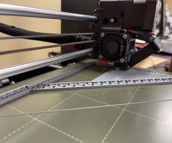

As per title, I made a 3d bracket (first one printed without issues), made some modifications and printed a second one. Model and slicer both do NOT have a phantom floor.
Pic of the model in slicer to show what was exported to SD card as a g-code file.

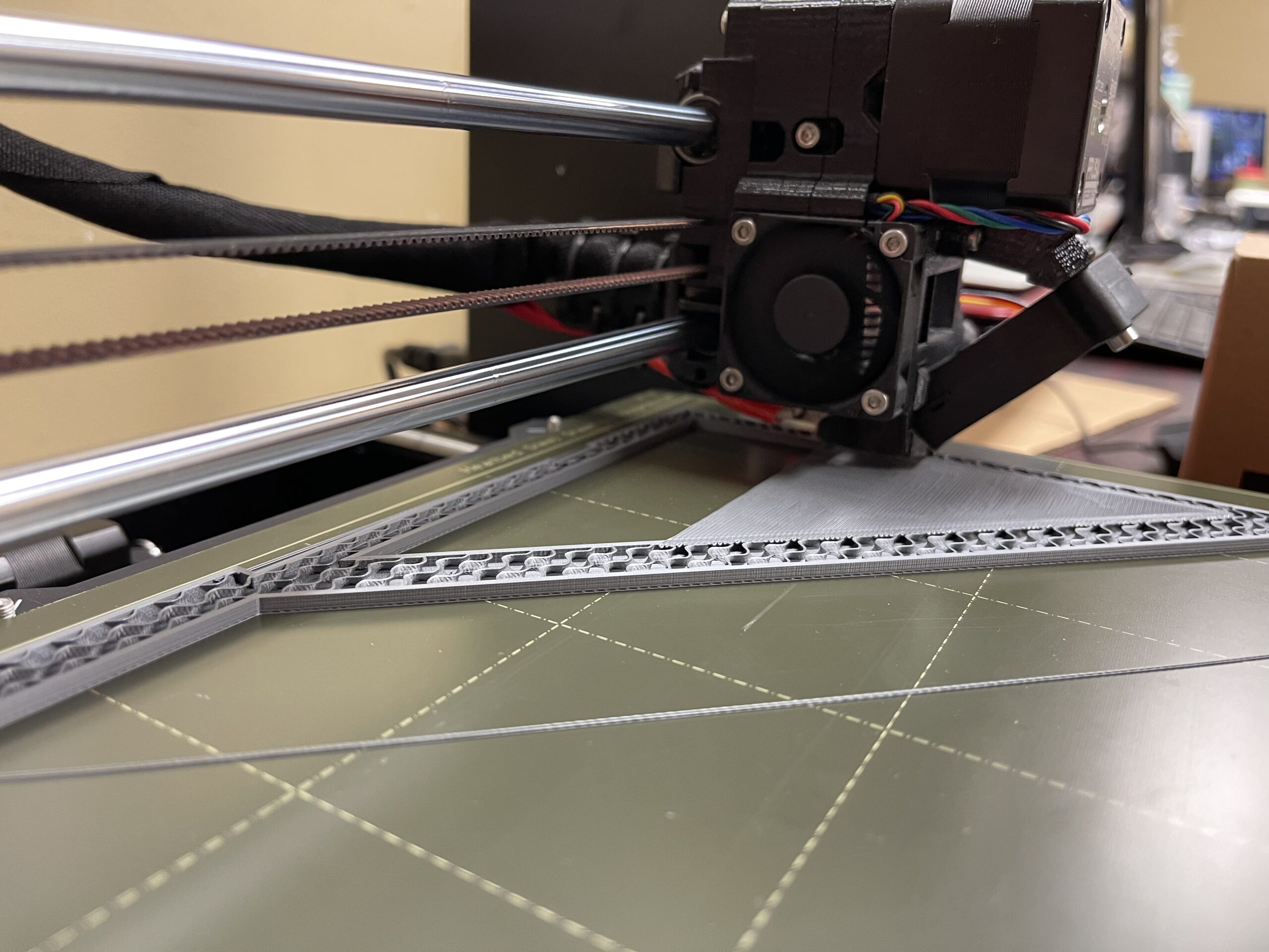

pic of the print showing the printer deciding to randomly print a floor in the open space of the bracket.
Any idea to find out what caused this? This print takes about 17 hours, but redesigning it changed it to 24 hours (which I didn’t understand why), and now that this phantom floor appeared, I can see how an additional 5 hours was added if it’s going to fill in this empty space (I designed and positioned the part to not need any supports)

You can see the 3d model in slicer software; this is exactly as it was exported to G-code on SD card

It won’t display both pictures in the post…. Attaching them here

Hey Joan, really appreciate the feedback! Could you specify what error? I drew it in Google Sketchup, and I know it's not the best for 3d printing.... will need to learn other modeling software soon. Sketchup did not identify any wall in the triangle space.
I just found out not too long after posting - when I looked at the slice settings in PrusaSlicer, I noticed that changing it from ".05 ultra detail" to another setting ended up removing that phantom floor. Is there something that would cause the slicer to create a floor in a detailed-oriented setting versus a draft setting?
Thanks again!
Posted : 20/08/2021 3:45 pm
Thanks Daniel,
I didn't look to see what the error was, I simply passed the file to Netfabb to be fixed, and it came back fixed,
sometimes the STL generator drops in a small error to keep us on our toes...  🙂
