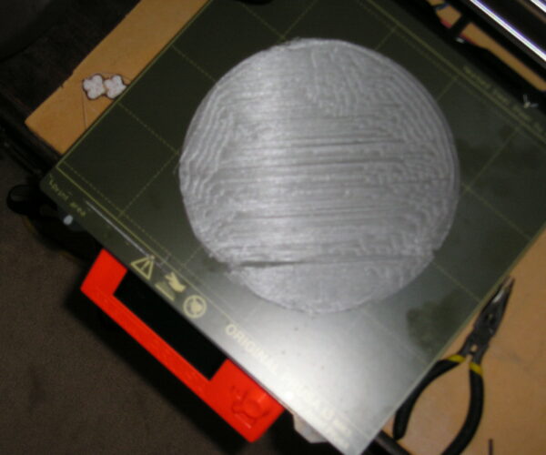

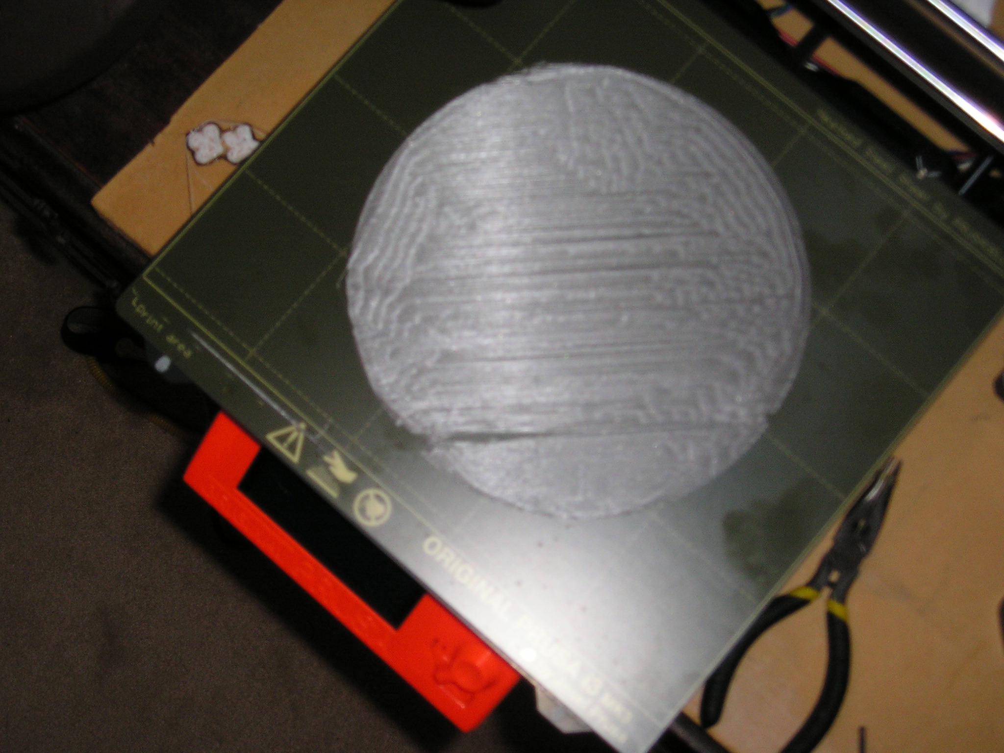

here is a pic of the calibration and the test print from the sd card, these were done at 80 speed, 70 bed temp and 115 nozzle temp, z adjust is now -1800

First blue bed I've seen on a Prusa MK3 ... and Live-Z looks pretty far off from ideal.

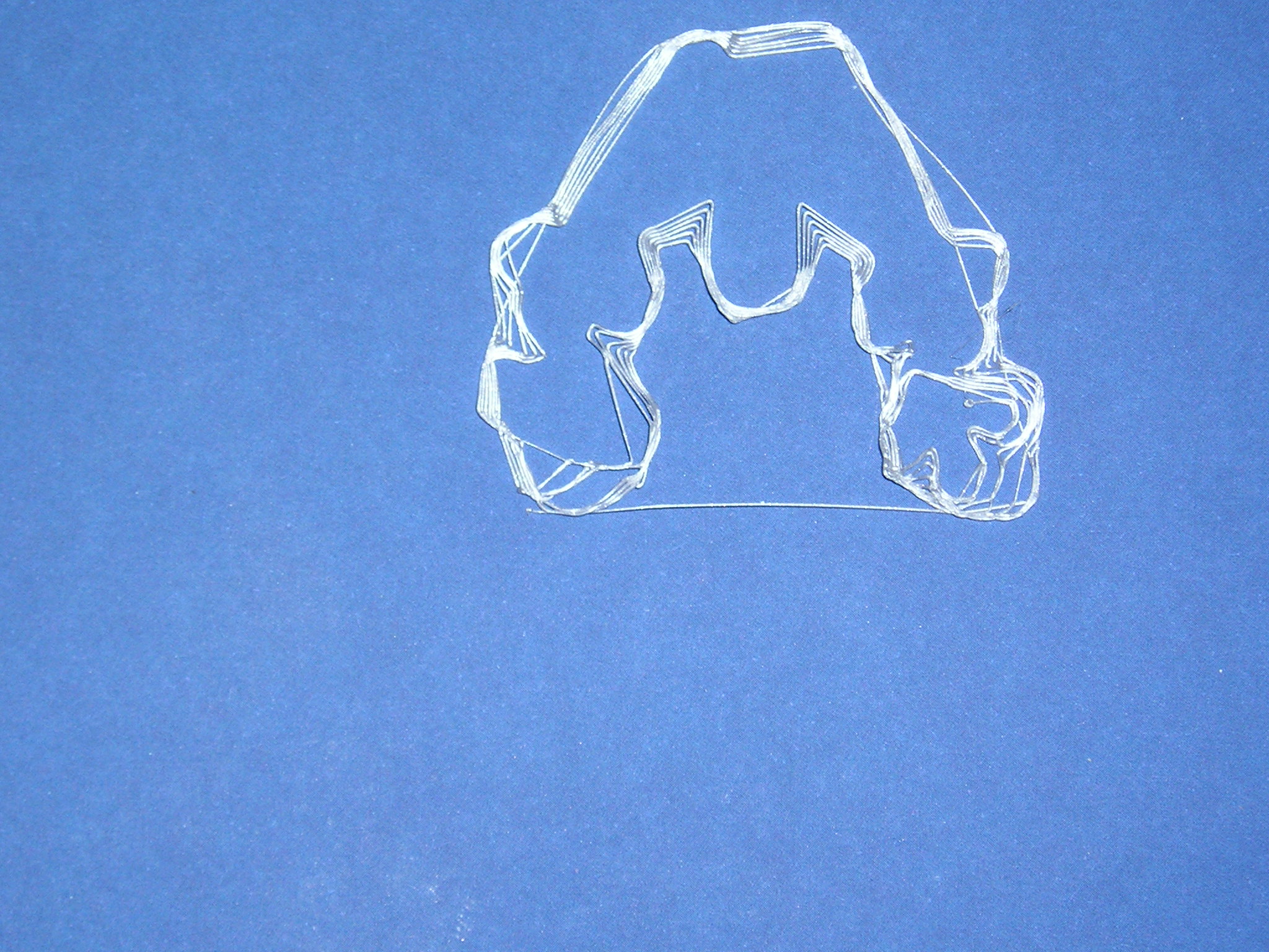

As I said, the print came loose from the bed whilst I was checking for adhesion, so I used something that would give a good contrast.
I've just had another go. This time, I came up with my own print. A circle of one layer only.
The outside edge (three circles) barely adhered at all, and bore scant resemblance to a circle (think how good a hand drawn one would be). It isn't that obvious in the picture, but on the real thing you can see it. Looking at the picture, at 2 o'clock and 10 o'clock, you can see a grainy sort of effect. Here the filament has stuck to the bed, and to adjacent bits of filament. Across the middle the filament hasn't adhered to either the bed or adjacent threads (particularly noticeable at around 7 o'clock). There are a couple of points on the circumference where the print failed to adhere so badly that the filament got carried back into the print.
Adrian

+1, that z looks way too high.
